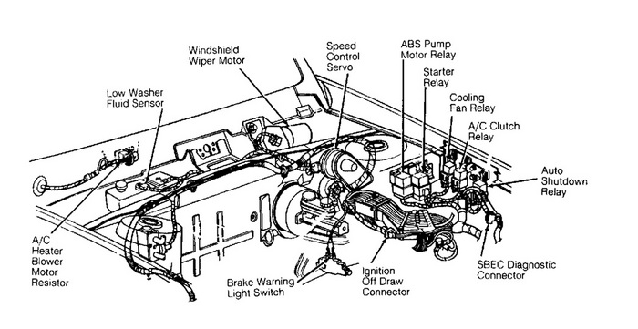

Most batteries have a reserve in minutes. If the reserve is 60 minutes, the vehicle should start and run for about an hour even with faulty charging system. How long it will run depends on the discharge rate. Sounds to me like a faulty battery. Some of the national brand autostores will check the battery for you. I've driven vehicles where I knew the charging system wasn't working, after I got it started, I drove it for several minutes on the battery reserve power.
Yes, driver side wheel-well, black, maybe 1&1/4 x 1inch. Wiring color at the connector, red with white stripe--dark blue--dark green with black stripe--dark blue with yellow stripe.

If the battery checks out and the vehicle cranks good, but won't start, I suspect the hall switch in the distributor.

After removing the wiring connector what should I read on each terminal?

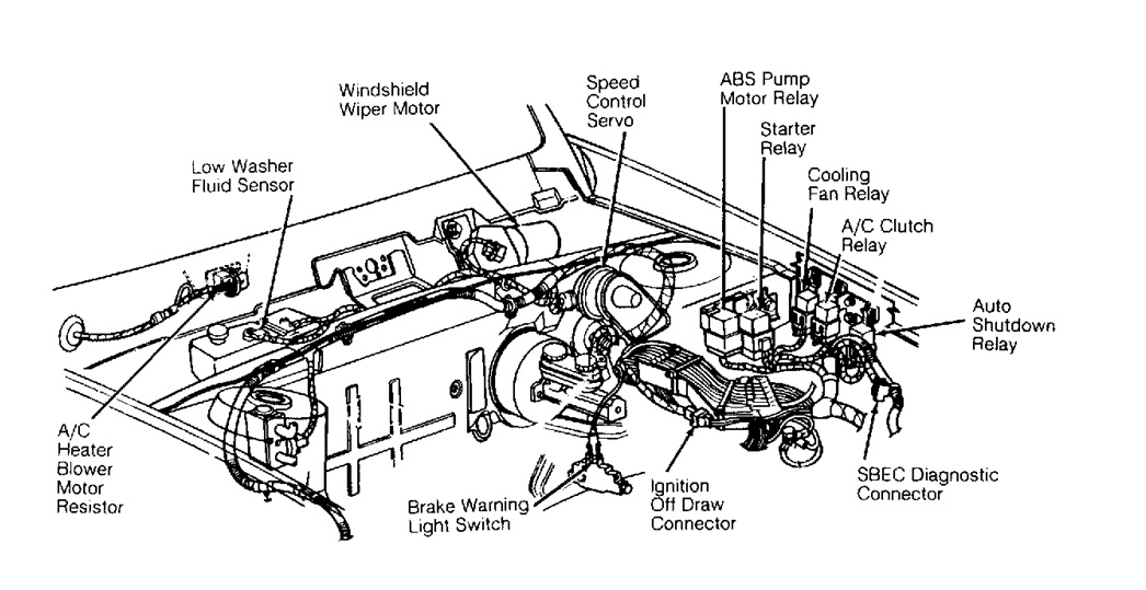

With the relay unplugged, only the dark blue and red wire would have voltage, check with the key in the crank position.

Thanks !!!! The readings I get are:
with the ignition off I get 12.5v across battery and at the red and blue on the asd. with ignition on I get 0v at red and blue 12v across battery. with ignition off I get
0v between green term and black term. with ignition on I get 12.5v across the green and black. Does this help?

When you say key on are saying on or cranking? These are two different key positions. The red wire with white tracer should be hot all the time, key on--off--engine cranking, whatever. The solid dark blue wire may go hot with the engine cranking, you can test key on and cranking on that wire.

On the red I get 0v with ignition on or when cranking. Thanks

You need to be sure the battery has a full charge, the cables/wires are all clean and tight on both ends.
Backtrack the red wire, my info shows a fusible link. Check for voltage on both sides of the fusible link. If you have voltage on one side and not the other, the link is faulty. You could use a jumper just for testing, by pass the link.

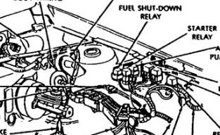

Sorry, meant the post about the Fuel Pump Relay and checking the #30 post for voltage and then putting a jumper on it. I just was going to do this, except the fuel pump is turning on every time I try it today. I even tried it a bunch of times in a row, but it is working today! Damn Gremlins!

Unlike GM pumps that often fail while driving, Chrysler pumps almost always keep going once they've started up. When they fail they do not start up. If you hear it run for that first two seconds, the engine should start and run. I suspect when it isn't starting up on its own, it does start from the engine vibration when you squirt gas in. An intermittently non-starting pump would be much more common than a lack of a priming pulse from the injector due to a false reading from a temperature sensor.
When you do catch it not starting and you want to jump the fuel pump relay, use the diagram below and jump terminals 30 and 87. If you see a small spark when you make the connection you'll know the wiring is intact. If there is no spark, suspect worn brushes in the pump motor.

Thank you so much for your help. The Acclaim finally started acting up again and wouldn't start. I got out my trusty hammer and gave the gas tank a couple taps. Low and behold, it started, so I guess it was getting ready to fail. I just got it back from the shop, had a new fuel pump installed. So far so good. Thanks again!
