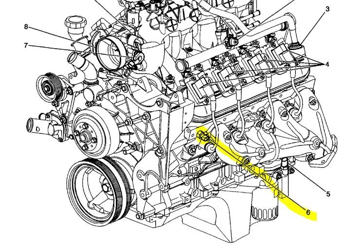

My truck seems to run terrible but runs better when it's cold. Acts like it's not getting gas. Had the fuel line pressure they told me it was good. Changed fuel filter and spark plugs. 2 o2 sensors and Mass air flow sensor and EGR valve.

Hi:
Has anyone checked the engine coolant temperature sensor (ECT)? This sensor tells the computer how rich or lean to make the fuel mixture based on temperature.
Using a live data scanner, see what the ECT indicates and if it seem correct.
I attached a picture of sensor location. Check to make sure there are no issues with the connector or wiring.
Let me know what you find.

Yes, I told that it was bad and they also said that it would not cause my problem.
Tuesday, November 5th, 2019 AT 7:23 PM
  • 110,194 POSTS
Hi:
You didn't mention the ECT. I rechecked. And, yes it can cause this problem. Reconfirm that it was replaced.
Tuesday, November 5th, 2019 AT 8:57 PM
LEONARD AKERMAN
  • 10 POSTS
No, I have not replaced it yet. Probably try it tomorrow.

I would recommend using a live data scanner to determine if the ECT is sending the information correctly. I don't want you to purchase a part for no reason.
Let me know if it helps with the driveability issues.
Wednesday, November 6th, 2019 AT 6:56 PM
LEONARD AKERMAN
  • 10 POSTS
I want to thank you all for your help. Just put engine coolant temperature sensor on my truck and it's a lot better.
