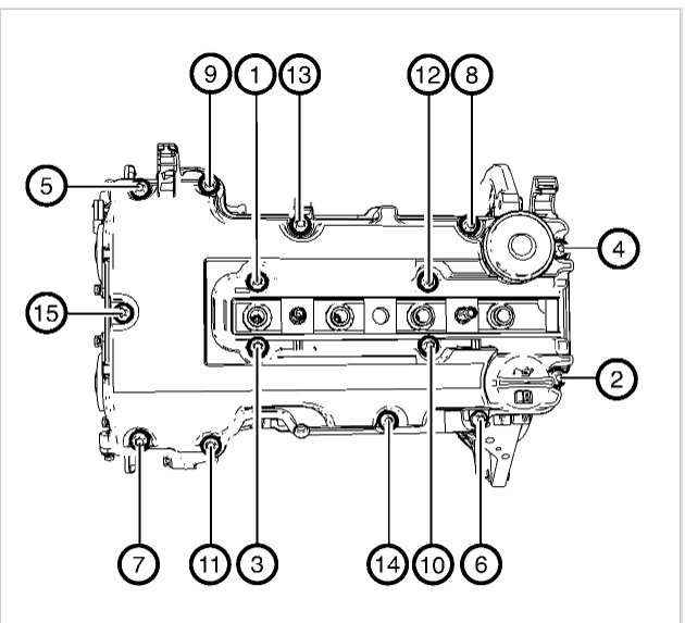

I need a print out or picture of the engine valve cover tightening and torque sequence. Your help is very much appreciated. Thanks and have a great day.

Here is a tutorial showing what is involved:
https://www.2carpros.com/articles/replace-valve-cover-gasket
I've attached two pictures below with the specifications you asked for.Hope this helps and thanks for using 2CarPros.

Hey Danny I need tork spec !
Jan 15, 2025 at 3:54 AM
  • 54,961 POSTS
The torque spec is 71 inch pounds. Let us know if you need anything else.
