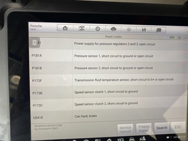

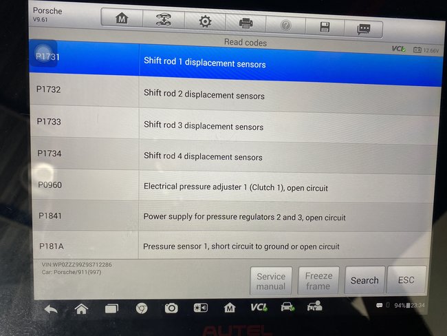

Hi Ken, actually I made the can test while right now nothing useful because I removed the transmission plug from down took it inside the car to test the voltage. So you will find a lot of faults which mean if I fix the plug back the only shift rods faults will stay.
Anyway I uploaded the pictures.

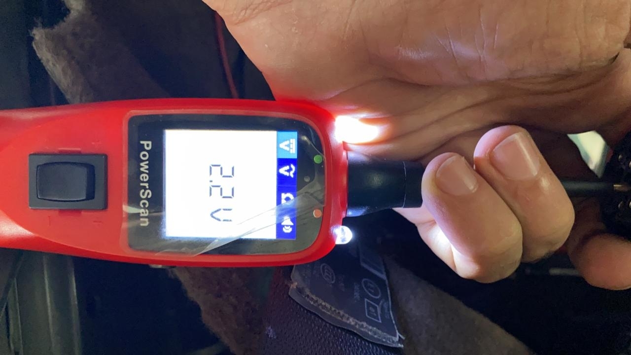

Last thing which I noticed that each shift rods should be 5v but here only 2.2v from the control unit.
I don’t know.

The voltage issue would cause it. Check the powers and grounds for the module. It sounds like there is a bad connection with high resistance.

Here’s the can scan.
But you will find some errors it must not be only because I removed some wires from inside.

It’s giving the same voltage!

Okay, if both new and old modules give the same voltage when connected trace the power feeds to the module and use a heavier load like a carbon pile tester or even a bigger test light to see if the voltage drops with a load applied. Internal wire damage could show the correct voltage if on'y one strand of wire was good, but it wouldn't carry a load without dropping voltage. Bad connection could do the same.
