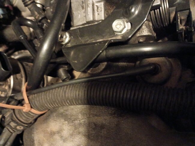

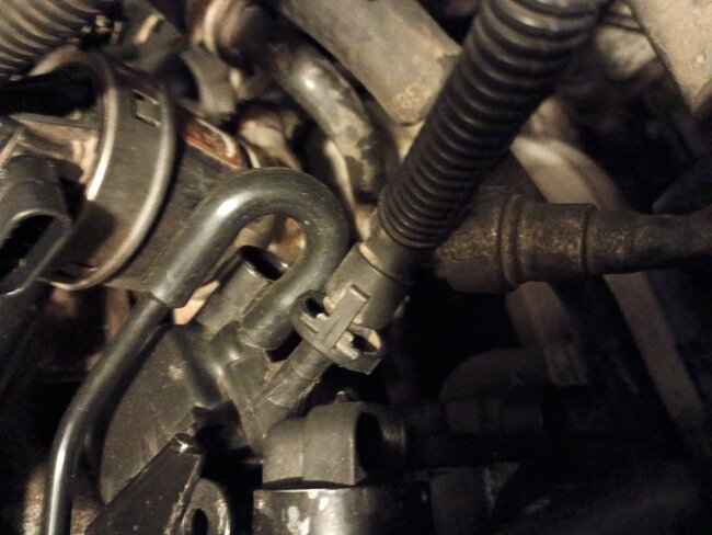

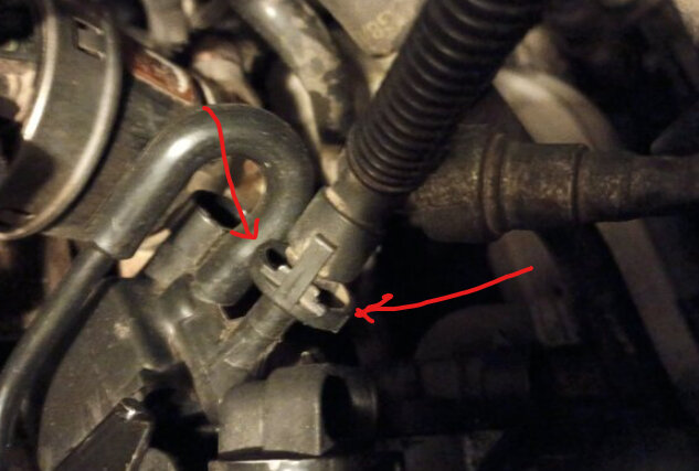

See this roundish plastic connector in pic #1 that connects to the pic #2 which is the part you said is likely the cause for code p0446 and then to pic #3with the green cap that has a black tag saying evap service port well Idk how to get this connector off and there's a open ended hole on the other end pic #4 is anything supposed to be there

Yep, the lines look better. So the EVAP system needs to be 100 sealed, it cant have any leaks so please keep that in mind. Also, looks at the O ring seals inside the corrugated line on the solenoid. This video can show you how to check for leaks on the system.

How do disconnect the hard plastic connector to it tho
Monday, February 2nd, 2026 AT 12:11 PM
WIMMS77
  • 75 POSTS
I don't need to track down a leak I need to change this part and can't figure out how to. Get the evap connector off of it to do so
Monday, February 2nd, 2026 AT 12:12 PM
KEN L
  • MASTER CERTIFIED MECHANIC
  • 55,481 POSTS

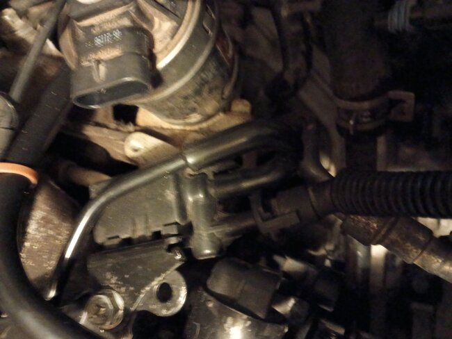

O sorry, yes you squeeze the connector at the "loop" part this will release the connector without breaking it. Check out the images (below). Please let us know what happens.
Tuesday, February 3rd, 2026 AT 3:42 PM
WIMMS77
  • 75 POSTS
I got t off. Got the new on drove it got a check light again I'm going to run the scanner n see why n lyk

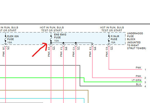

So you still have this code?
Code: P0446 - EVAP Vent System Performance / Vent Control Fault
Lets check the ENG EMIS fuse in the fuse panel under the hood. This guide can help
Thursday, February 5th, 2026 AT 9:35 AM
WIMMS77
  • 75 POSTS
Yes code came back after resetting it and driving it a lil bit but can a fuse go bad or fail and be bad even if it's not burnt inside

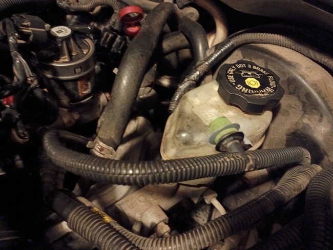

Not really if the fuse is not burnt it is good. Can you check the gas cap seal, this is another point of failure for the sealed system. Keep in mind any leak in the gas EVAP system will cause this code as well.
Friday, February 6th, 2026 AT 7:47 AM
WIMMS77
  • 75 POSTS
I did and im not sure if it's missing or not il take a pic and send it in a min and let you tell me what you think could the cable from the gas pedal to the throttle body have anything to do with it
