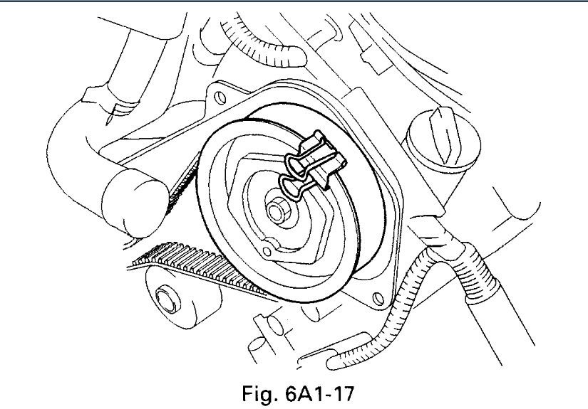

Where is the tensioner and where are all the bolts for the lower cover for the serpentine belt? will the crank pulley have to come off? I am a boat or marine mechanic.
May 6, 2020 at 1:35 AM
  • CAR REPAIR CONTRIBUTOR
Good morning,

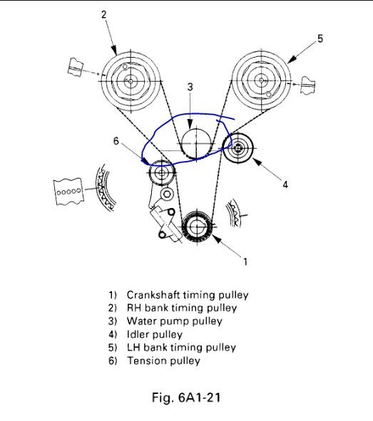

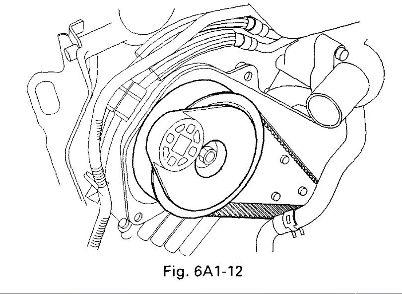

The water pump is driven by the timing belt. The location is under the front cover of the engine . Once you get to the timing belt, you can just unbolt the water pump.
https://www.2carpros.com/articles/coolant-flush-and-refill-all-cars
https://www.2carpros.com/articles/water-pump-replacement
It is always recommended to replace the timing belt at this time since you have to remove it to replace the pump.
https://www.2carpros.com/articles/how-a-timing-belt-works

10. Remove timing belt cover.
11. Remove timing belt pusher.
CAUTION: The pusher prevents air from entering the oil chamber. Its rod must always be facing upward.
12. Remove timing belt.

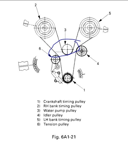

2. Install timing belt.

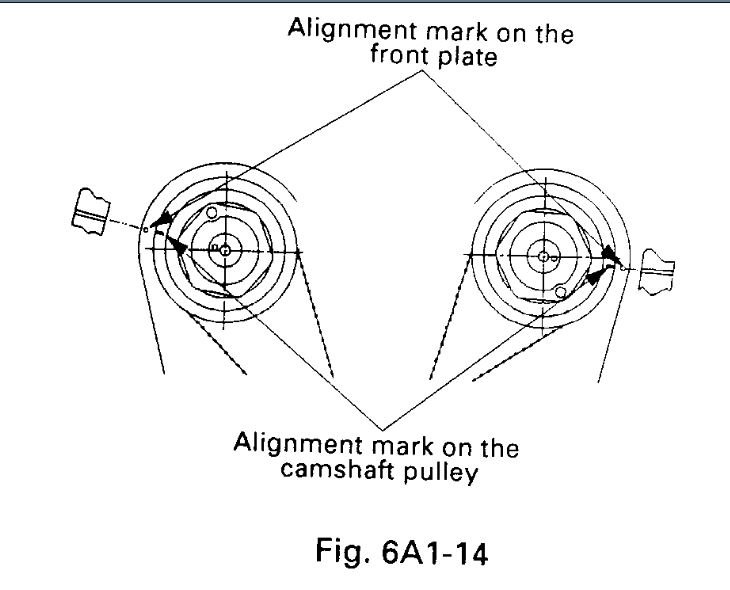

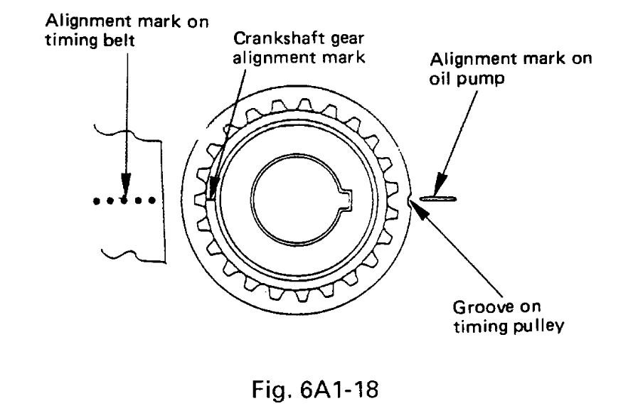

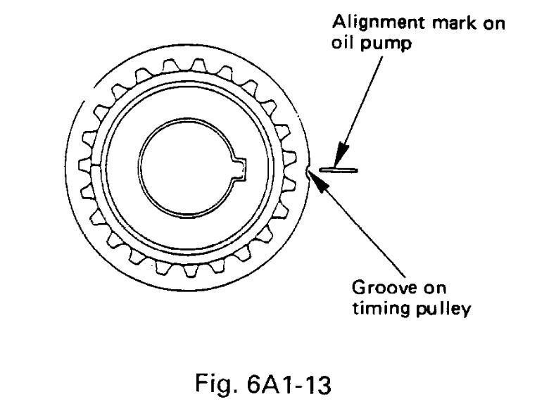

1. Align groove of crankshaft timing pulley with mark on oil pump.
2. Align the marks on the camshaft timing pulleys with the corresponding dots on the front plate.
NOTE: When timing marks are aligned, No.2 piston will be on T.D.C.

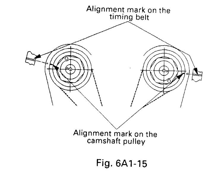

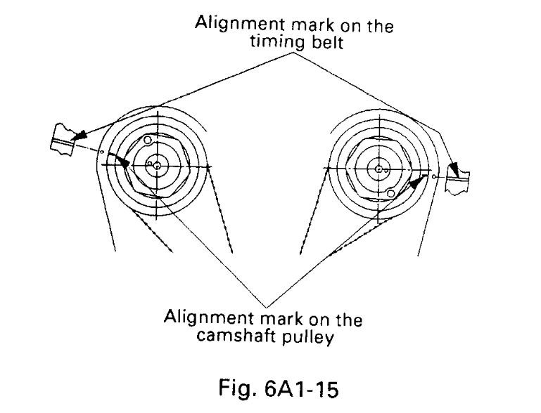

3. Align the alignment mark (white line) on the timing belt with the alignment mark on the RH bank camshaft timing pulley (on the left side as viewed from the front of the vehicle).

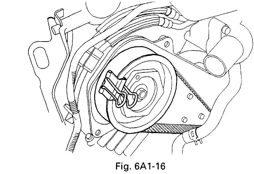

Secure the belt with a double clip.
4. Align the alignment mark (white line) on the timing belt with the alignment mark on the LH bank camshaft timing pulley.
5. Install timing belt. Align the dotted alignment mark on the timing belt with the mark on the crankshaft gear.
NOTE: For correct belt installation, the letters the belt must be able to be read as viewed from the front of the vehicle.
It is recommended for easy installation that the belt be secured with double clips after it is installed to each pulley.
6. Turn the crankshaft counterclockwise to remove the belt slack between the crankshaft timing pulley and the RH bank camshaft timing pulley.
7. Install the belt on the water pump pulley.
8. Install the belt on the idler pulley.
9. Install crankshaft pulley temporarily and tighten center bolt by hand (do not use a wrench). Turn the crankshaft pulley clockwise to give some belt slack between the crankshaft timing pulley and the RH bank camshaft timing pulley.
10. Install the pusher while pushing the tension pulley to the belt.
