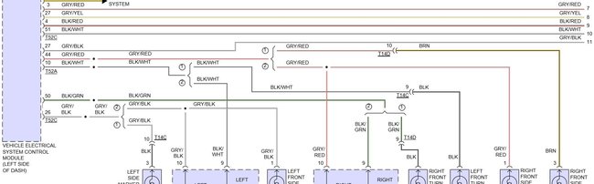

Check the other end of that gray/red wire at pin 3 connector T52C of the "vehicle electronic system control module" located left side of dash for voltage.

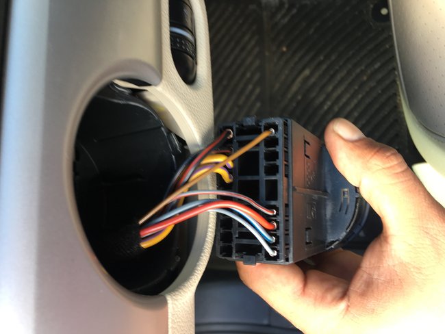

Thank you for the reply. I am having a little trouble getting to the vehicle electronic control module it is such a tight spot with a lot of wires. Also to note; I noticed today no parking lights work on entire right side of the vehicle. The tail lights and the two bulbs inside the headlight on the passenger side also do not turn on when I turn on my parking light. I took the connector off the head light it self. Using my meter I measured between the grey/red pin and ground and did not get 12VDC.
I took the actual headlight switch inside the dash apart. I measured between gray/red and ground wire with switch on and got 12VDC. So I am getting the correct voltage at the headlight switch in the vehicle but no voltage at gray/red wire at neither the headlight or taillight passenger side of vehicle.

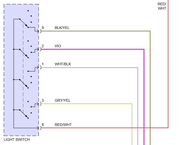

Are you sure the wire was gray/red at the light switch? Because I do not see one.

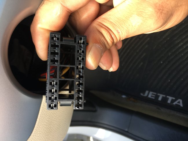

Yeah, I am positive it was gray/red. There is more wires on the connector for the light switch on the dash then the schematic you just posted. Also, this vehicle does not have fog lights and the light switch is only on or off. I will post a picture of the back end of the connector for the light switch shorty.

Here is a photo of the light switch:
Saturday, September 15th, 2018 AT 12:09 PM

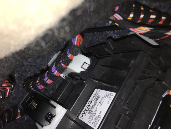

Is this the vehicle electrical control module you were referring to?
Saturday, September 15th, 2018 AT 12:11 PM

I have no idea about that module you did not say where you found that at.

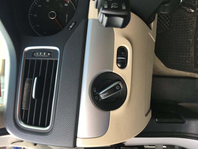

About that light switch, can I see the front of the switch?
Saturday, September 15th, 2018 AT 12:32 PM

That module is under the dash driver side. Behind the fuse block.

I read the module was at left side of dash and I do not know why the wires do not match up for the light switch. Perhaps you should give me the VIN so I can double check the vehicle.
