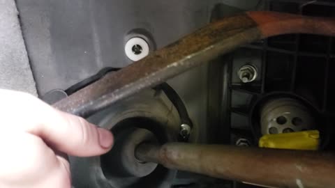

Attached is a video. When pressing the pedal to the floor there is a little popping noise when reaching the floor. Every time the noise happens the car will not move when in gear for a couple of seconds.

Sounds like something is mechanically touching the shaft when it is depressed. The booster, pedal bracket possibly.

After that sound Is made the pedal feels like there's no fluid until I bring it all the way up and it has pressure again. Of course this only happens in the driveway.

Either a mechanical issue with the master cylinder or booster would be my guess.

I can see it being the booster. The pedal does stick when it makes that clicking noise. However, can a booster problem like this make just one side lock up?
