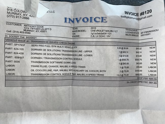

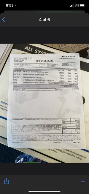

Here’s the work that was just done:
May 6, 2021 at 3:44 PM

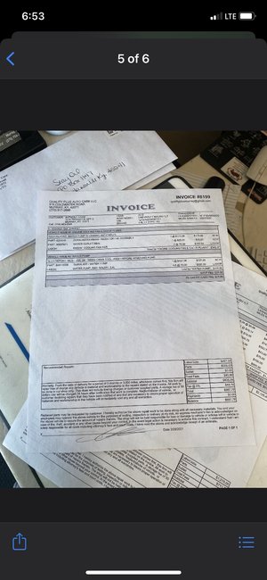

I could not read the invoices at all. Can you take pictures much closer for me to see?

The other invoice was for water pump and radiator fans because they claimed that was why it was acting up still.

Okay, thanks. I did notice there was no charge for a diagnostic.
Did you request this work or did they tell you it was what was wrong with your car?

I requested a diagnostic on my transmission since it went into limp mode during snow fun, they said it needed a TCM most likely so that’s how it all started.
May 6, 2021 at 4:03 PM
ANTHONY COOK
  • 17 POSTS
Kept calling me back saying it needed a fluid change along with because they’d lose the fluid and filter while they had the transmission dropped changing the lines out because those had leakage at the seals he showed that to me. so I believed that the fans I knew my driver side was bad so replaced that. then they called with the water pump saying it was bad. never seen or had any problems overheating until all of this, but it hasn’t overheated again just the limp mode.
May 6, 2021 at 4:04 PM
Okay, since they diagnosed it, they should stand behind the repair. If the recommended repair did not work, you should not be responsible for the TCM-related work.
