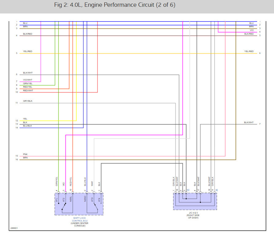

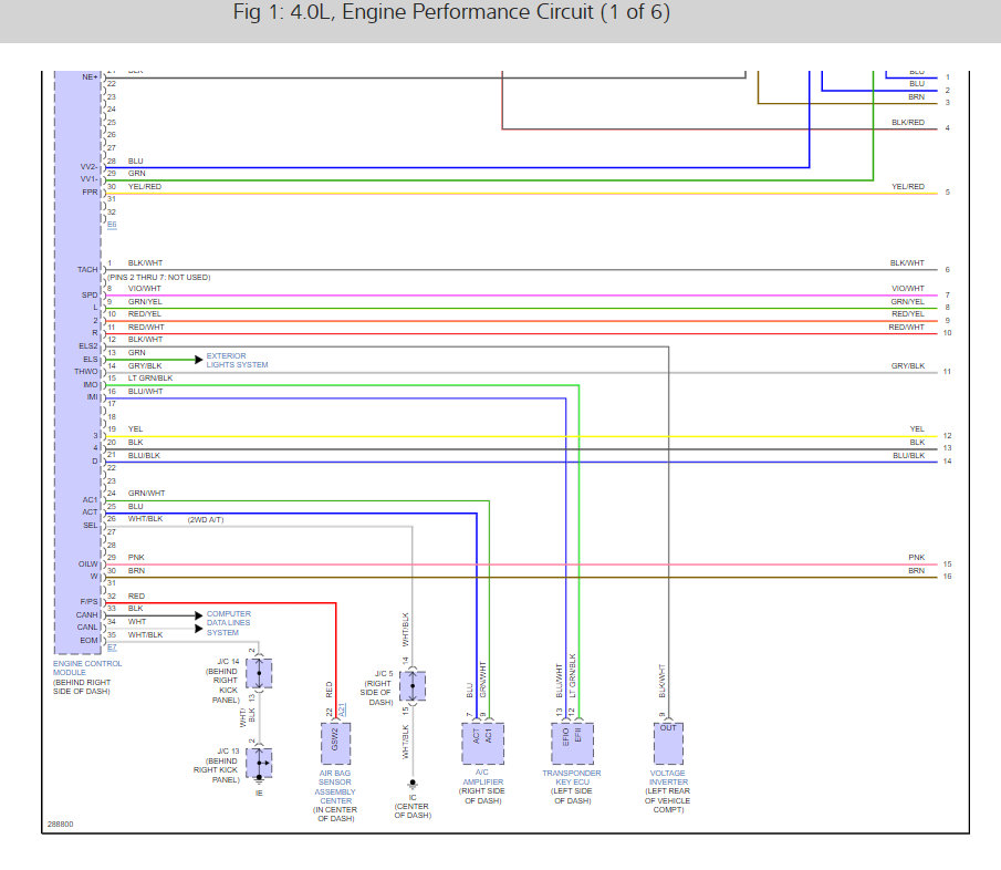

I have a 1gr 2008 Toyota Landcruiser which I change the engine to a Tacoma Engine. I will really appreciate your expert advice-I have been battling with an Error Code: P0340. I just changed the Camshaft in the bank 1 but the code still came back. All wirings to the ECM is okay. I have severally changed the Camshaft Position sensor severally but all to no avail. The mileage on the car is 105,500 kilometers.
Friday, August 26th, 2022 AT 6:38 AM
21 Replies
KEN L
  • MASTER CERTIFIED MECHANIC
  • 55,281 POSTS

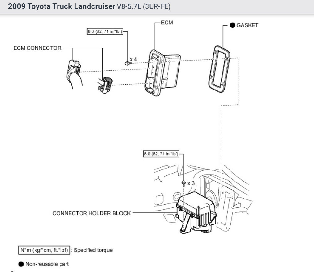

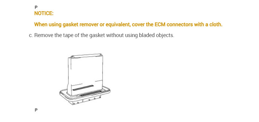

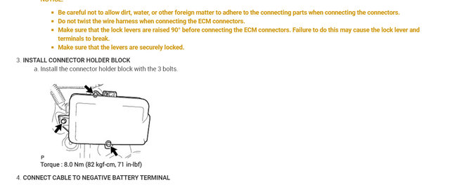

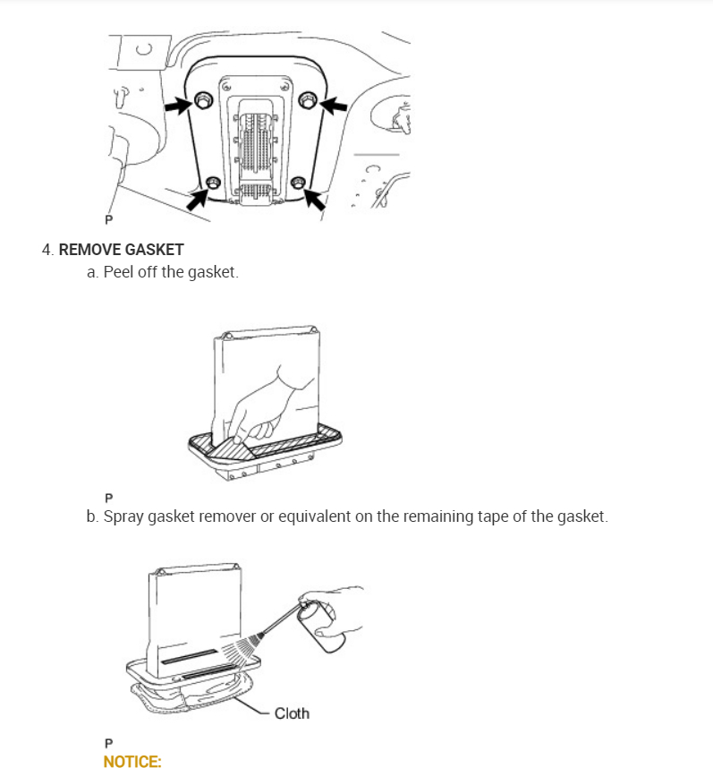

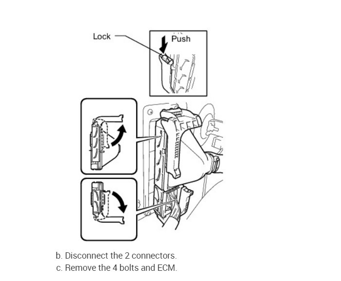

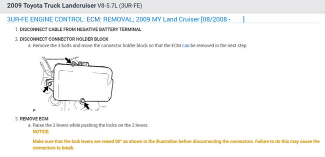

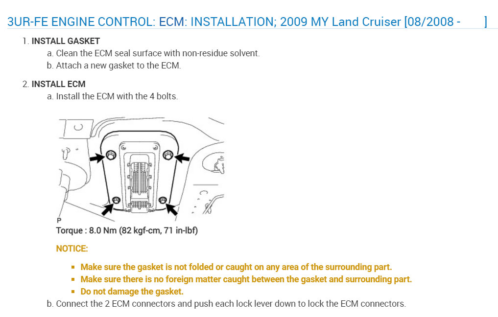

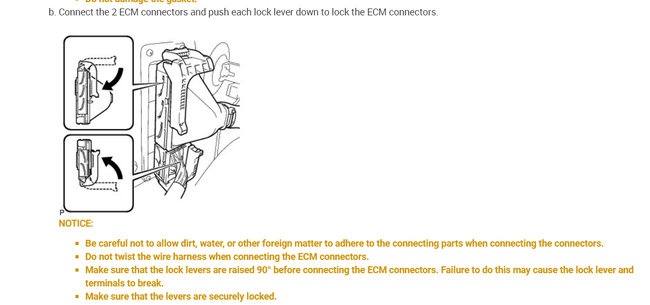

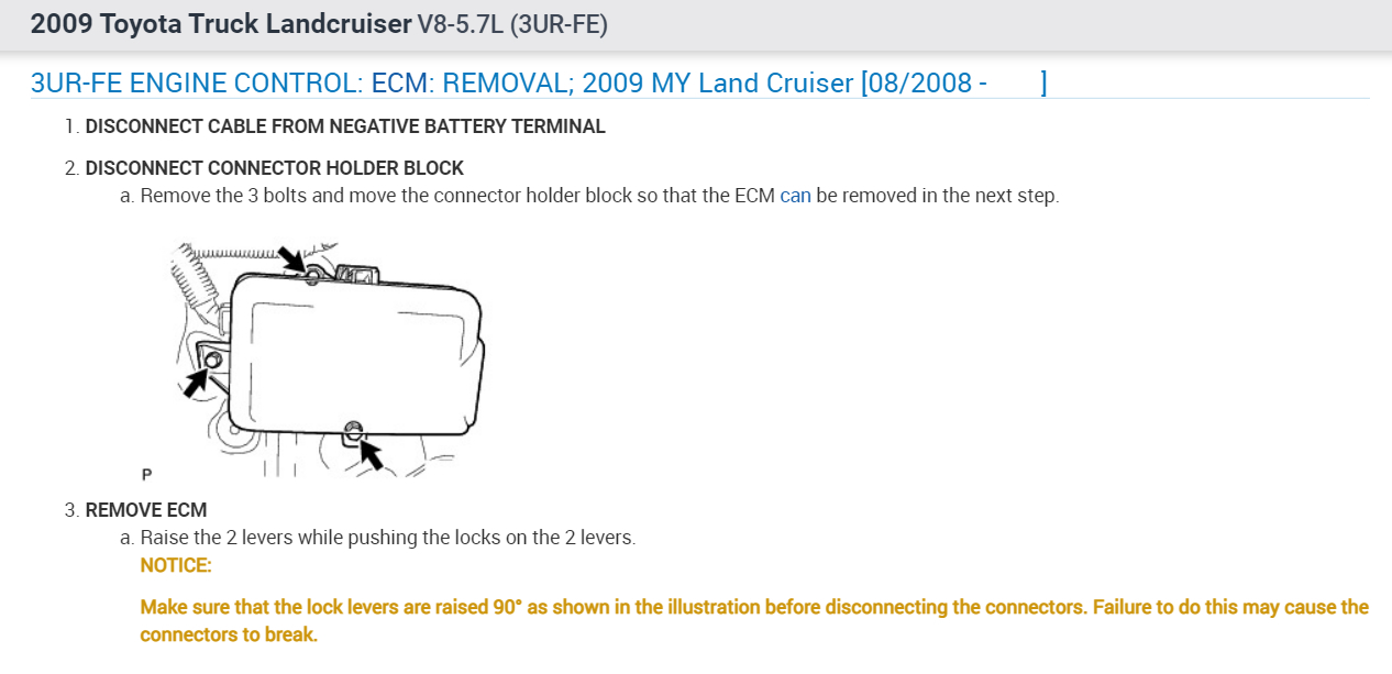

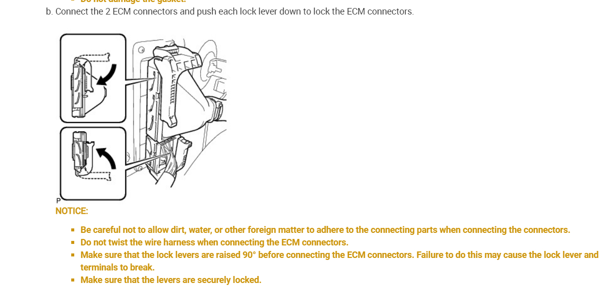

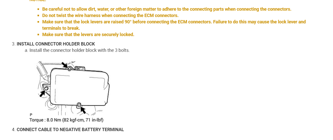

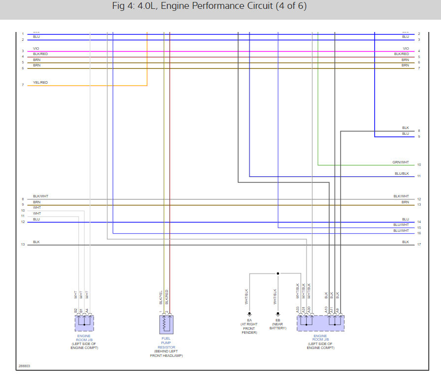

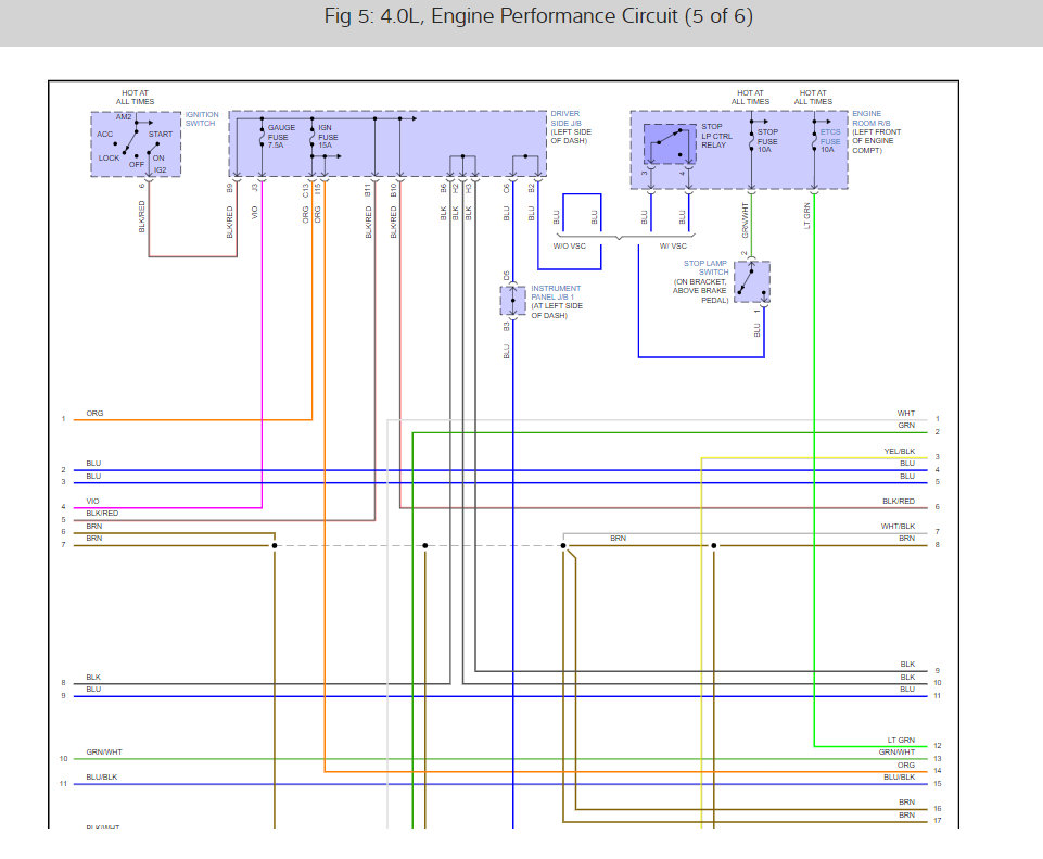

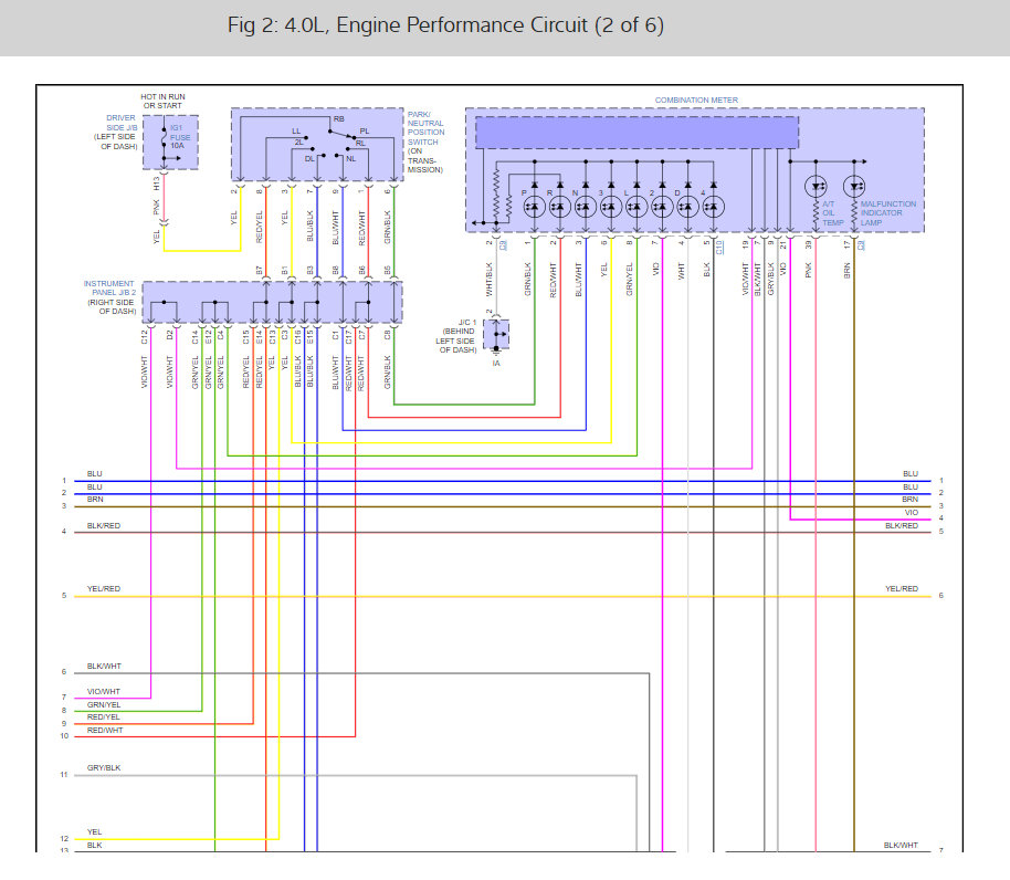

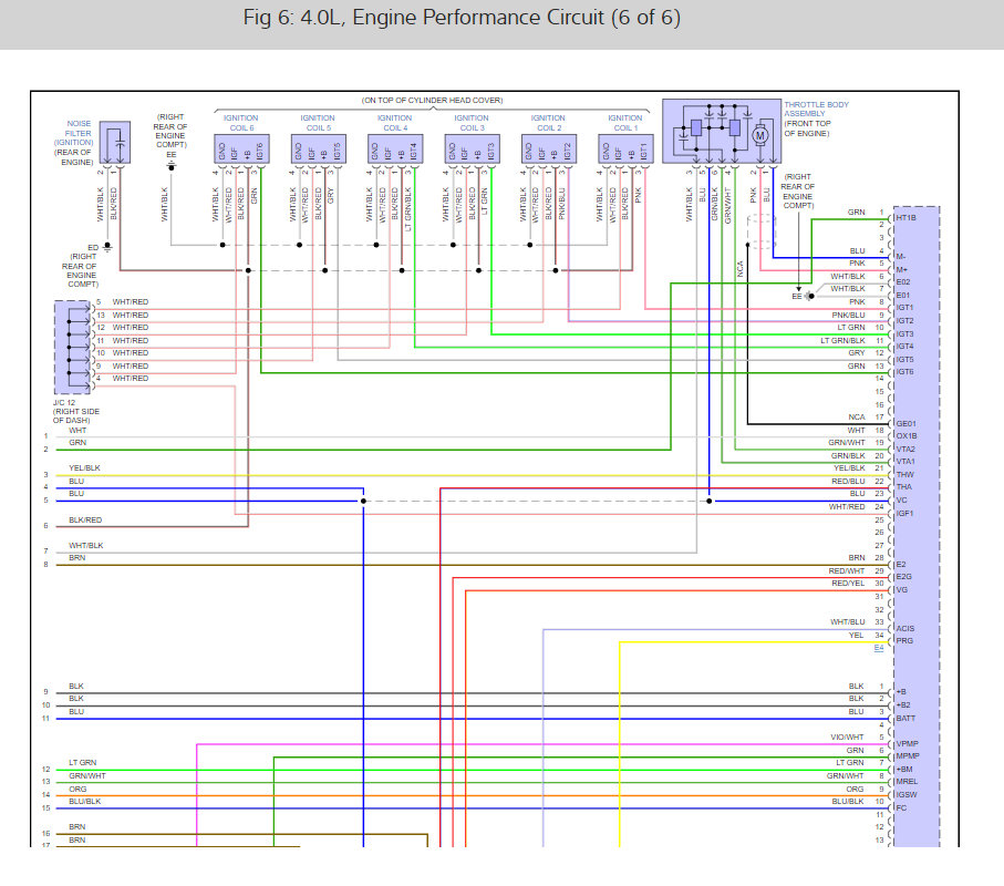

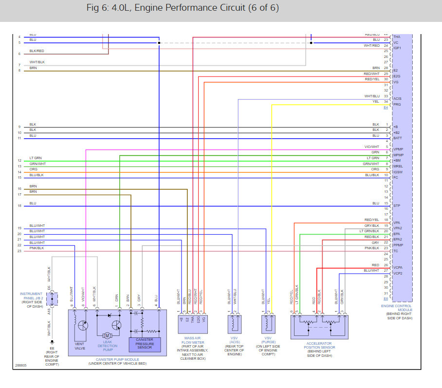

The P0340 code says there is a problem with the sensor or the wiring not the camshaft timing so that good, if the sensor is good and the wiring is good then the only thing left is the engine PCM. Here is the location and how to change it out to fix the problem. Check out the diagrams (below).

When they did the test did, they do a resistance to ground test? For the PCM I would check google or eBay and have the VIN number ready, let me know what happens.

If all is good, I would replace the PCM.

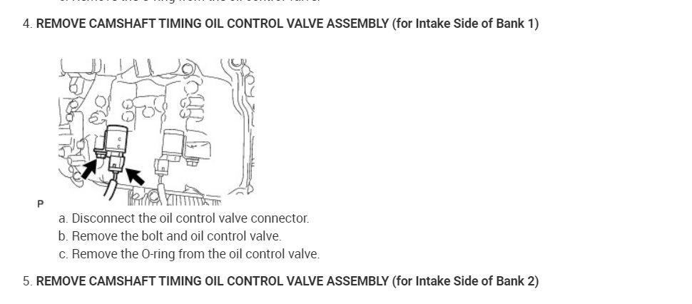

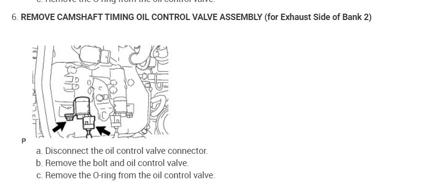

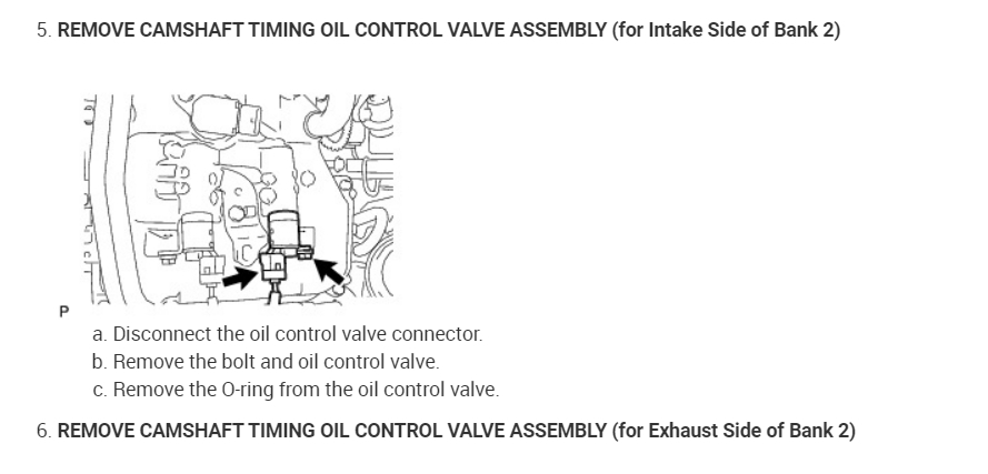

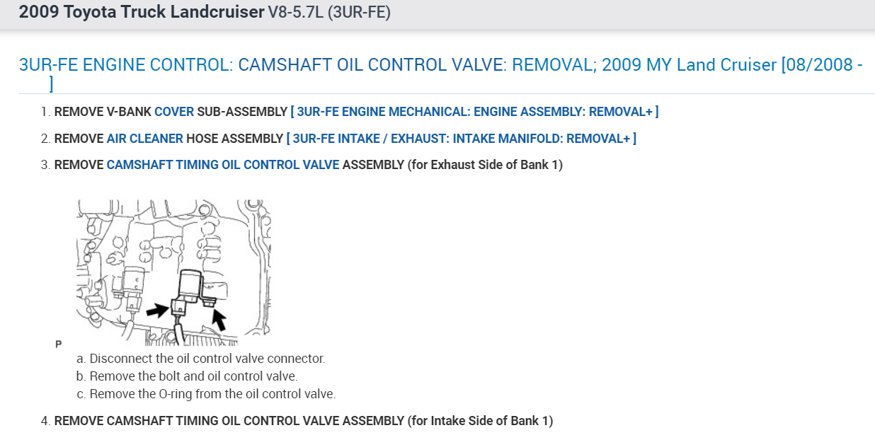

If the PCM is bad it can be intermittent. But I had thought it could be the camshaft timing actuator valve; they can get clogged up with metal shaving and gunk. Let's remove the valve and check, also the engine oil should be clean and full. Check the images below.
Tuesday, August 30th, 2022 AT 12:10 PM
DEEDEEDONALDS
  • 15 POSTS
Good day Ken L, done the above many times, in fact I even changed the two of them but the P0340 code still persists.

This leads back to faulty wiring, I would recheck the wiring connections.
Wednesday, September 7th, 2022 AT 12:32 PM
DEEDEEDONALDS
  • 15 POSTS
The electricians keep saying that wires on bank1 and bank2 camshaft sensors are through (working well) to PCM and the VVTI sensors wires are equally working well. This is what they have concluded from the checks done.
Remember, I told you that I have earlier changed the Bank1 Camshaft but the error code P0340 still returned.
Please can you give a detailed description of what the electricians are meant to do as regards checks on the wiring.
Please note that my car is a 1gr V6 2009 Land cruiser.
Thank you, Ken L.
Wednesday, September 7th, 2022 AT 11:06 PM
KEN L
  • 55,281 POSTS

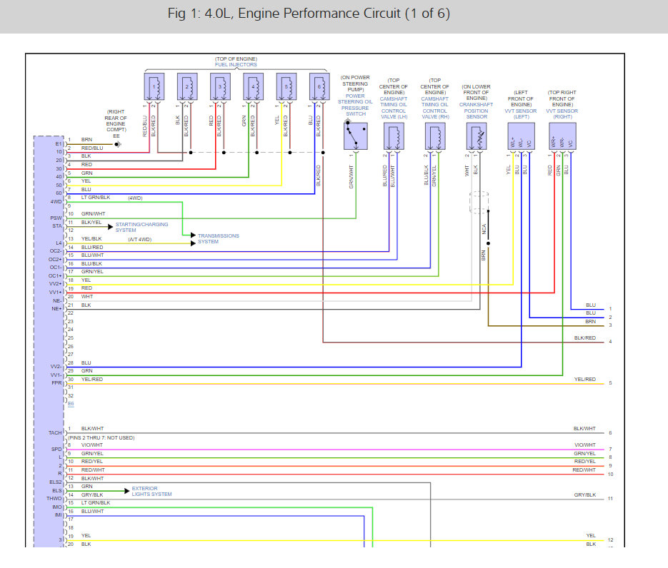

No problem, in this guide it shows the tests that need to be done:
Also did you sway out the PCM when you did the engine? If so, I can get you wiring diagrams just give me the year Tacoma the engine came from.

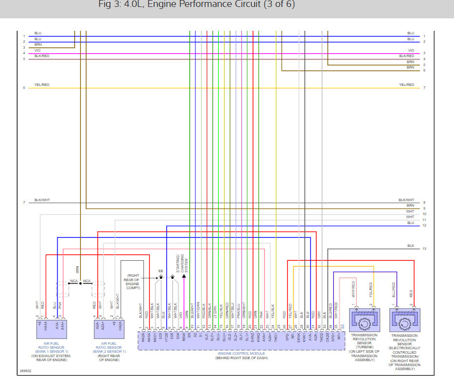

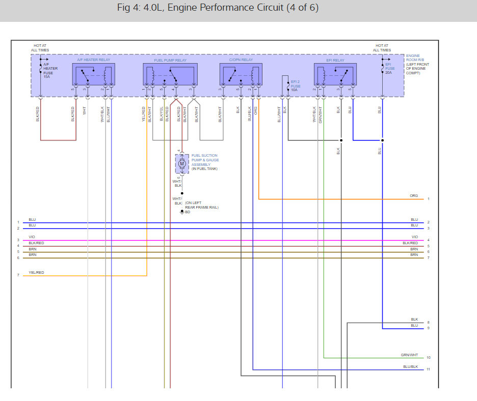

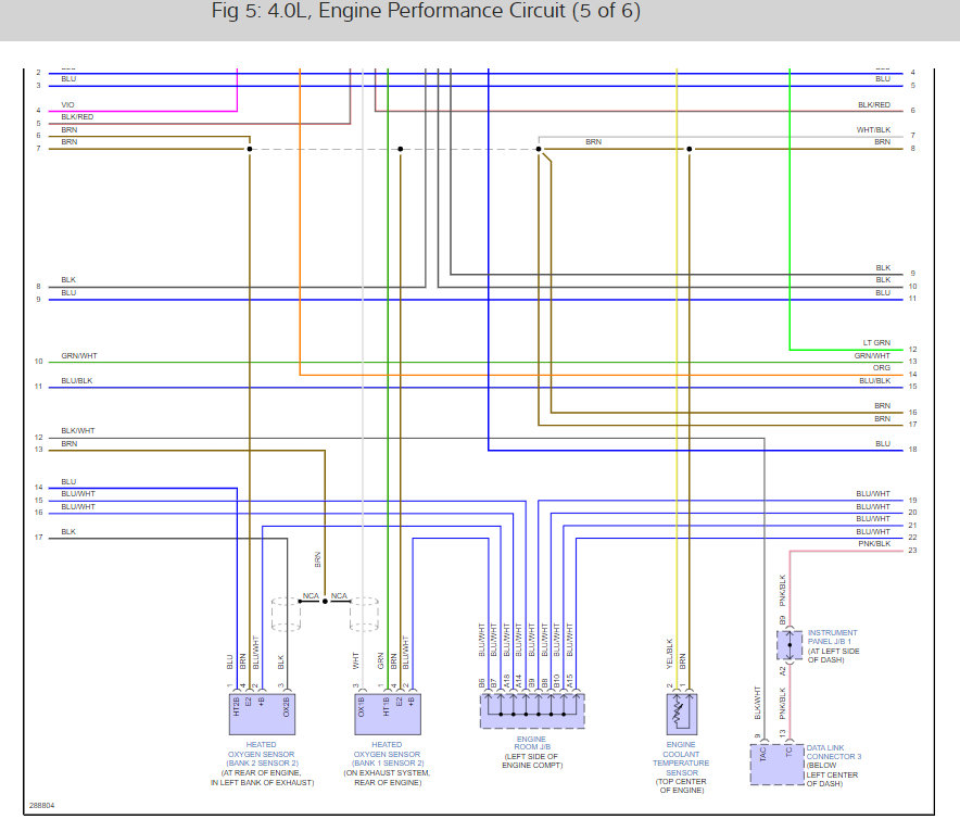

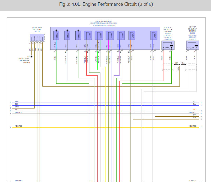

Not really from my information the dealer might be able to. Here are the engine wiring diagrams I think you will need. So, this truck has a V8 normally and you put a V6 in it?
Saturday, September 10th, 2022 AT 2:42 PM
DEEDEEDONALDS
  • 15 POSTS
The Tacoma engine in my car is a V6. I can find the wire diagram you talked about.
Sunday, September 11th, 2022 AT 5:57 AM
DEEDEEDONALDS
  • 15 POSTS
I cannot find the wire diagram.
