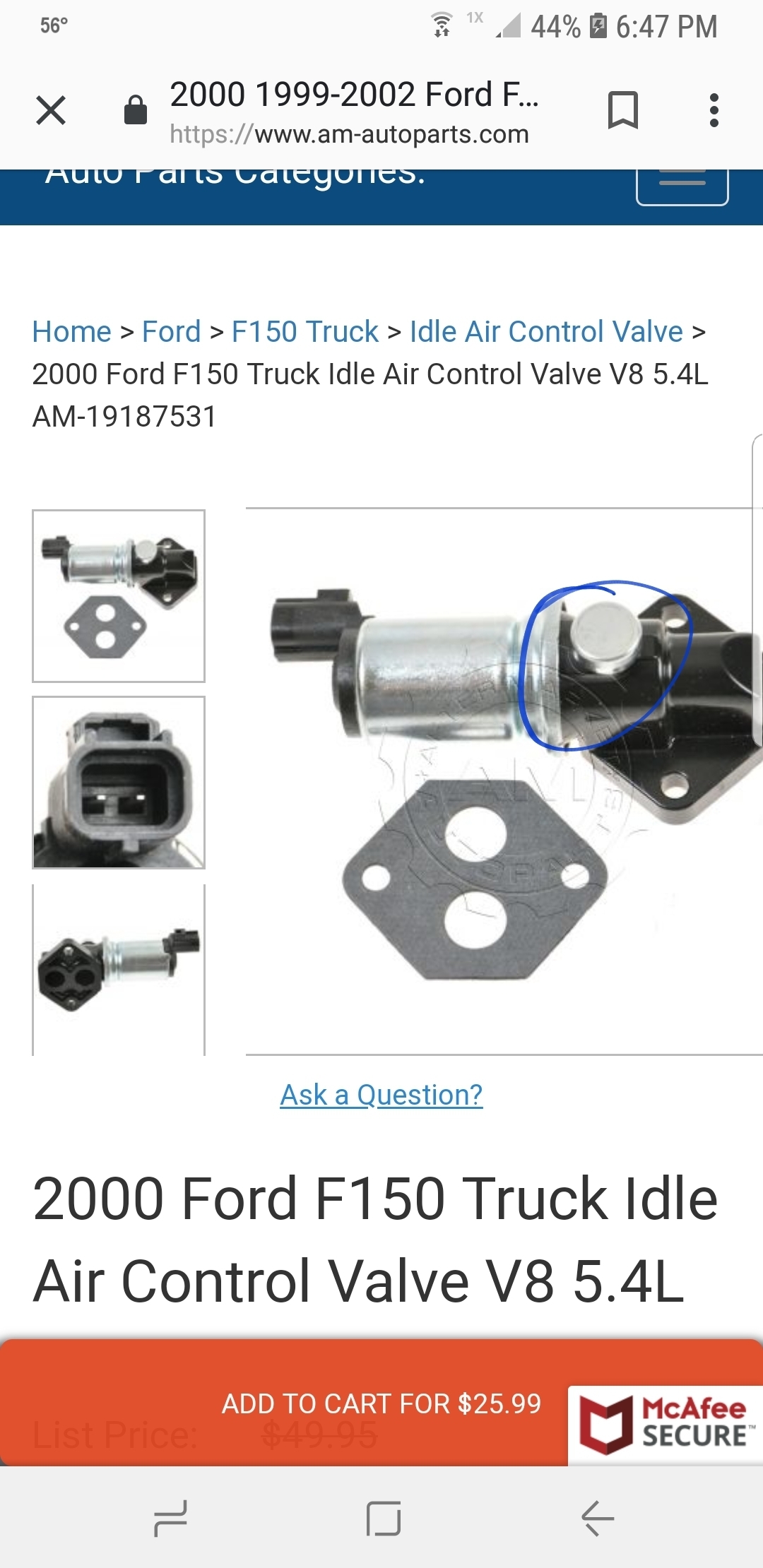

PACKERS27
  • 230 POSTS
This is not my IAC but its the same one for my truck and here is the cap I am talking about. It seems like it is for venting because the cigar smoke came out from under it. It was not excessive smoke but a small amount.
Tuesday, November 6th, 2018 AT 4:49 PM
PACKERS27
  • 230 POSTS
So after further research, I have read that this cap is suppose to do that. It is unmetered air but the PCM compensates for it. The cap is for pressure relief to balance the idle speed and without it, the idle cant be stabilized. That is good to know.
