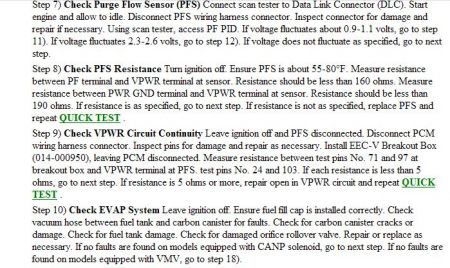

Evap emissions DTC P0443 is present. How do I fix it?
Thanks Rod

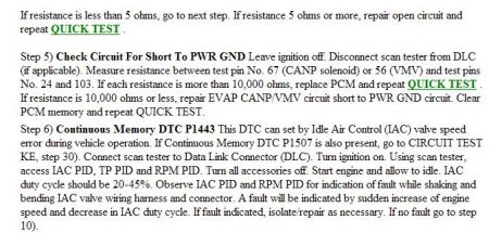

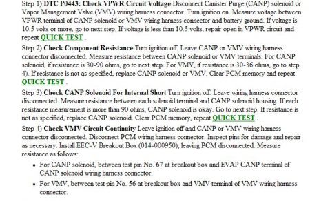

many, many things can cause this trouble code to appear. follow the steps below to troubleshoot the issue. i only posted the first few steps because as i said, many things need tested here. let me know if the steps lead you to a further step not posted yet..
