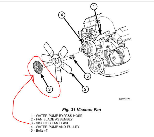

If the heater is working, chances are there is no more air in the system. I have a question. Will the truck overheat if you are driving at highway speeds? If not, then suspect the fan clutch is failing to spin the fan fast enough to cool it while it is parked.
The fan clutch has a thermostatic bimetallic spring in the front that reacts to temperature change. Only when sufficient heat is present will the viscous fan drive engage. This is when the air flowing through the radiator core causes a reaction to the bimetallic coil. It then increases fan speed to provide the necessary additional engine cooling. I attached a pic below showing what I'm referring to.
Often times, once the under-hood temperature is excessive, the fan will sound like a jet engine. Have you noticed anything sounding similar?
See pic below.

I didn't notice the jet engine noise. I had a box fan on top of the motor helping to cool the motor the 2nd time trying to burp the coolant. But I thought I had it burped, so I left and got up to about 35 mph for about 50 yards and then the temps started climbing from 205 to 217. So, I had to turn around down aways further and I was putting it and it held steady and went up some more to 221. So, I turned around and picked up the pace a little and it started to come back to 205 to 208 degrees. So, I repeated the burping and noticed no movement in the coolant with the cap off at the top where the cap goes so, I put the cap back on. It wants to overheat cap on or off at idle. If I hold it at 2000 RPMs constant it will come down to 199 to 205 and not climbed, but I let off and in 20 seconds temperatures start to go back up. It had pressure because I unscrewed the cap while it was still hot in a hurry. And it wants to spew so I know there is pressure.
It's just weird cause it was fine before I hosed out the heater core hoses and let about a gallon of fluid come out the block where the two hoses connect. Radiator feels symmetrical hot when I run my hands up the sides and down on both ends like no cold spots.
With truck off and give the fan a spin by hand it spins a third revolution maybe half.

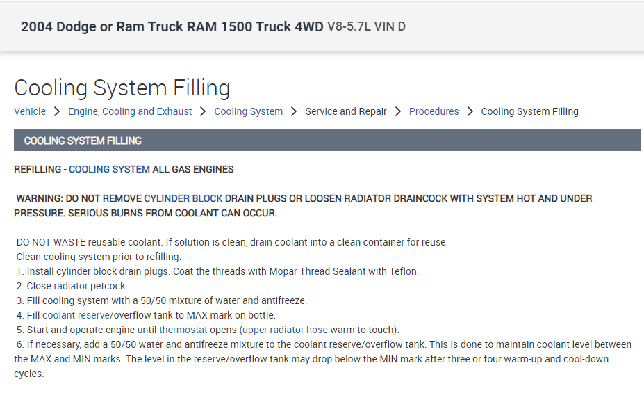

When you first replaced the coolant and filled it, did you have the heater on when you first allowed it to warm up?
Let me know. Also, I attached the directions from the manual below. I don't think you missed anything, but take a look to confirm.
See pic below

I did have the heater on when I was burping the coolant with the cap off and back on. It took a while to get the thermostat to open. The truck started to want to overheat with the cap off and the thermostat was not open yet. So, I was pumping the upper radiator hose and giving it throttle to 2000 RPMs and it just finally opened. But it still wants to overheat at idle even after it finally opening. I flushed the radiator, and it seemed to have flow out the drain when I sprayed the garden hose down the top at the radiator cap. Have a fan clutch ordered to install. The thermostat I replaced a few years ago. I don't drive the truck a lot. So maybe 5000 miles driven in the last 3 years.

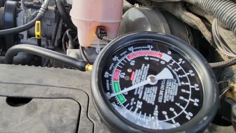

I have still been working on this issue. I replaced the fan clutch and a new 203* murray thermostat at the same time. Still having same issue. I bought a coolant funnel kit where you can burp the radiator coolant while running. I did that the other day for 35 to 40 minutes. I was getting bubbles when I rev the motor and let off. I stopped after 35 to 40 minutes cause I didn't see any more builbbles and the temp was holding steady.
Took the vehicle out and drove it 5 miles seemed fine and parked idled for 5 to 10 minutes and still fine.
Go out to check the truck again after setting for 3 days. Let it idle to 170* and give steady rpm for 1 minute to get it more up to temperature. Got it to 192* and let it idle the rest of the way. Slowly starts coming up and thinking it would stop at 203* it just keeps climing up to 214* so I give it throttle to 2500rpm steady and takes 15-20 seconds and starts coming back down to 199*- 201*. Let it idle again and stays around 205*-207*. Hook up vaccumm gauge to get readings and it has steady 19 psi at idle. Steady 2500rpm it goes to 22.5 psi let off throttle and it bumps to 25 steady and back to 19 at idle. I do quick revs and let off a few times and vaccum drops to 11 psi and then back to 19 psi at idle.
So I took it out on a 12 mile dive and it does okay. With temps go to 208* and then back to 203* it does that on and off driving. Sometimes staying at 203*. Get back and park it at idle for 10 minutes and stays at 205* for 5 minutes and then to 203* for 5 minutes before I shut it off.

I did some more testing today. I first took the truck out on a drive from First starting it up and the temperature kept climbing up to 214 degrees and I thought it was going to keep going but it stayed there for about 10 seconds and then started to come back down to 200 degrees for a minute and then to 203 degrees the rest of the 25 minute drive other than accelerating it would get to 208 and back to 203. When I got back I did the combustion leak test in the resivor because I couldn't get the fluid low enough in the radiator and the blue liquid never turned yellow. So unsure why on cold starts it wants to climb the temps like it's going to overheat. Unless it's air in the coolant don't know cause I burped it with the funnel for 30 minutes last time. Not sure exactly what's causing it.
Sunday, September 29th, 2024 AT 6:56 AM
  • 110,194 POSTS
Based on your description, it seems to be working as designed. Until the thermostat fully opens, it will continue increasing in temp. Once reached, it takes a bit for the coolant to be cooled by the radiator and lower the temperature. If it runs at 203°F, that is fine.
