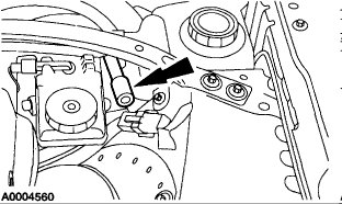

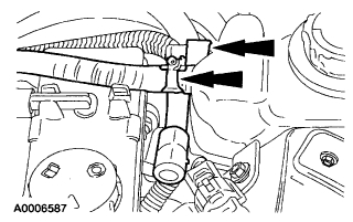

First you need to verify you did not get an air pocket in the cooling system. Here is the procedure for bleeding. First pic is the air bleeder. Second pic is the heater bleed. Here are the instructions

I cannot find the heater bleed.
Sunday, December 10th, 2017 AT 4:21 PM
JIS001
  • 3,412 POSTS

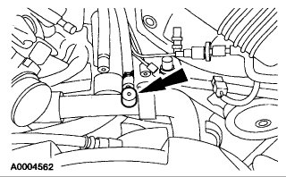

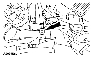

According to the diagram, it looks like it is on the driver side firewall. Looks like next to bottle. Here is another picture with the cowl off.
Sunday, December 10th, 2017 AT 4:48 PM
JULIAN ADAME
  • 7 POSTS
The one from the first picture?
Sunday, December 10th, 2017 AT 4:51 PM
JIS001
  • 3,412 POSTS
The second picture. If you cannot find it try to bleed from the bleeder in the first piture. Turn heater on. When a steady flow of coolant comes out, shut vehicle off and let it cool down and repeat the step if you see the level drop in the bottle.
