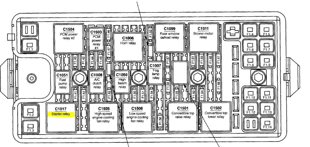

Hi:
I've never been asked to break one before. LOL One thing you can do is remove the starter relay under the hood of the vehicle in the relay/fuse box. That will prevent the starter from engaging and starting the engine.
I attached a picture below.
