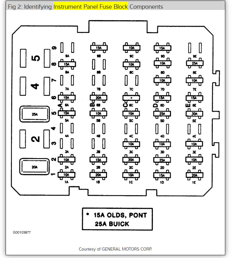

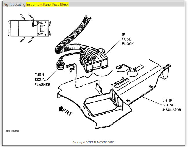

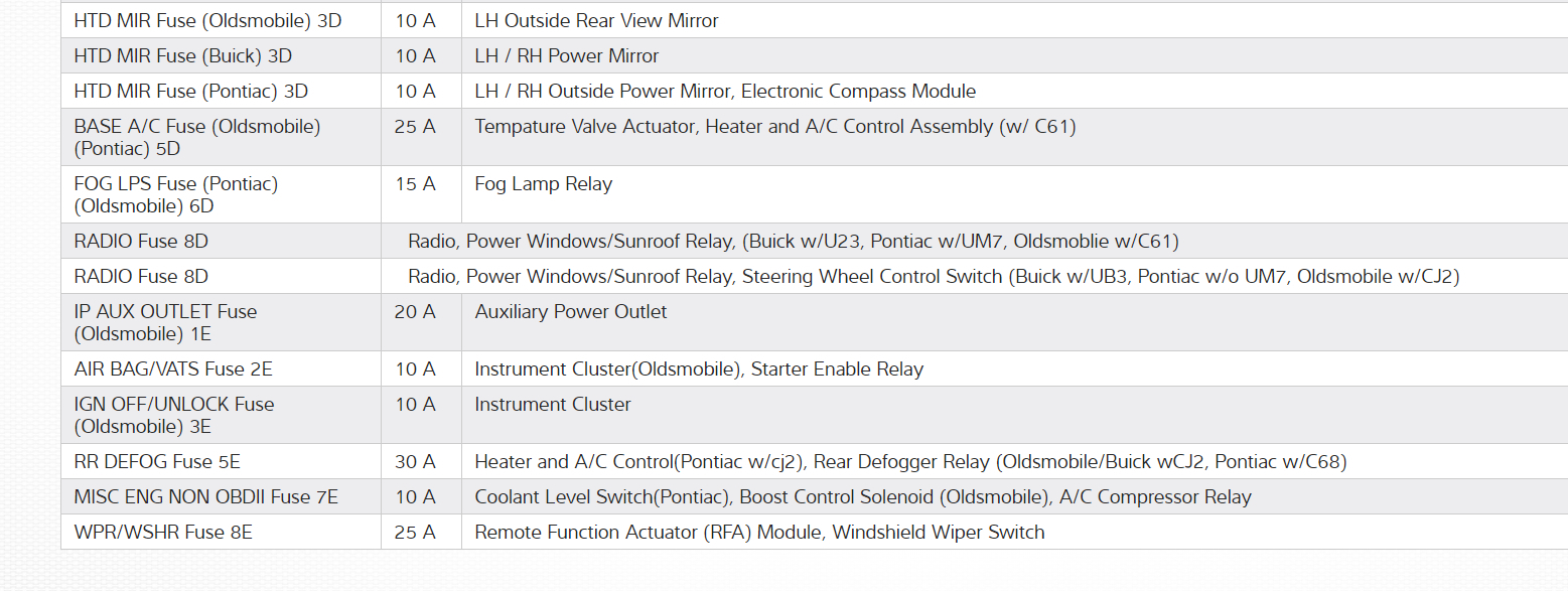

The cigarette lighter that I plug my cell phone charger in to on my 1998 Olds Delta 88 quit working. I tried to plug in the other cigarette lighter lead in wire to that one but it did not fit. When I hooked it up like it is supposed to be, neither lighter worked. I'm thinking I blew a fuse, although the ashtray light does still work. Where is the fuse box located on this car?
Apr 13, 2008 at 11:04 AM
KURTVERB65

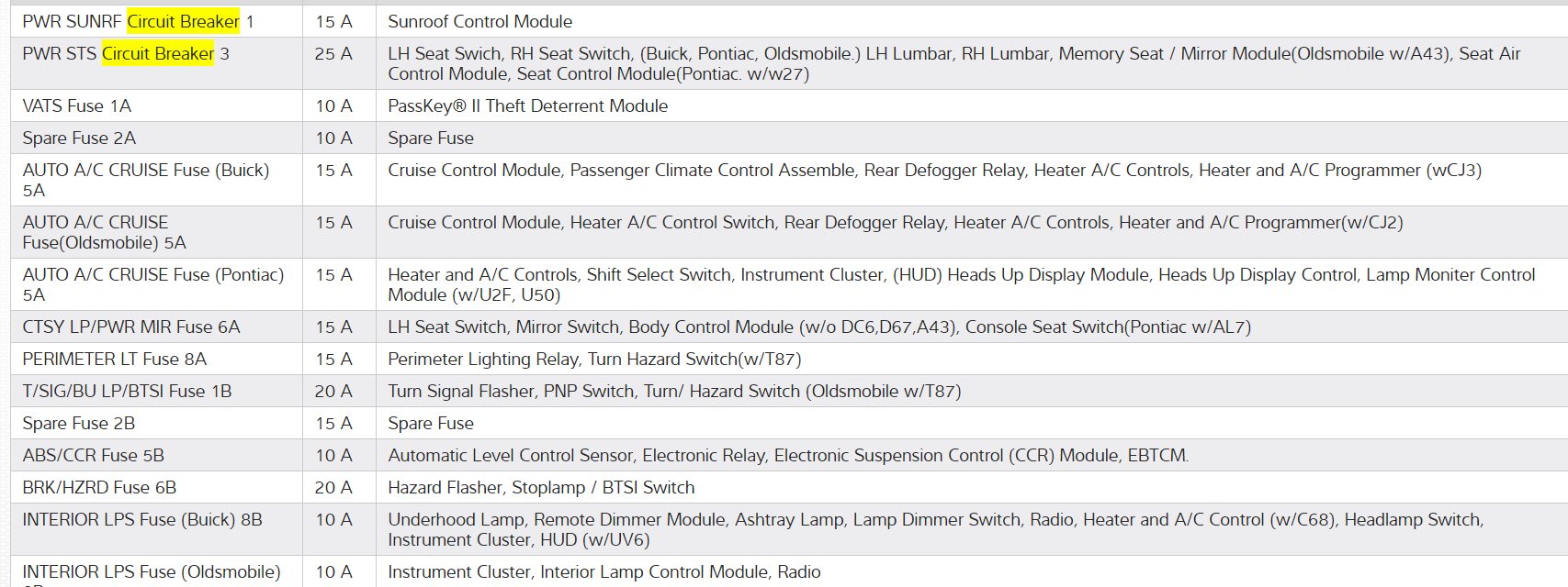

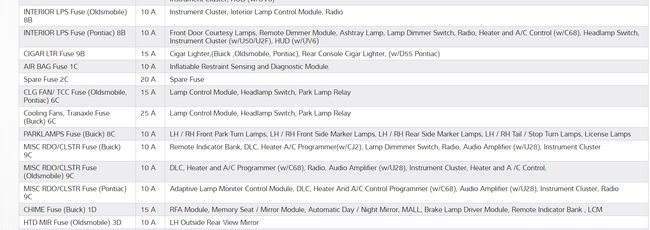

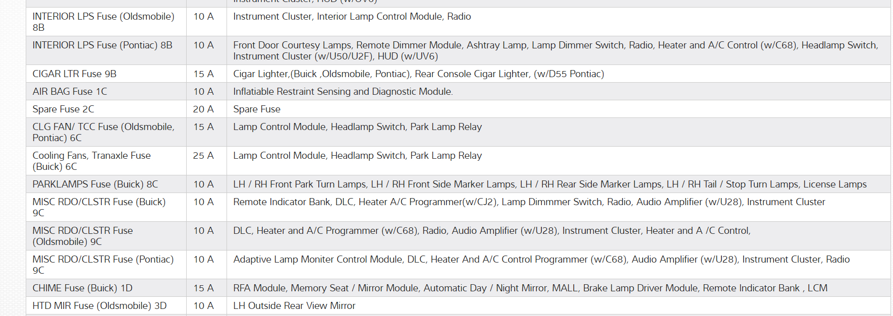

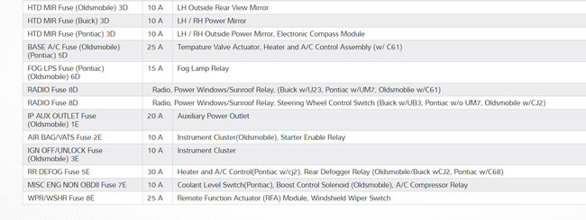

It is fuse #9B inthe fuse panel here isa guide and the fuse location below to help you get the problem fixed.
