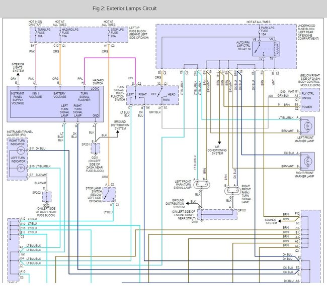

While driving my car there is a random turn signal sound coming from the dash. We have removed the vent and have accessed the hazard switch. If this is removed, we do not hear any sound, however the turn signals fail to work. Periodically you can hear a sound that is reminiscent of an electrical short. we thought it could be the hazard switch that was bad but have purchased a used one and the sound continues. Is it possible that the turn signal/head light switch can be the part that is going bad?
Jun 26, 2020 at 12:00 PM (Merged)
BLUELIGHTNIN6
  • CAR REPAIR CONTRIBUTOR
  • 16,542 POSTS
may be a loose / weak ground wire at the switch causing the issue. inspect wiring to the signal switch and hazard switch, if all wiring is OK then signal switch may be at fault.

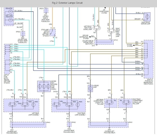

There is a auto park lamp control relay that looks like it controls the power to the turn signals that could be out, here is a guide and a diagram that can help you get the problem fixed. Also you can check for power and see if you are loosing it somewhere.
and
Please run this test and get back to us so we can continue helping you.
Best, Ken
Jun 26, 2020 at 12:01 PM (Merged)
