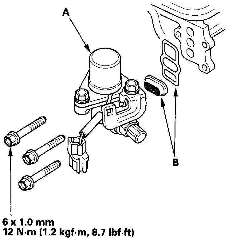

The diagram you attached is definitely the part that was leaking engine oil profusely (one drop per second). Some sources refer to this valve as a Vtec solenoid valve, others call it a VVT. I'm not some which is correct or what this valve does, but by replacing both seals the leak has stopped!! It looked like the major portion of the leak was at the engine block to valve body interface caused by hardened rubber seal with complete compression set. (The valve body seal contained a new screen, as your diagram indicates, so there was no need to clean the old one - it wasn't dirty anyway). It cost me $16 bucks for the seal kit, $40 worth of wrenches and a little blood loss from scrapes due to confined spaces.
