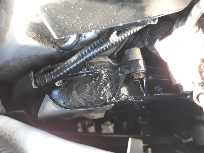

I noticed oil all over the passenger side bottom of engine. As i inspected to see where it could be coming from, i noticed a circle rubber seal popped off the side of the engine. It was ripped so i couldnt reattached it. I got some sealant auto tape to cover it but i looked online and in my owners manual to figure out what this seal is called with no luck. Then a metal attachment above the engine has a slow leak coming from it as well. Help

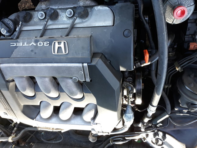

I have one photo for now. I can't do the finger thing until morning. The grey patch is where the quarter sized hole is. And the curved metal pipe/tube thing is rite in front. I had a rebuilt engine, new radiator and radiator fan put in last year around October. I honestly don't know how many miles is on the rebuilt engine. I didn't ask. I was just glad my car was fixed. And it wasn't something i even thought to ask when it was done.

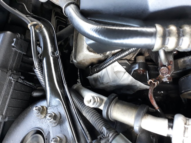

More about the picture, the black hose where it meets the goldish metal is where one of the leaks are besides where the grey patch is (quarter sized hole) and the seal that broke off was all filled in like a quarter, not like an o-ring.

Okay. The black hose there is a power steering fluid line. It's under pressure when the car is running. It's not uncommon for them to start leaking where the rubber hose meets the metal fitting. The leak would only happen while the car was running. The leak would be really pronounced while turning the wheel all the way. So you might observe that hose while someone else turns the wheel all the way in one direction and holds it there.
The other line there is an A/C line. They can get pretty cool when you're running the air, resulting on condensation building up and then falling or running off. This can create the appearance of a leak, so you have to check around and see if it's just water that's leaked down and gotten all greasy and cruddy looking before it got to the ground .

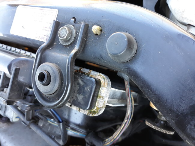

I think i am totally screwed now. I took my daughter to school and i saw smoke coming from underneath the hood. When i got a chance to look, i now have antifreeze all over the place.

Not necessarily screwed. There's probably a coolant hose somewhere nearby that blew. It must've been leaking just a little. But since it's under pressure, a little leak became a big one. If the car didn't overheat, then that's going to be a small and relatively cheap fix. Poke around and find that leak.
All you have to do is borrow a cooling system pressure tester from the local parts store. When the car is cold, open the hood and refill the cooling system. Then connect the pressure tester, pump the pressure tester, and look for the leak. Take a few pictures and post them here. I'll give you through the process of fixing it yourself if possible.
Try that and we'll go from there. Good luck!

So i didn't get to the auto store yesterday because my son stayed home from school. I just got back from Advanced Auto and they told me that pressure test thing is $259.00 to rent. I don't have that at all. We only survive on my sons disability check so funds are limited. But since the car has been sitting since last Thursday I didn't experience any smoking from underneath the hood probably because i didn't run the car long enough to get hot, i am guessing. But still the other leaks and i took a picture of where there is dried antifreeze. My oil was still full and i had to add power steering fluid when i got to Advanced Auto and my coolant was still at the level it was when i parked it last Thursday. So i don't know what to do next.

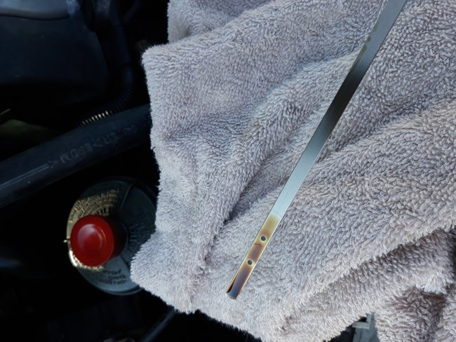

It looks like the radiator is leaking and you have a seal that is out in the front of the engine in the timing belt area. Also the oil is too full which can push the engine seals out and create the leak. Here is a guide to help walk you through the radiator replacement and diagrams below to help you take the front of the engine apart:
https://www.2carpros.com/articles/how-to-replace-a-car-radiator
I would do the timing belt and water pump while you are in there. Do all seals as well. Check out the diagrams (below). Please let us know what you find. We are interested to see what it is.
