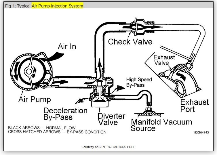

If the relay is bad would the pump still come on?

Maybe. It could get stuck on or it could not be coming on at all.

It comes on for a minute then shuts off.

Well it is not that then. Something has got to either be plugged up or the valve on the pump is jammed.

Is there a switch for the check valves?
Thursday, February 22nd, 2018 AT 9:46 PM
HARRY P
  • 2,291 POSTS
There is a check valve in there. I *believe* it is in the hose leading from the pump to the exhaust. I am attaching a diagram that is provided by GM. Personally, I would bet that that check valve is not opening and that is what is causing your issue. It is likely a dealership only part, but it would not hurt to try the local auto parts shops and rock auto.

So when the air pump comes on is it suppose to sound like humming or a mini vacuum?
Friday, February 23rd, 2018 AT 2:18 PM
HARRY P
  • 2,291 POSTS
Something like that. I haven't specifically heard the one on those cars, but that's the general gist of it. Find that check valve. Replacing it shouldn't be expensive (Check valves aren't exactly new and exclusive technology).

I just replaced the valves couple weeks ago
Friday, February 23rd, 2018 AT 8:03 PM
HARRY P
  • 2,291 POSTS
Well from what I understand, the code indicates that there's some sort of flow error from the pump. So if you're hearing the pump run, and feeling it blowing air, then there has to be a blockage or something along those lines.

Well today I change the relay and when I was changing the relay I only got a portion of it out and then the air pump came on sounded like a mini vacuum. Before the pump would only make a humming sound and I couldn't hear or feel any air coming from the pump. I just bought an air pump from rockauto brand new a couple weeks ago. My old pump would make the same sound.

There has to be an airflow issue somewhere in there. If the pump is pumping air, then there's something else going on. Either no air is getting through (jammed check valve, clogged tube) or too much air is getting through (check valve stuck open or a leak in the tube).
