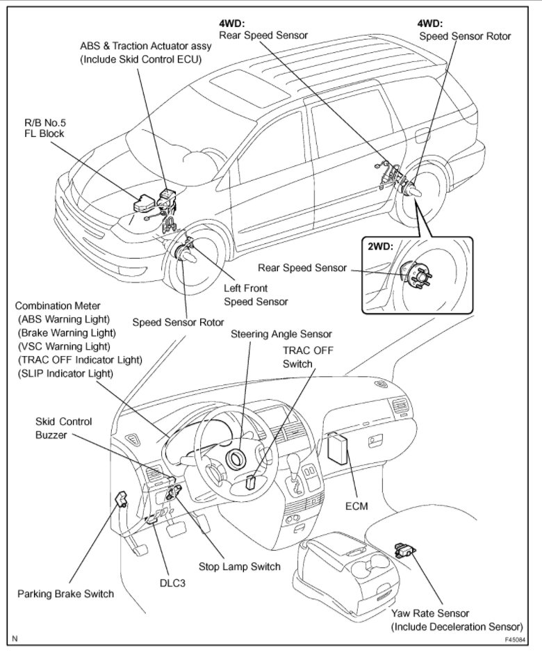

ABS light is on, odometer though at 120,000 is no more reading. The horn also fails to work at speed above twenty km per hour.

It sounds like you have an ABS wheel speed sensor that has gone out.

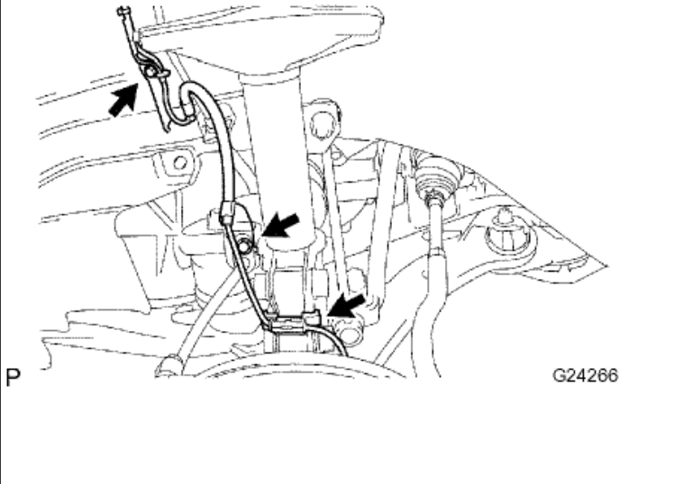

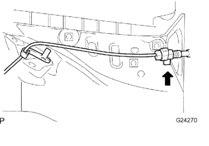

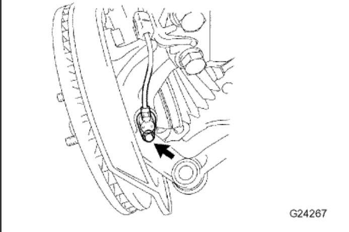

and if bad here is a guide that will give you an idea on what you are in for when changing the sensor out.
https://www.2carpros.com/articles/how-to-replace-an-abs-wheel-speed-sensor
Here is what it will be like on your car (below).
Please let us know what you find. I'm interested to see what it is.
