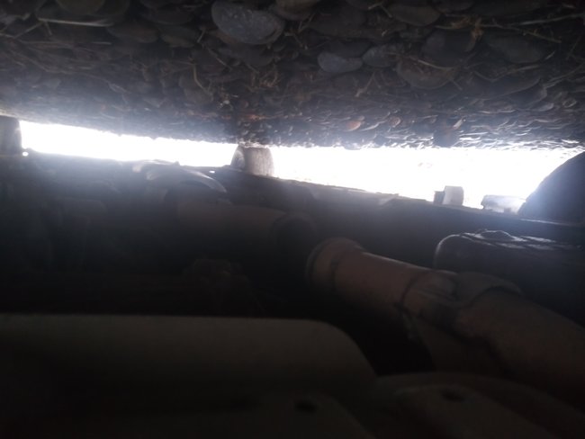

This is the cause of the bad exhaust leak.
Sunday, December 29th, 2019 AT 8:09 AM
It sure is. The flange broke holding the 2 pipes together.
You can buy just the flange and join them back together.
As far as the converter, I will need to see some more pictures on that part.
