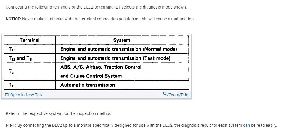

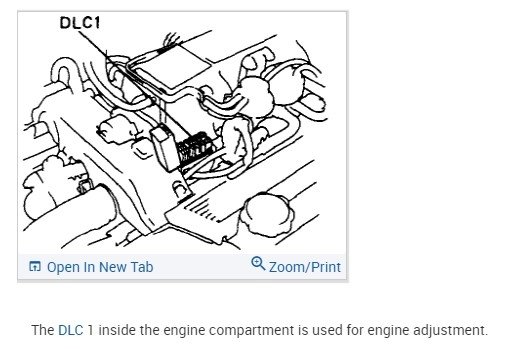

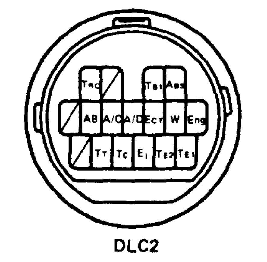

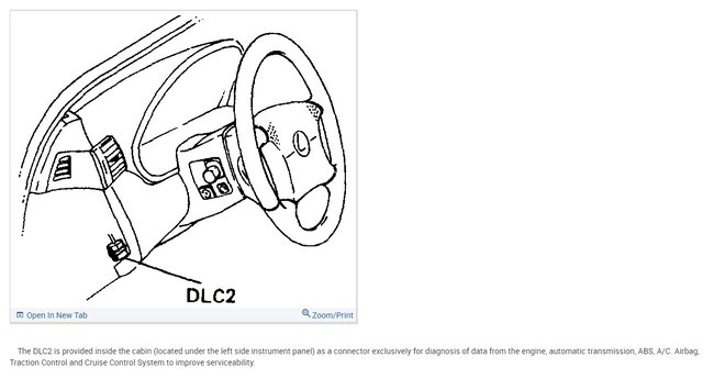

I'm looking for the obd 1 port under the dash of my sc400, is this it?
Thursday, March 3rd, 2022 AT 1:40 AM
WENDY W
MECHANIC
86 POSTS
I've attached diagrams and locations of both the DLC1 and DLC2 connectors for this vehicle (below).
These repair guides might be helpful too:
https://www.2carpros.com/articles/lexus-trouble-codes-obd1-1990-1995-code-retrieval-procedure
If you need any further assistance, please let us know.
