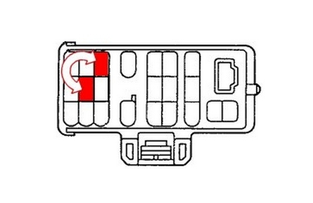

Step 1 - Locate the diagnostic connector (data port connector) under the hood, near the passenger side fender.
Step 2 - Remove the protective identification cap and wipe away excess die-electric grease. Identify the TE1 and TE terminals which are shown under the cover, and by the diagram below.
lexus data connector
Lexus Diagnostic Data Connector TE1 and TE Terminals
Step 3 - Once the terminals have been identified, insert a jumper wire.
Step 4 - Next, turn the ignition key to the "ON" position while observing the check engine light which will start to flash. The first set of blinks will be the first position of the numerical trouble code. Then a pause will occur, the next digit will start to flash. For example, if the check engine light flashes three times, and then pauses, then flashes one more time the code number would be 31.
Step 5 - After the repair has been made clear trouble codes, turn the ignition key off, remove the jumper wire and disconnect the negative battery cable for three minutes and reconnect, the codes will be cleared.
