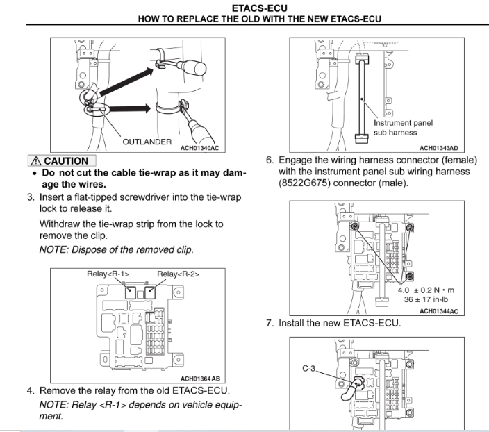

Joe,

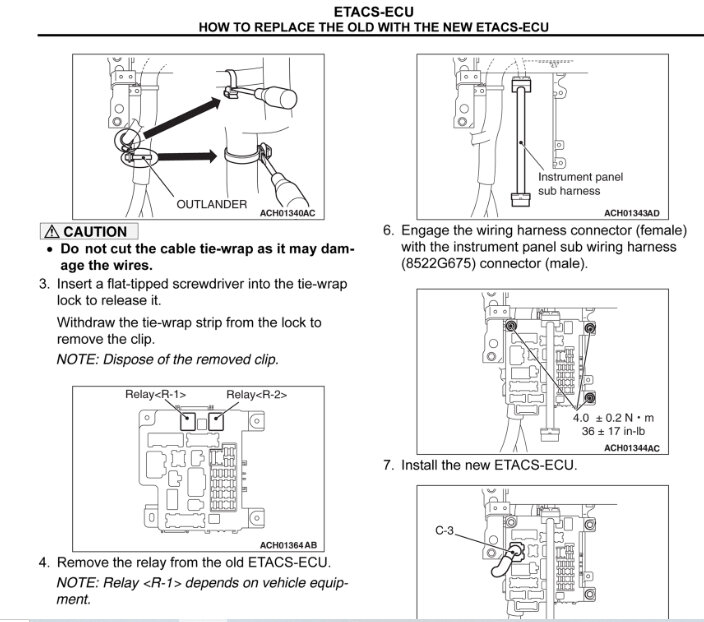

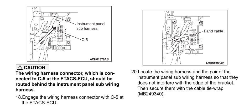

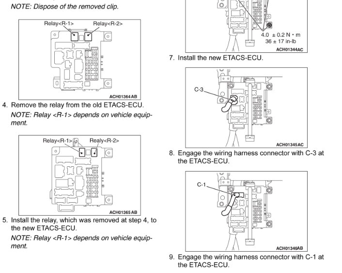

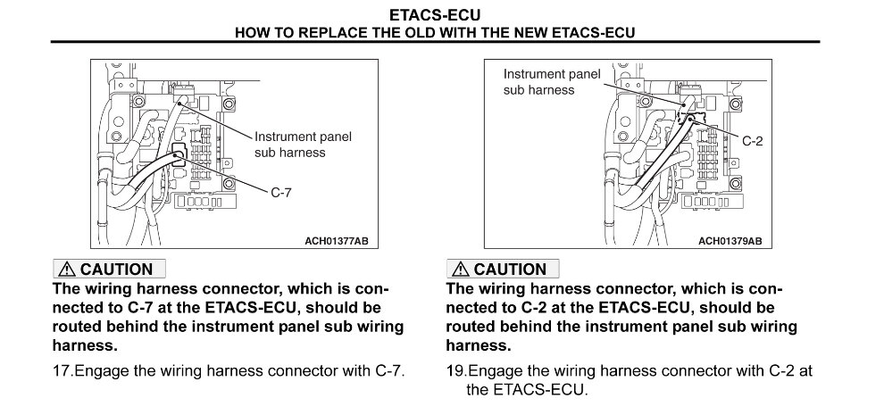

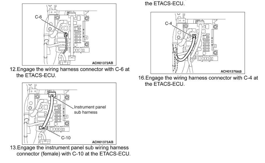

When I tried to print the pics of the schematics and picture of the location of ETACS something happened, and I lost them. Could you please send them again and make them larger if possible?

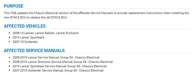

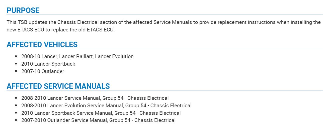

Are you referring to the ones I attached from the TSB? They would have been the last ones I sent.

Yes, those are the right ones. I tried to print them, and they disappeared. I have a couple of things I want to double check before looking for parts. That module under the dash, the one I am trying to identify, looks brand new. I am open to any suggestions from you. Today was bad weather. Day so did not get to the car, it is outside.

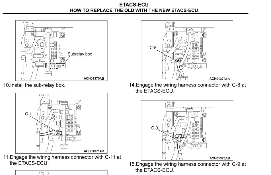

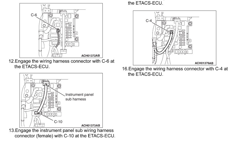

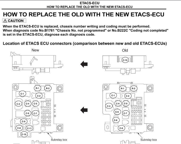

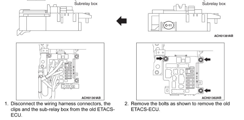

No problem. I attached the directions below. I cut each one in half to make them more readable. Let me know if that helps.

Thanks for the schematics and info you sent I can read now because of the larger print. I have taken a break, that's why I have not been. Talking to you. I looked for the ETACS-ECM' but gave up and decided to take a break. As I go further I will contact you. Hope to get some nice weather to continue. As near as I can figure, the part # for the ETACS-ECM is 1860A843. Not 100% sure. I will be back in touch.
