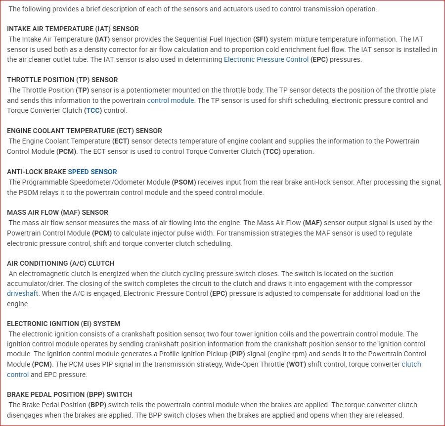

Truck was not shifting into fourth and fifth gear, so I put a new transmission in still does the same thing.
Monday, May 6th, 2019 AT 1:00 PM
13 Replies

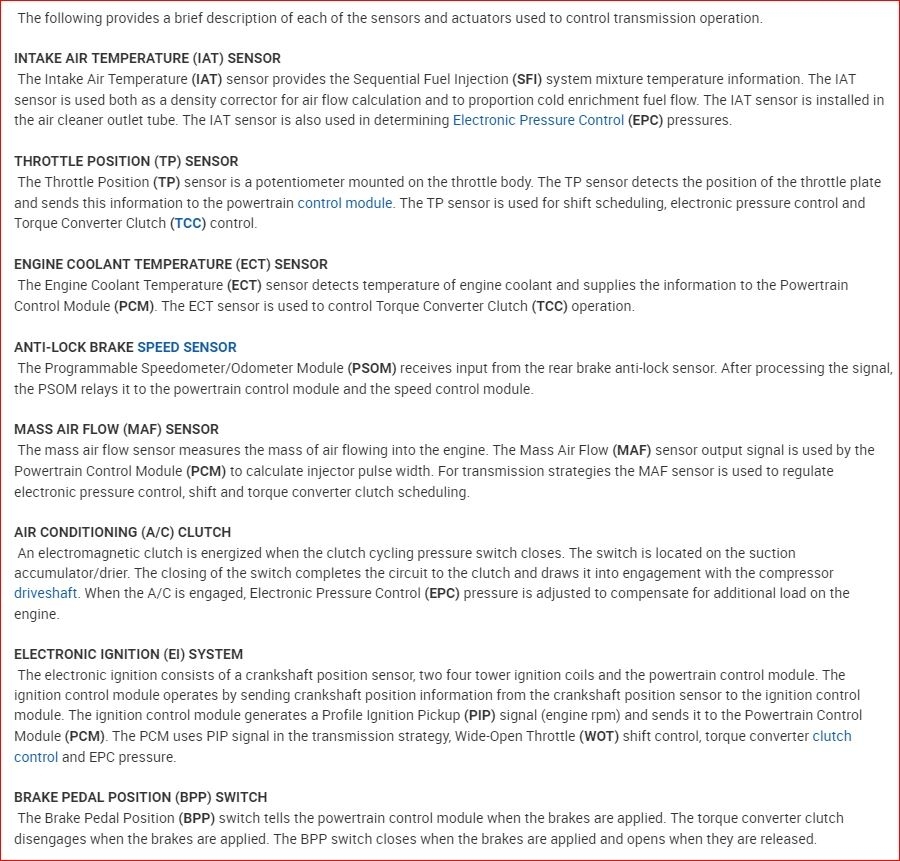

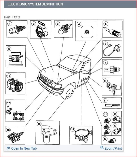

Hi CD OWENBY,
I attached the detail about the transmission control system. If the transmission does not engage fourth and fifth then we need to start with scanning for any DTCs. Most likely there is a code for something related that is preventing the shift. It could anything from a sensor to a PCM. The codes will help us narrow it down.
Also, did you replace just the transmission unit or was there anything else that you did with it? Was it complete with shift solenoids or just the transmission? Basically, did you have to transfer anything from the old unit to this one? If so, what did you transfer?
Let's start with this info and then go from there. Thanks

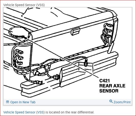

Okay, great. The PCM will flash the overdrive light and prevent the shift if it does not get a signal from the speed sensors, output speed sensor, or the overdrive drum speed sensor.
These are not the only causes of this but this makes the most sense.
I believe this vehicle only has one speed sensor in the rear differential.
Basically, what is happening is it is seeing a speed from these sensors except one (or more) of them and the speeds don't match so it flashes the light and doesn't allow top gear.
https://www.2carpros.com/articles/abs-wheel-speed-sensor-test

The ABS speed sensor? It also has one in top of the transmission but it is new. Do you think the neutral safety switch could be bad?
Tuesday, May 4th, 2021 AT 10:07 AM
CD OWENBY
  • 8 POSTS
I replaced the sensor on the rear end and still didn't help

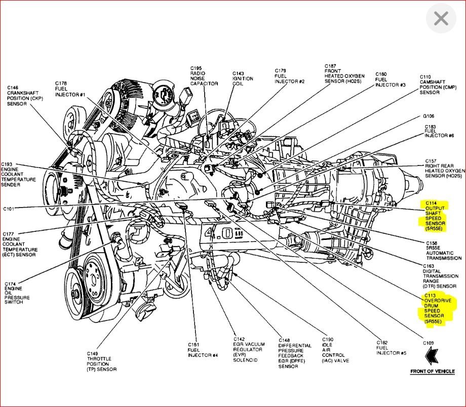

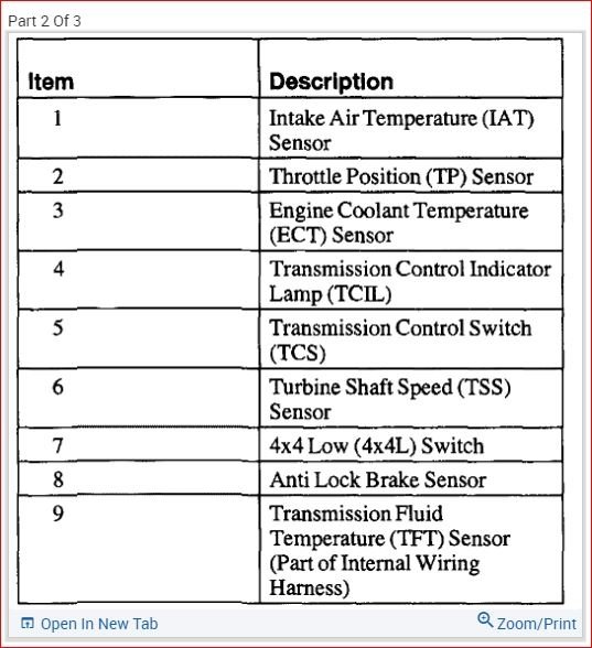

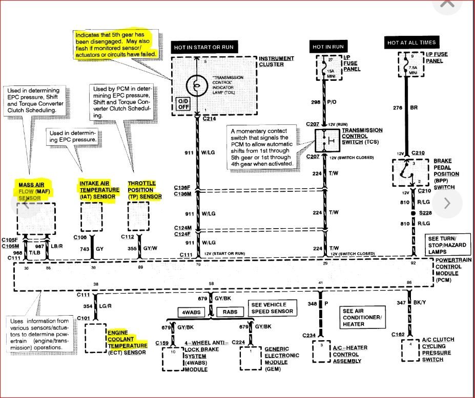

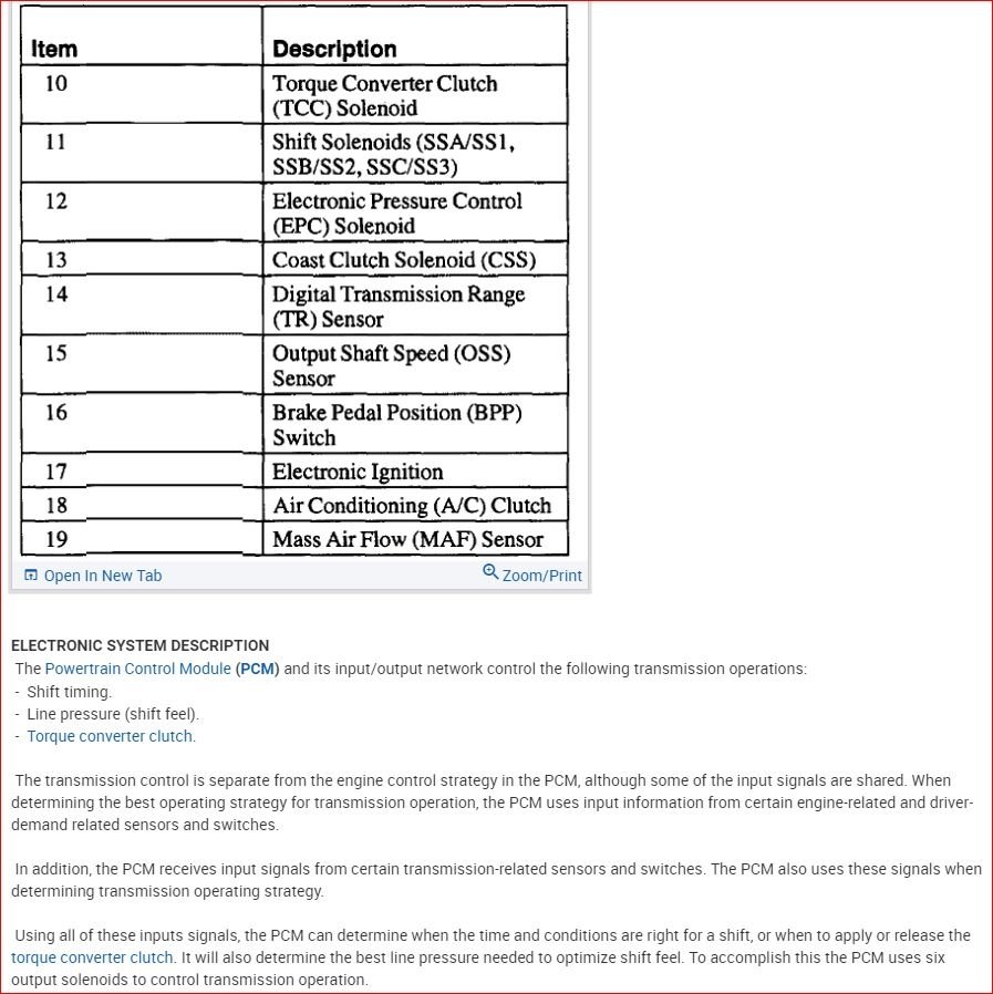

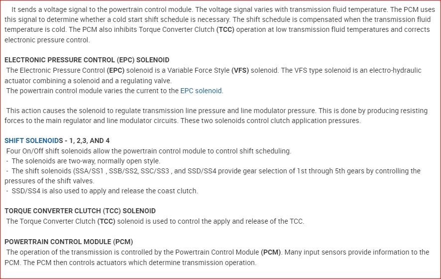

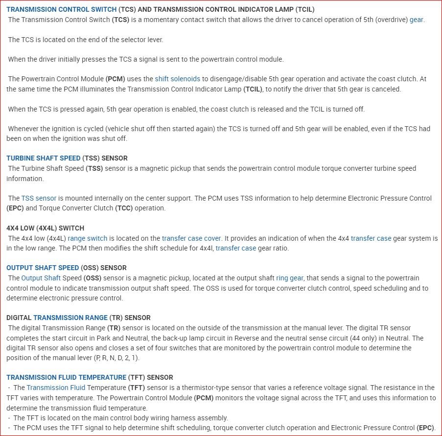

Okay. If you have a tool that will monitor your sensors in the PCM then we need to start looking at what the PCM is seeing. I suspect you have a sensor issue that you have not replaced yet or wiring to one of them.
If you look at the wiring diagram I attached, this is from Ford and it states on it that the overdrive light will flash if a sensor/actuator or circuit has failed.
I highlighted the sensors that you need to look at and write down what they are reading when the engine is hot. Then monitor your speed sensors that I mentioned above while driving and see if they match the speed you are driving. You may need someone else to drive for you for this part so you can monitor them and write them down or video them while you are driving.
If nothing stands out, send me the results and we can go through them together.
Based on everything you have done, I suspect you have a wiring issue with one of these sensors, so the PCM is not getting a good signal and disengages overdrive. Using the scan tool is easier then checking each of these wires for short to power/ground and checking resistance.
