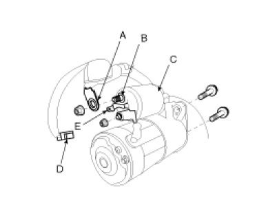

That sounds like one of two things. First, corroded or loose battery terminals or the starter itself. Here is what I need you to do. First, check the battery terminals. Follow this link.
If everything is good and you are sure the battery is good, then we need to check the starter. Follow this link.
When checking the starter, you will check for power to the smaller wire on the starter to see if it gets power when the key is in the start position. You will need a helper to do this.
If it gets power and the main (larger) wire to the starter from the battery is good, replace the starter.
If you find the starter is the issue, here are the directions. The attached picture correlates with these directions. Make sure before starting to remove it that you disconnect the negative battery terminal so power can't get to the starter.

REPAIR PROCEDURES
Removal
Starter
1. Disconnect the battery negative cable.
2. Disconnect the starter cable (A) from the B terminal (B) on the solenoid (C), then disconnect the connector (D) from the S terminal (E).
Pic 1
3. Remove the 2 bolts holding the starter, then remove the starter.
Tightening torque :
49.0 - 63.7N.m (5.0 - 6.5kgf.m, 36.2 - 47.0lb-ft)
4. Installation is the reverse of removal.
5. Connect the battery negative cable to the battery.

I think it was a bit of corrosion right up under the battery terminals which is why I didn't see it. It wasn't a lot of corrosion but I guess that's all it took.I cleaned it up and it still wouldn't start last night.
I went out today and it started up without any problems. I'm guessing it still might've been a little wet.
I haven't driven it yet I just started it revved it up a bit and turned it off.
Hopefully everything is good and the problem is solved.
