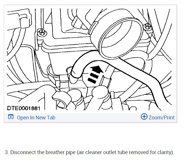

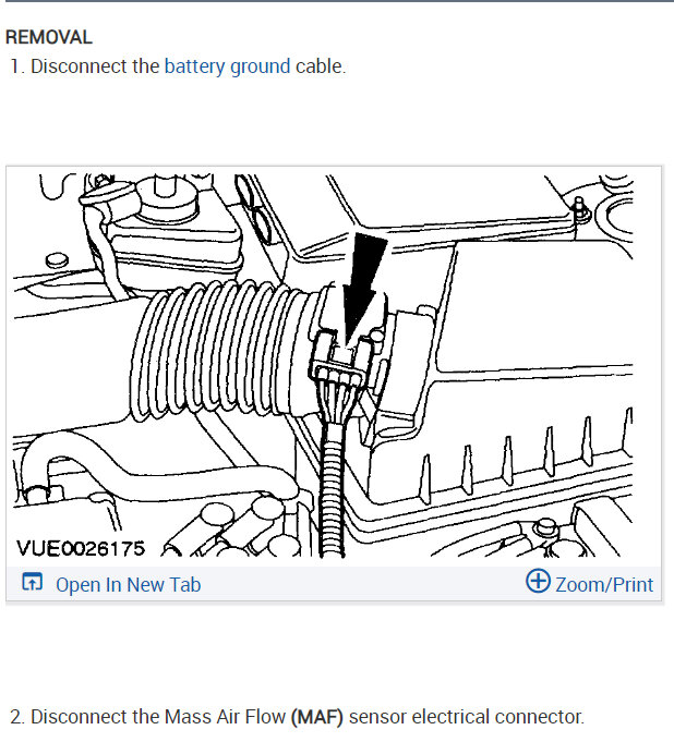

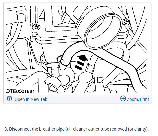

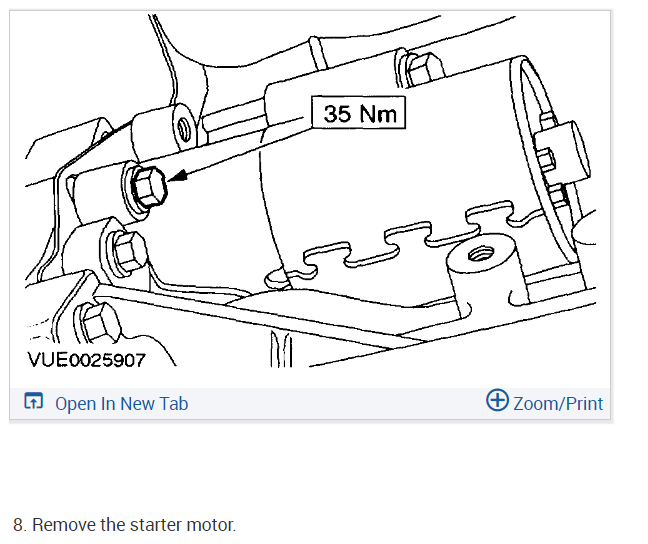

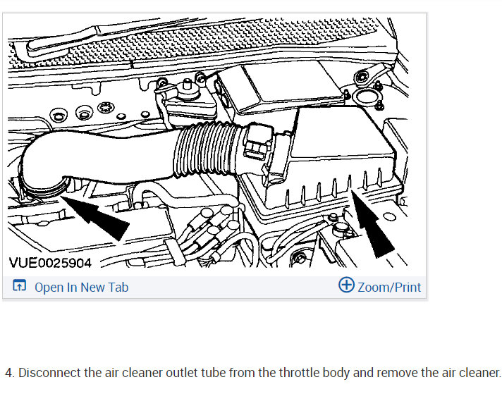

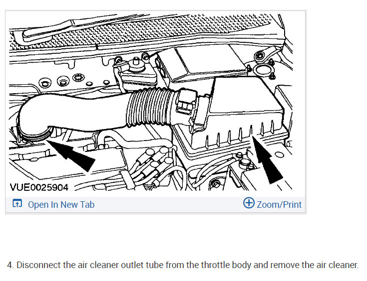

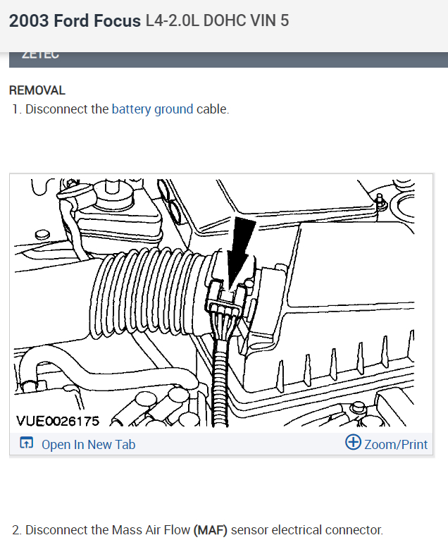

I have seen the MAF sensor cause this issue for the engine, but can I ask if the engine is cranking over or not? This might be two separate problems; can you upload a short video of the problem so I can see? Let's run the codes to see if any are stored which will help us fix it.
This guide can help:

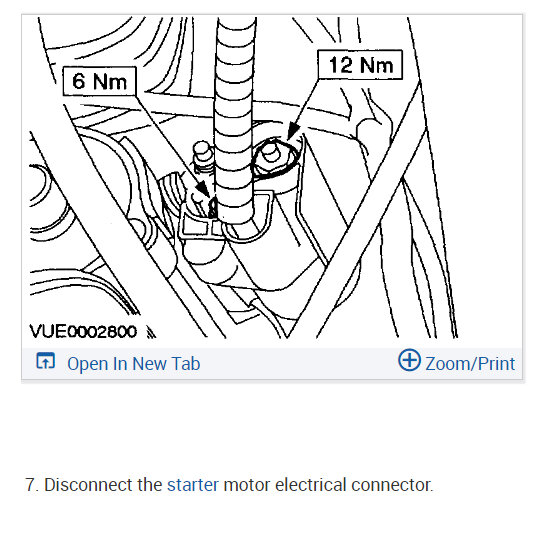

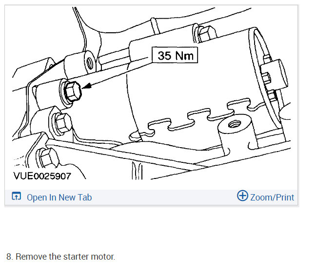

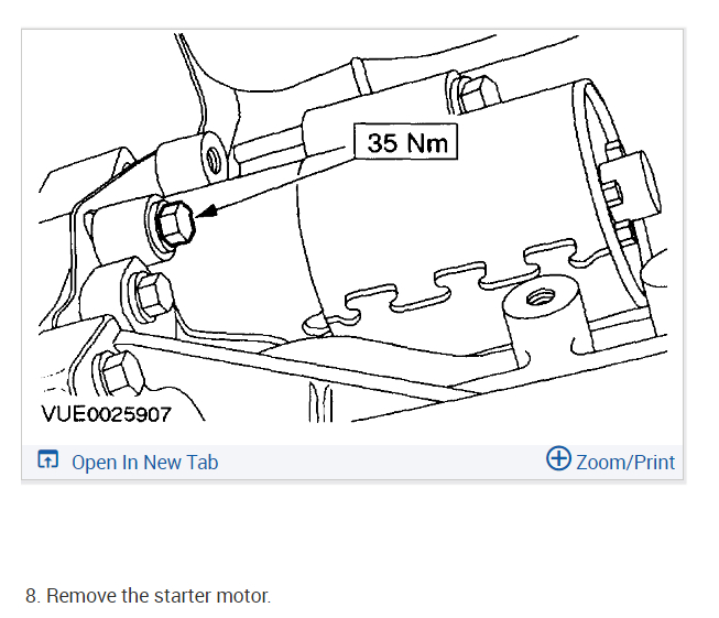

Here is how to change out the starter which you can see how to swap out the MAF sensor if a code is stored for it as well. Check out the images (below). Please let us know what happens.

Okay, try to unplug the MAF sensor to see if the engine starts, also we should check to see if it runs on starter fluid, if so, we know it is fuel related if not then let's use this video to check for spark:

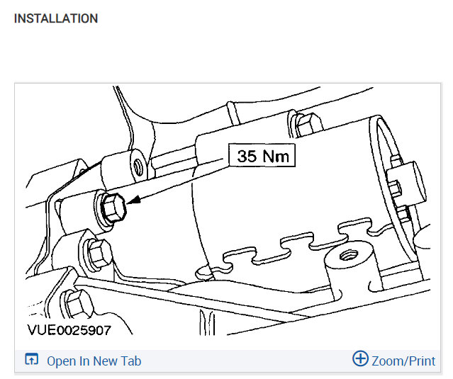

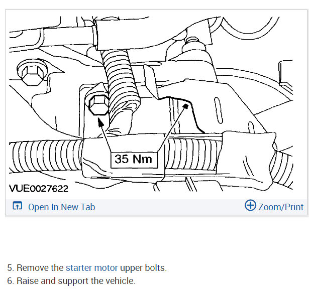

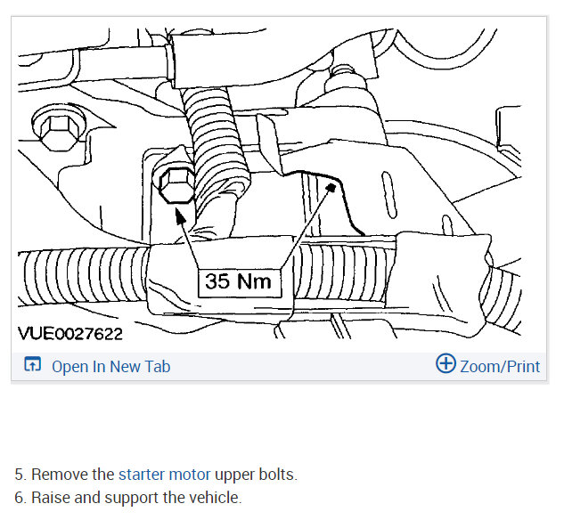

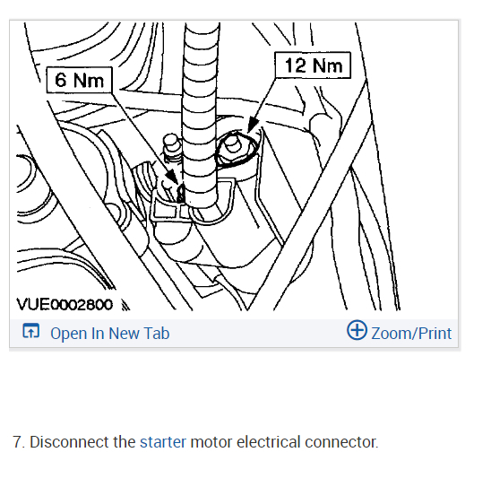

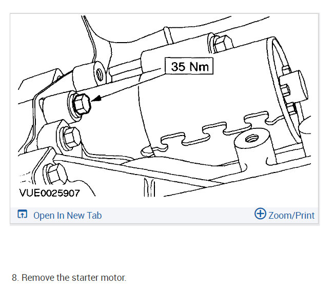

Gotcha, lets go over this guide to see if you are getting power to the trigger wire of th starter.
Here is how to change the starter out in case you need it. Also here is how to load test the battery.
Check out the images (below). Please upload pictures or videos in your response to the problem so we can see what's going on.
