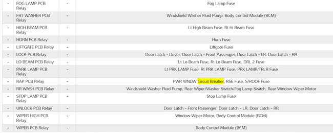

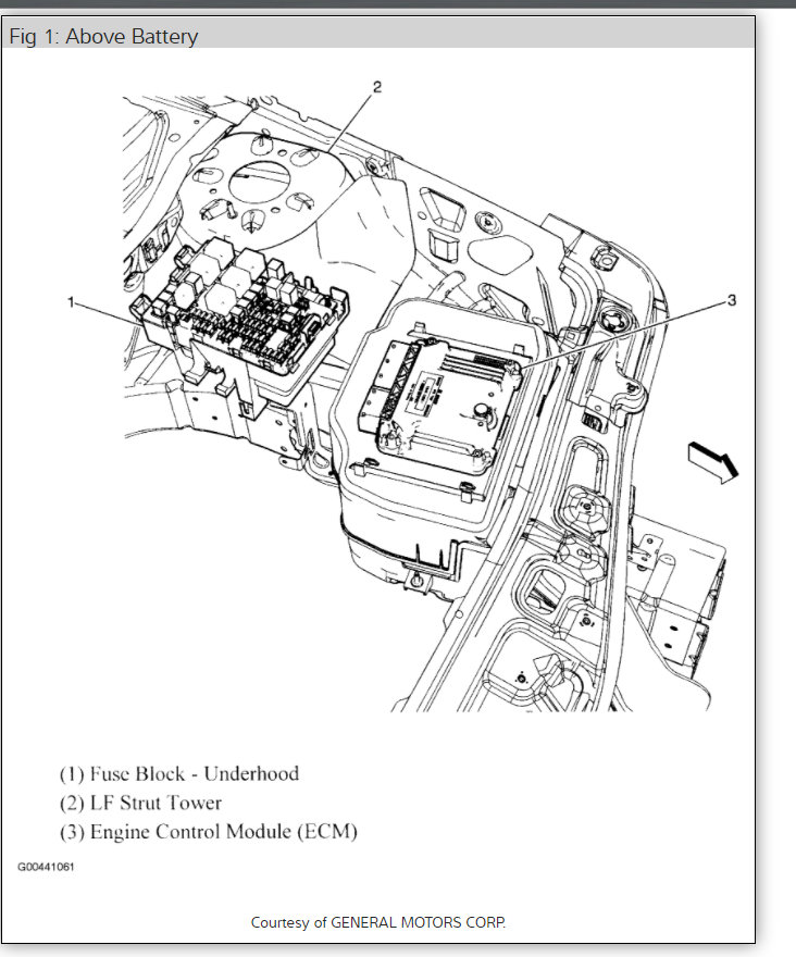

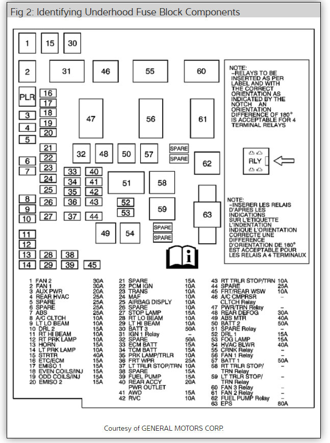

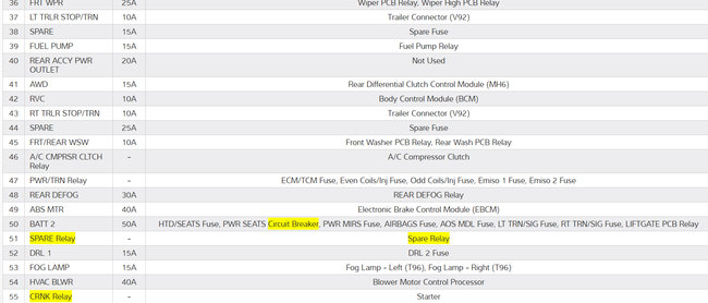

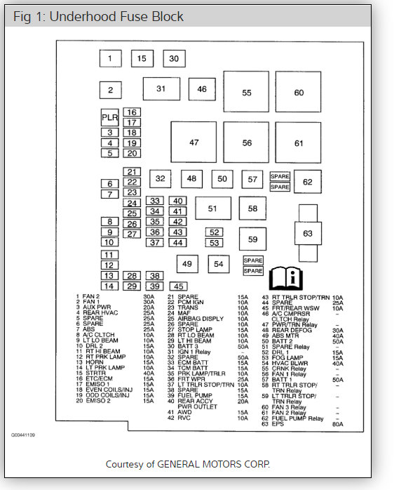

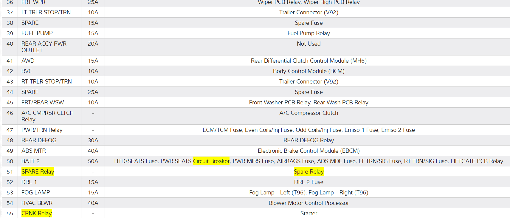

There is a powertrain relay #47 that needs to be checked. here is guide to help and the relay location in the diagrams below:

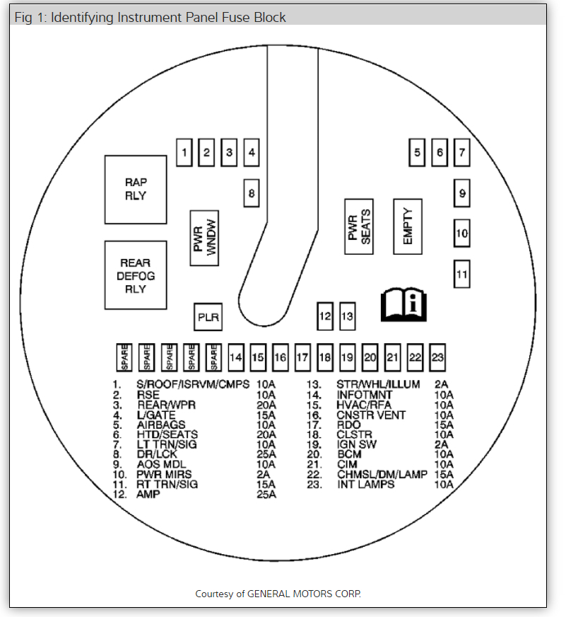

Good day Ken,
I have receive your advice but my Fuse box is different to the one you sent. now I can't find the relay you advance about. I have sent you how my fuse box looks like.
Dec 13, 2019 at 2:44 AM
RICHARD'S
  • 6 POSTS
I tried to send you a photo of how my fuse box looks like but your reply box doesn't give me the option to attach photos.
I am trying to locate the relay based on the diagram you sent me but I can't find it because the fuse box on the diagram is very different to my fuse box.
May you please double check the exact model written above on my first question and send me the diagram of the exact model so that I can be able to locate the relay.

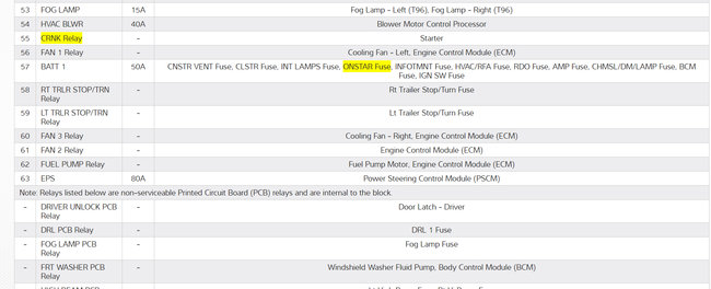

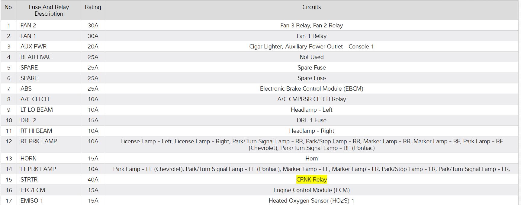

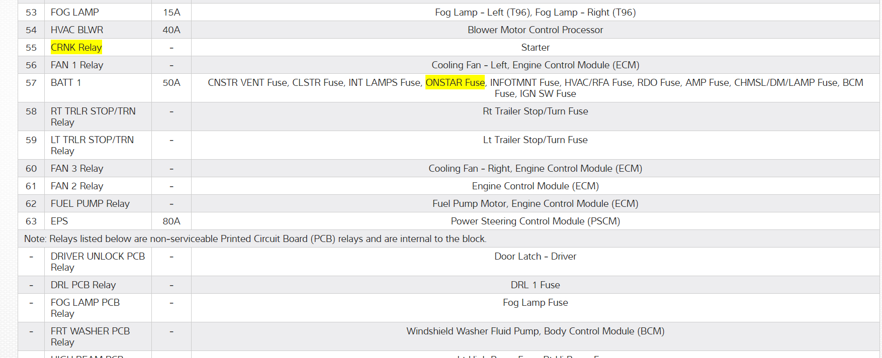

There should be a link below the text box that is for uploading pictures and videos do you see it? I found this for the engine control relay let me know.

I noticed I cannot reply to you via email, can you maybe provide a link where I can upload photos or an email where I can send photos please? My fuse box is very different to the diagrams I'm struggling to locate the relays that you mentioned.
The only relays I find namely: Main relay, starter relay, fan aux relay, fuel relay, fan main relay, fan control relay, horn relay, wiper speed relay, run relay, defrog relay, park LP relay, FRT fog relay, H/L LO relay, HL/HI relay, and H/L washer relay.
Could they be using a different name on my diagram maybe?

Hmm, what browser or phone are you using? The main relay would be the one to test.
