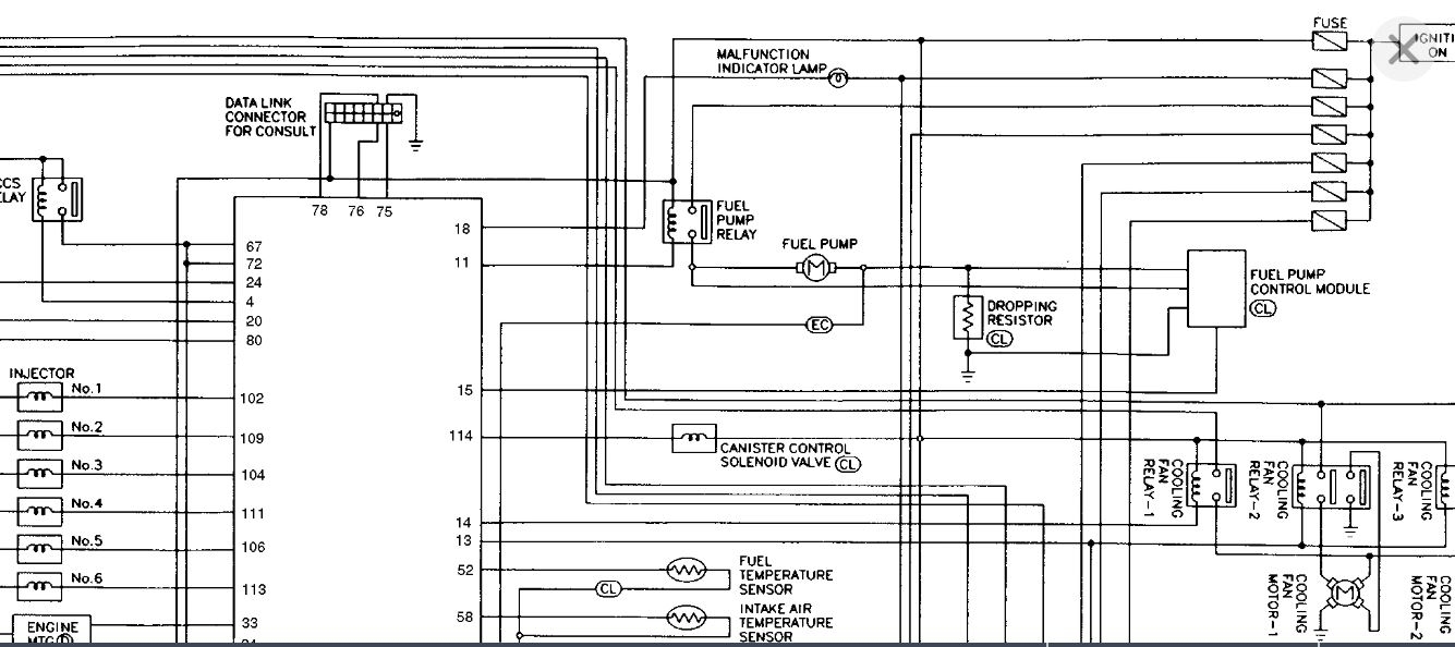

I am not getting power to my fuel pump. I have changed the pump. My gas gauge do not work and I just do not know what to do.

You need to use a test light or voltmeter and check for voltage at the fuel pump.
I attached a wire diagram the shows the fuel pump relay. You need to verify there are two powers to the relay with the key on. The ECM is what grounds the relay and sends power to the pump.
Start with checking the fuses first to be sure it is not something easy.
