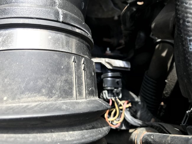

FISHER8967
  • 7 POSTS
This is the plug I’m talking about.
Wednesday, September 2nd, 2020 AT 12:55 PM
FISHER8967
  • 7 POSTS
Also, what sensor is it plugged into and where do the wires go to they are wrapped into the plastic protectors with others?

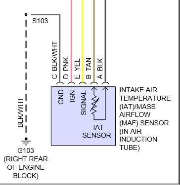

PATENTED_REPAIR_PRO
  • 1,853 POSTS
I believe that is this.

FISHER8967
  • 7 POSTS
Okay, got her started by putting zip tie on plug but might not be that. So if I throttle up to 3,000 rpm's and hold she will actually stumble to about 2,500 but back up. Then after a minute will stumble hard and shut off. Right now at idle it will stumble and almost cut off. Any ideas?

PATENTED_REPAIR_PRO
  • 1,853 POSTS
If half of that is a mass air flow sensor, that cannot be simply zip tied, you will have to secure it.
