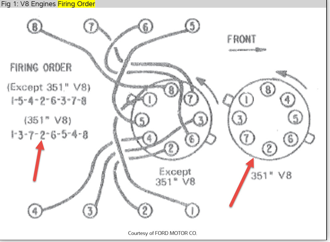

Hello and thanks for reading this.
I have a 1969 Mustang 351w 4 valve. I recently experienced stalling and shutting down at a stop sign. When car cooled it started and ran for another mile (thankfully to my driveway) then stalled and shut down again. I allowed it to cool and visually inspected everything with no faults found. I was able to start it one more time from cold and it ran only long enough to get in the garage. It has not started since.

Car now has new plugs, new electronic Accel points eliminator in the distributed, new dist cap, new voltage regulator, new starter solenoid, new coil, new 4 barrel carb. Vacuum actuated secondaries.
After the distributor work I set top dead center. I tested the depth of cylinder #1 with a screwdriver to see if the piston was up in the compression stroke. About an inch deep so I assume it was. I tripple checked the firing order of the plug wires and set the dist so the new rotor faced where #1 had previously been to ensure timing would be good enough to start and replaced the cap.
Car won't start. Am I missing something electrical? Does fuel at the carb not always mean it's getting fuel? After spark, fuel, and generally confident about timing I am lost. Thanks for any help you can give!

Ya when you pulled the dist it's probably in wrong. Is old carb on or new one? There should be an idle adjustment on it which I don't have a pic of so can't tell you how to adjust it. Put #1 which is on the passenger side on that engine and make sure your timing mark is sitting around 0 then check where your rotor is lying in dist. Recheck your electrical hookup for your new electronic ignition and make sure it has a gap if it' s supposed to 351's fire different then rest of ford V8 see pic arrows point out correct way.

Thank you for responding! I did make sure the firing order was correct for the 351. It's what your picture shows for it, not the other ford v8s. So that's good.
The new carb is on. Still with factory settings because I haven't been able to start the engine to see if adjustments are necessary. But I know a factory built Holley is usually good enough right from go with no or very minor adjustment so I don't believe it's causing the no start now.
When I put the dist back in it would not go in the way it came out so I set top dead center and fortunately the new electronic ignition allowed me to put the rotor on any way I want so I set it at the #1 despite the dist shaft being 45 degrees off of where it had been originally. I assumed this was fine based on other posts I read.
I only have one timing mark. A line with no numbers. I set it to match up with the triangular metal flange. Is that top dead center? Or should I ensure the line is actually facing directly up on the highest point. It would be maybe 10 or 20 degrees off of the metal flange.

There shold be a line on the timing chain cover and one on balancer those should line up pretty close I still think this is out of time if everything else is correct. Put a rag on your finger and pull #1 plug crank engine over til you feel the compression coming up then see where your marks are if lining up that should be tdc. The rotor can only go on one way not a couple ways as there is a notch in dist shaft and plastic on rotor on inside that will only line up with it. Once cap is on see if spark comes from coil then to any plug wire if not the rotor is bad or dist cap. Ford coils used to crack around tower as well as dist caps but try the other stuff first.

Thanks HMAC300. I double checked top dead center. It's good. The new electronic ignition has no notch on the rotor. So I was able to put it on facing #1 regardless of where the dist shaft notch was facing. I assume as long as the rotar faces the right cylinder it doesn't matter where the notch is. Still no start.

Thanks again HMAC300. Turned out the electronic ignition rotor button was rubbing top of dist cap. Caused it to stick and of course timing can't be right with that.
So now the new problem, or maybe the same old one. I was so frustrated I bought a new OE distributor. Back to points and condenser. Took forever to install in a way I could set the timing right because it wanted to go in any way the vacuum assembly wouldn't allow any adjustment. Got it only one notch off where the origonal was and once in I set top dead center again on harmonic balancer and then went 6 degrees before TDC. My chiltons manual shows the timing should be "6B". I assume this is 6 degrees before TDC. Then I turned the dist so the rotor button faced #1. Again I verified I was on the compression stroke so I wouldn't be 180 degrees out. I understand compression stroke to be piston at top of cylinder. Am I completely wrong?

Backfires are out of time on these. Try resetting again if dist won't go inright take a 5/16" socket and turn oil pump drive and change oil as well. Crank motor over with plugs out if you have that much fuel.I still think the timing is off causing your no start. Hope you changed dist cap after rotor hitting it as well. Everything you are saying seems you are doing correct though

HMAC300. Thanks again. I had to focus on other things for quite a while. I fixed the problem and it's running great. I misunderstood TDC compression stroke. Dumb mistake that taught me a lot about everything else. It was worth it. Lol.
