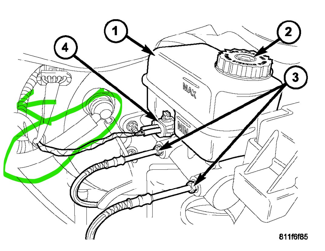

Is the brake booster the hose on top if the air intake housing?
Wednesday, December 28th, 2022 AT 11:44 AM
AL514
  • 5,584 POSTS

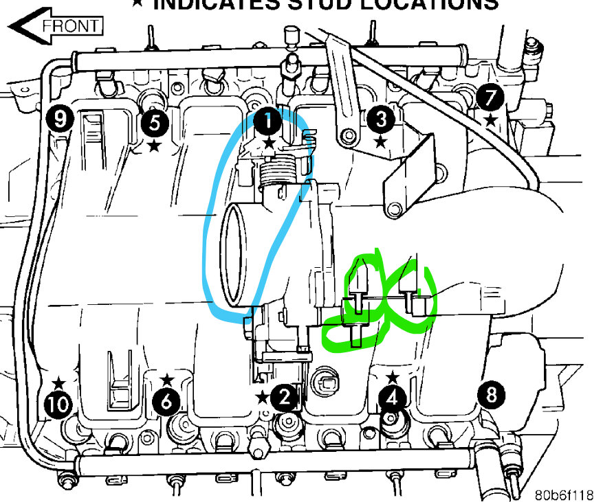

The Brake Booster hose runs to the Brake Booster that the Brake Master Cylinder is attached to. Below is a diagram of the Brake Master Cylinder. The Hose circled in green, follow that to where it attaches to the Intake manifold, and pull it off, spray into there and put the hose back on then try to start it. That way you're getting the starting fluid directly into the Intake valves of the cylinders. Spraying into the air intake hose is not close enough. Or you can take one of the hoses off near the throttle plates, I added a diagram of the Intake manifold. In blue is the throttle plates (throttle body), in green are some of the inlets for different hoses, whatever is easier to get to. That way you get the starting fluid behind the throttle plates and into the intake manifold.
If it still doesn't start, check for spark at one of the ignition coils by following the guide above.

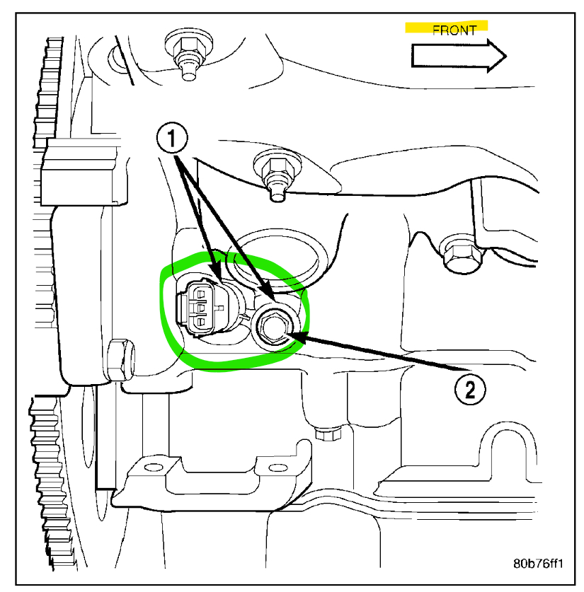

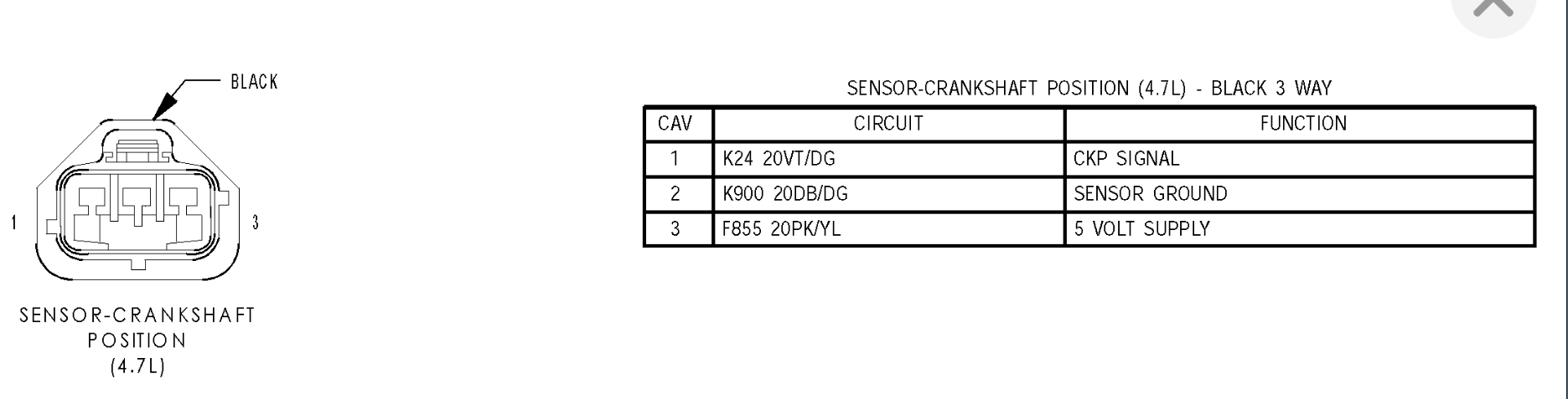

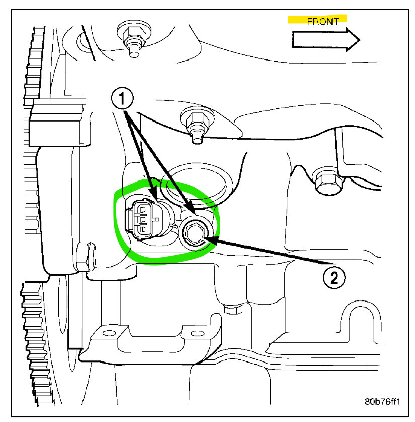

Is it turning over very fast, faster than normal? Can you record a video and post it here please? With no Tachometer movement, which means the engine computer is not seeing an rpm signal, does the check engine light come on while cranking as well? Check for spark if you are able. I suspect there will be no spark.

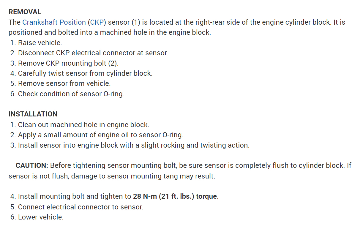

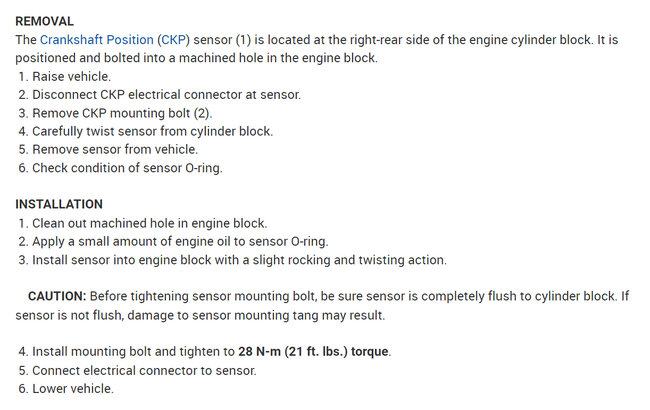

If it is cranking over at its normal speed, then it sounds like you may have had a crankshaft position sensor failure. If it is cranking over extremely fast, much faster than normal, I would suspect a timing chain issue. But due to the cold the crank sensor may have failed. The Tach signal comes from the crankshaft sensor signal to the engine computer, without it you will have no spark and potentially no fuel injector pulse. I will post the location of the sensor for you. These are in the side of the engine block.
The sensor is located on the passenger side of the engine block to the rear. It has a 3 wire connector. It is always a good idea to check to see if there is a voltage feed to the sensor and a good ground. This sensor uses a 5volt Reference feed which is a pink wire with a yellow stripe. The Ground for the sensor is a dark blue wire with a dark green stripe. With the sensor unplugged and using a multimeter you can check across these 2 pins by lightly touching the connector pins with the multimeter leads. With the key in just the On position it should read 5 volts, this is with a basic multimeter set on 20vDC. If you have a video or any questions before testing or replacing the sensor, please just ask.
https://www.2carpros.com/articles/how-a-crank-shaft-angle-sensor-works

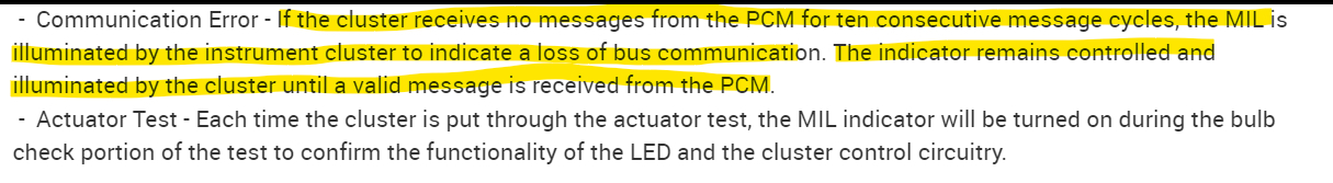

Changed the sensor. Tachometer moves a little bit. Still no start. Coughed slightly. Check Engine flashes 10 times then stays solid. No code showing.
Thursday, January 5th, 2023 AT 1:14 PM
AL514
  • 5,584 POSTS
Did you check for spark? I'll have to look up what the flashing check engine light is all about with no codes. Usually, a flashing check engine light means a catalytic converter damaging misfire, but with a no start is odd. Is the engine turning over faster than normal? You're not getting any no communication messages or no bus messages, are you?

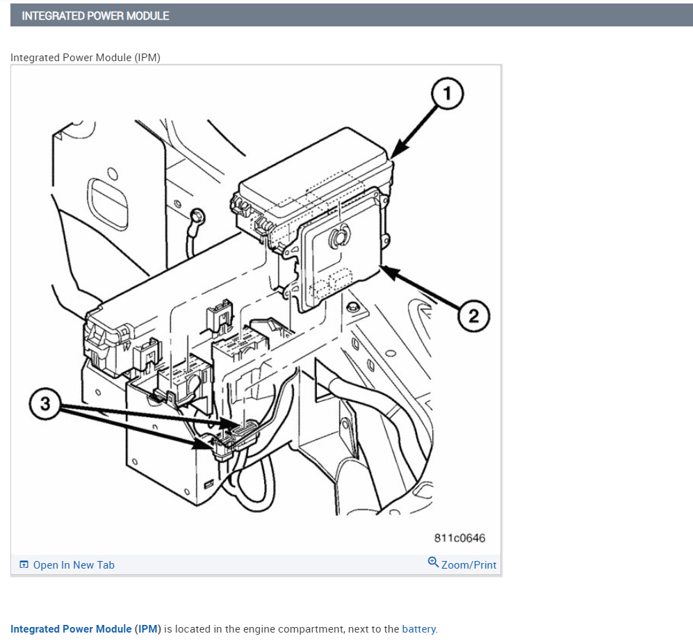

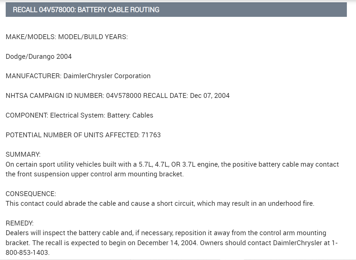

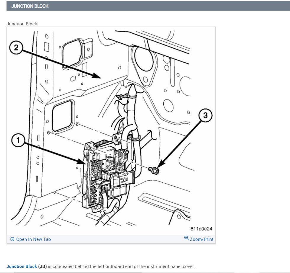

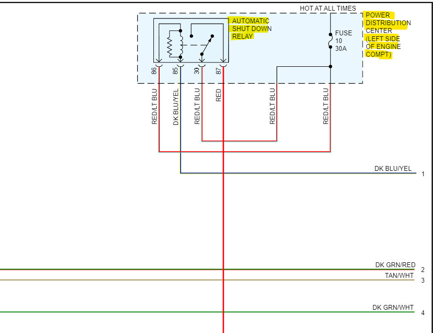

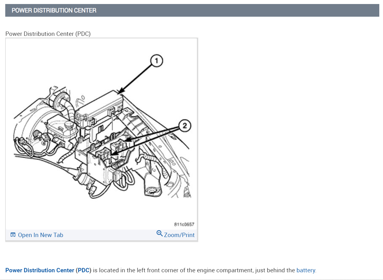

There is also a Recall on the Battery cable routing. Have you checked all the fuses for any that are open, by a possible short to ground due to this issue. Check all the fuses in the entire vehicle. I'll find all the fuse panel locations. Check these fuse panels for any corrosion, check the connectors and fuse locations. especially the fuse panel on the driver side lower dash. These locations are sometimes exposed to water intrusion.

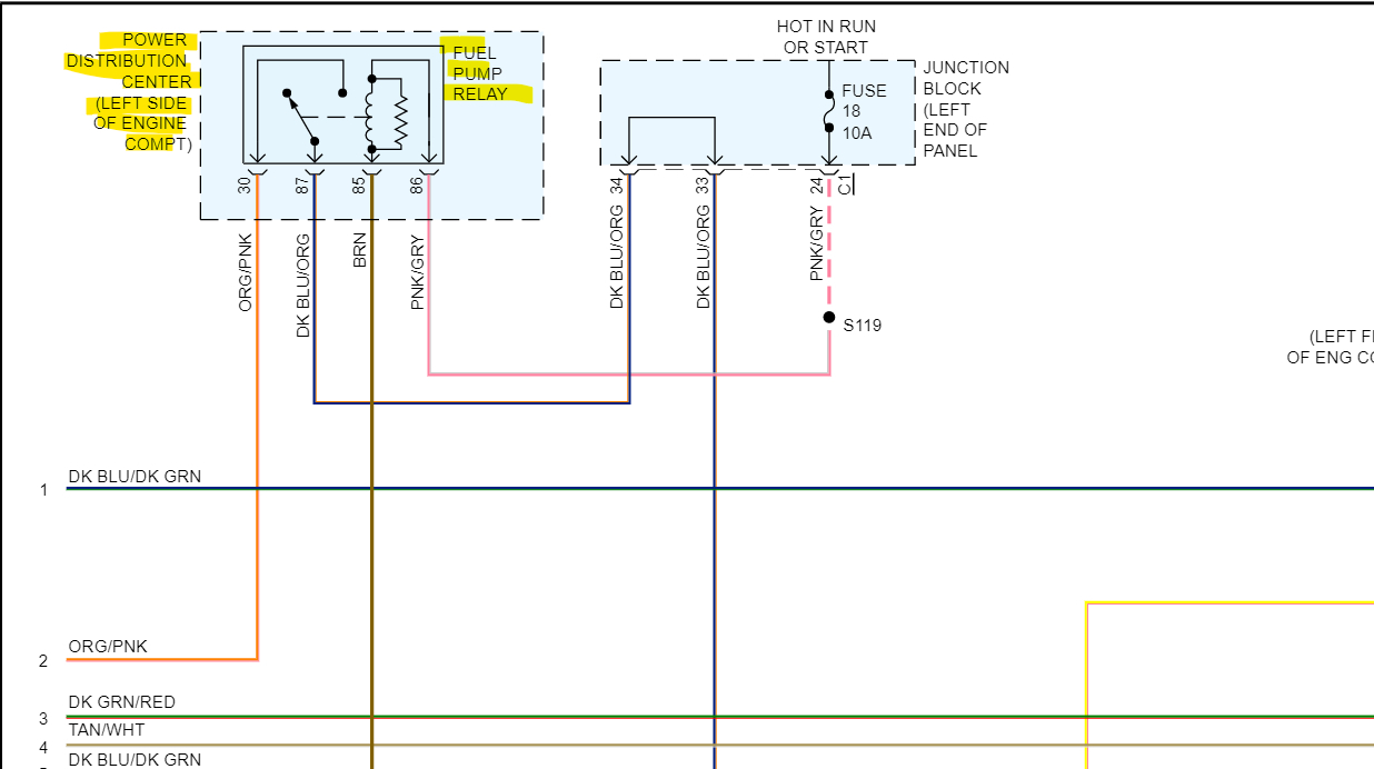

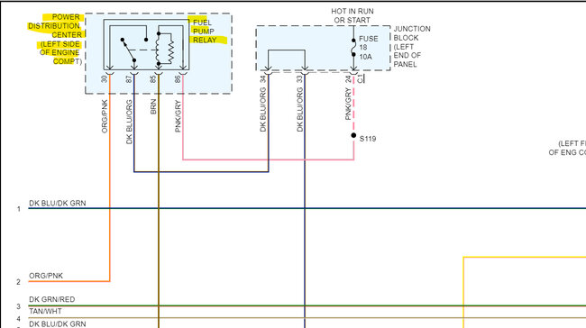

Also pull out the ASD Relay and the Fuel Pump relay and check for corrosion inside the female pins where these 2 relays sit. The underside of these fuse panels is known for corrosion issues from normal exposure to the elements.
