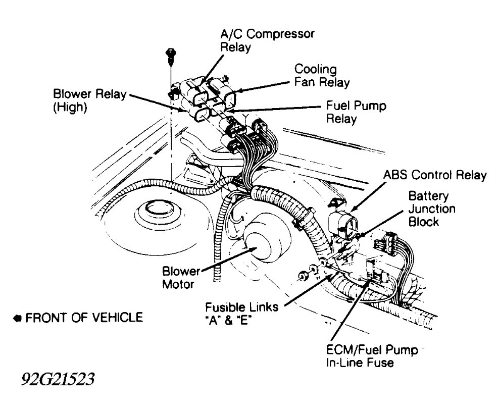

Hey Chyanne,
Here is the fuel pump relay location.
Let me know how it goes,
Best, Ken
