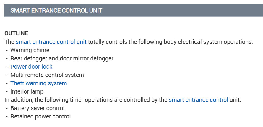

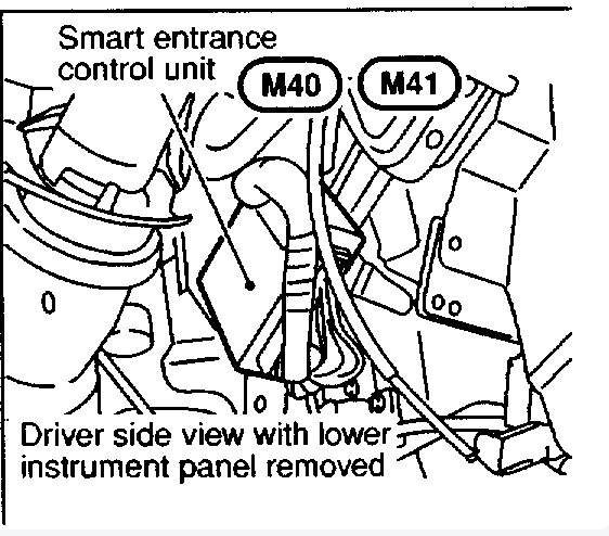

Where's Body Control Module of this vehicle located?
I brought another immobilizer and plugged it and I wanted to initialize it and it was saying "initialization failed" then I put back the old immobilizer and it was not recognize again by the control unit i.E the security indicator was no longer blinking or coming on when you turn ignition but if you put the new one, it will blink and if you turn ignition on, it will be steady. For this reason I want to change the BCM.
Wednesday, December 7th, 2022 AT 7:16 PM
  • 110,194 POSTS
I believe they call it a Smart Entrance Module or controller. It is under the center of the dash. If you look at pic 1, it shows the items it controls and pic 2 shows the location.
If you are trying to look up the body control module, you won't find it on this vehicle.
Let me know if this helps.
