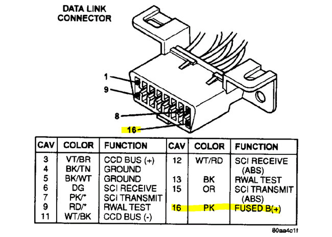

No spark no power to OBD
RICH ZELTER
  • 1996 DODGE RAM
  • 5.1L
  • V8
  • 2WD
  • 90,000 MILES

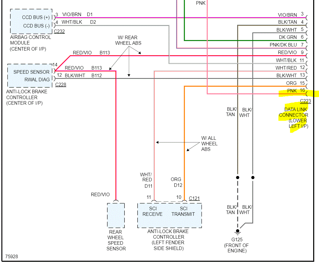

I can't figure out if it's a fuse or what's going on. What fuse powers the OBD?
Tuesday, April 5th, 2022 AT 11:32 AM
17 Replies
  • 110,192 POSTS

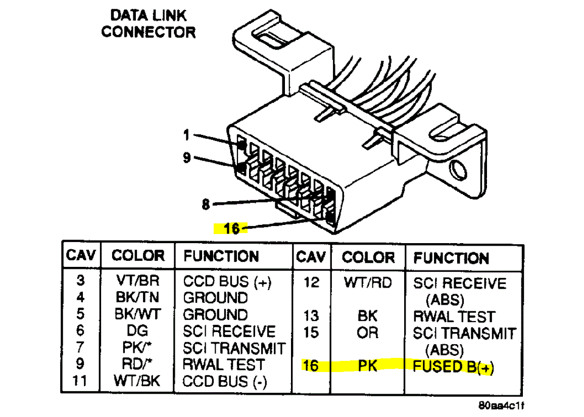

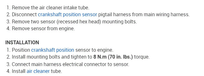

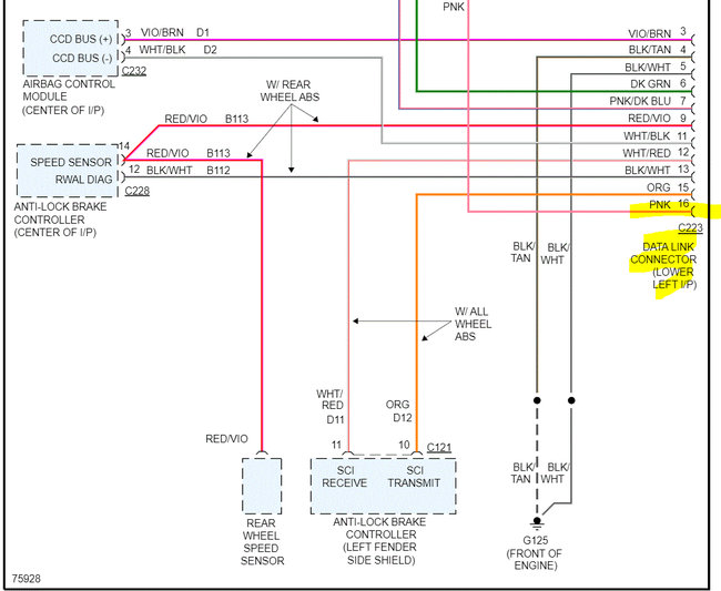

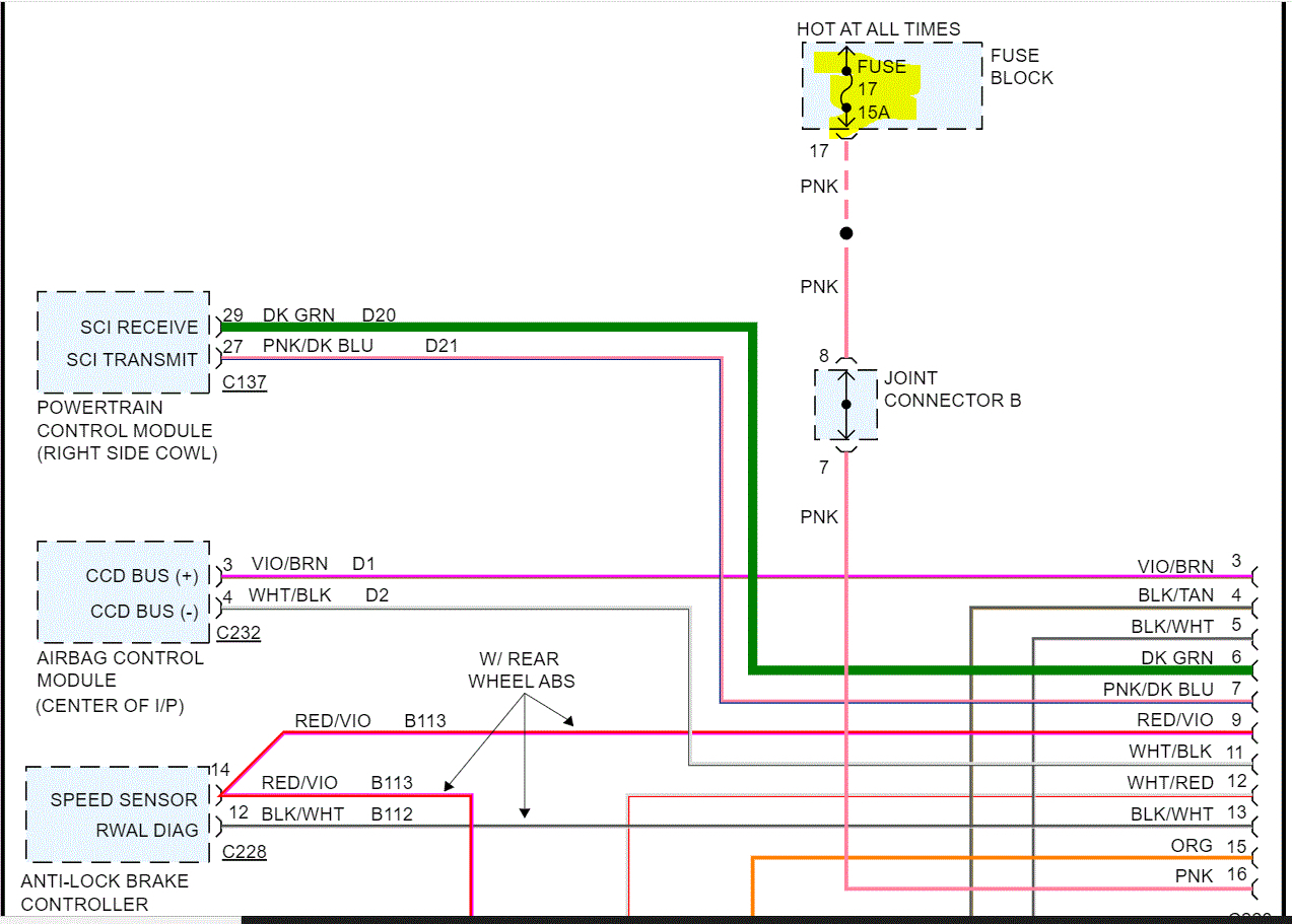

There is a fuse for the data link connector, fuse 17. I attached a pic below of the wiring schematic related to the DLC. Pin 16 at the connector (pic 3) shows the pinout of the connector.
Check to see if there is power to pin 16 first. If there isn't, then check the fuse.

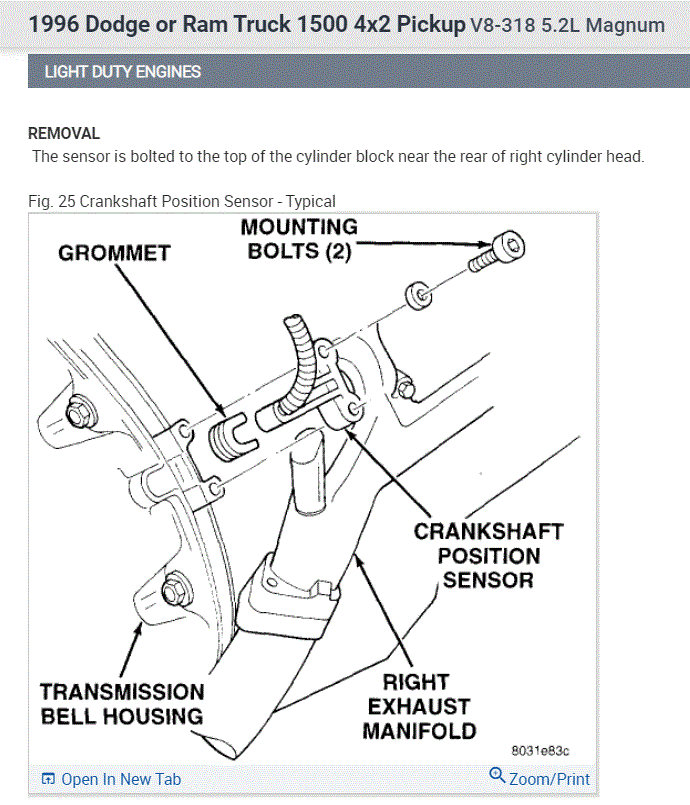

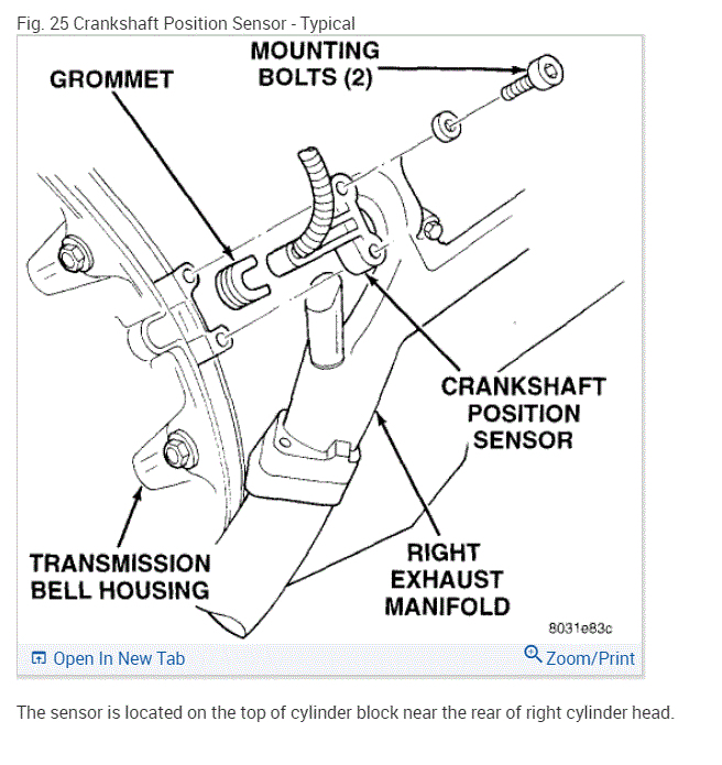

As far as the no spark, in most cases, it is caused by a faulty crankshaft position sensor. Take a look through this link and let me know if it mirrors what you experience:

Thanks, I had already figured out fuse 17 was bad so the OBD is working but it's not throwing any codes at all. When I go to live data it is showing RPMs sometimes.

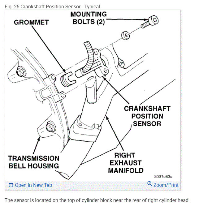

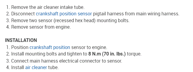

Replace the crankshaft position sensor. If you don't have a solid RPM signal, that is the likely cause.
If you look at the pics below, they provide the location and directions for replacement. When removing it, soak it down with penetrating fluid first. Allow it to sit for a bit and then be careful not to break it off when removing it.

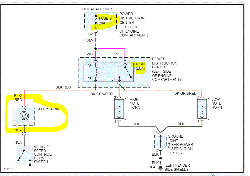

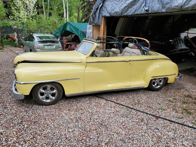

Thanks, I'll do that though I just had a shoulder replacement I'm not sure I can get in there. Is it possible there is a fuse involved or relay involved that might be easier to check? The whole drivetrain is in a 1947 DeSoto now but everything is there, and it's been good for 14 years started one day went to started two days later didn't do it. The horn is not working, the indicators are not working, and they always did. Is it a way I pay you for this help once we get things done?

Complete wiring harness came over from the truck some things are not being used like the HVAC the gauges and other assorted door lights and things. But headlights blinkers flashers and horn have always worked. I've had the car for 14 years I've never driven it much just around the block in and out of the garage and the thing. All the work was done by a professional mechanic friend of mine who did everything right at the time I believe.

If the crankshaft position sensor is bad, it may or may not set a code. A crankshaft position sensor's function is related to engine speed. As a result, failure may not trigger the Check Engine Light. This is because there are some things that can stop the crankshaft position sensor's signal that will have nothing to do with the sensor going bad such as running out of gas.

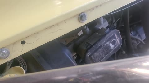

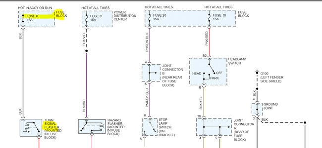

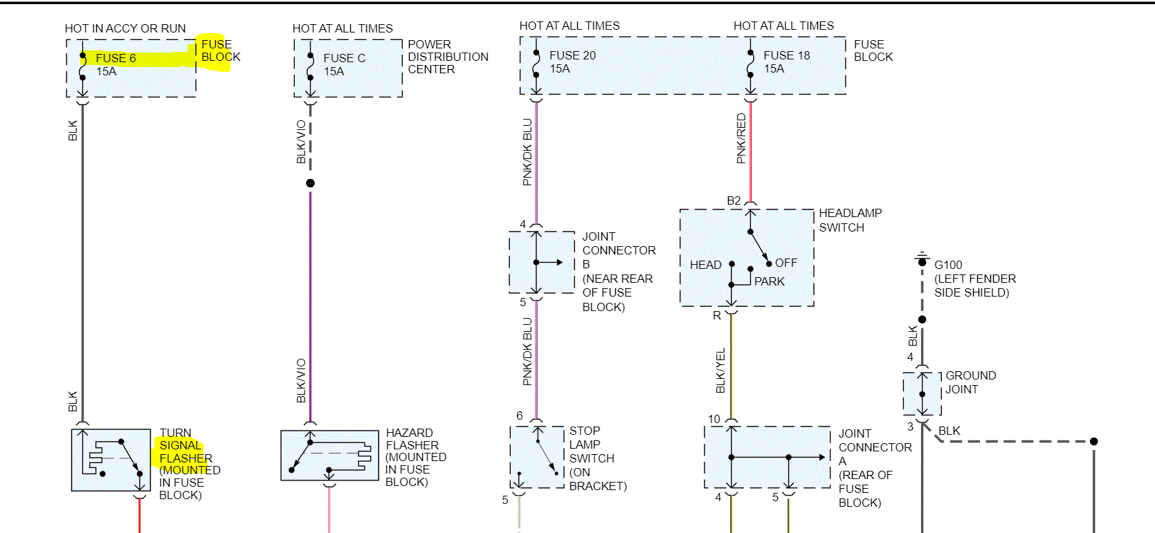

I hope that makes sense. As far as the horn and flashers are concerned, I attached two pics below showing the power supply (fuse). One is under the hood, and one is in the vehicle.
I circled the clock spring. If that failed it can be causing issues with the horn/signals, but the airbag light should also be on. Let me know.

I just got to ignite for a couple of seconds don't know if that tells me anything.
Thursday, April 7th, 2022 AT 12:28 PM
  • 110,192 POSTS
Rich,
That goes back to the crankshaft position sensor not giving a solid signal. That is my first suspect. I've been wrong in the past and will again, but that is what I would replace.

Turned out to be one of the relays in the power control box in the engine compartment. That was easy. Thanks for your help.
