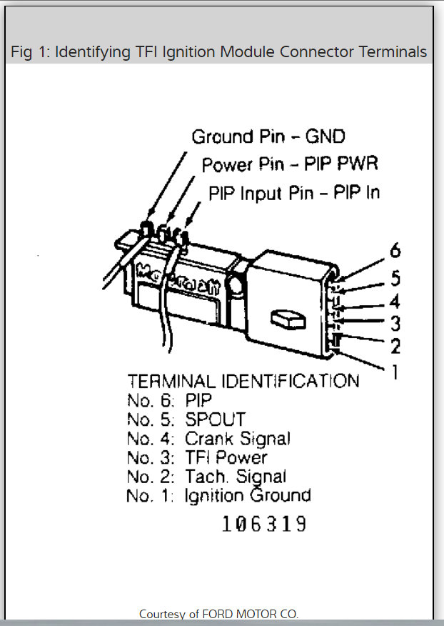

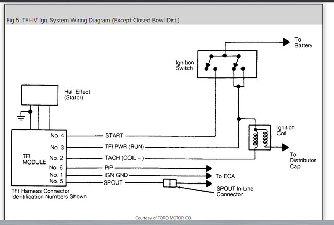

I've performed all of those diagnostic tests. Once before I replaced the pickup coil, ICM, and coil with new Motorcraft parts. Then, I did them again last night after it shut off again. Still no signal to coil, spout or no spout. Today, a friend of mine let me borrow his distributor. Same result. Started and ran, then after about fifteen minutes, it shut off. No signal to coil. Put the distributor back on his truck and it started right up. I replaced the PCM a year ago with a rebuilt one. I'm leaning towards it.
Wednesday, October 14th, 2020 AT 2:06 PM (Merged)
SCGRANTURISMO
  • 4,897 POSTS
Hello again,
Okay, Can I get you to check the wire coming from the #1 cavity on the TFI Ignition Module Connector. Please run this wire back and check to make sure it has a good tight connection, and it is not damaged and there is no corrosion present anywhere. I have included a diagram of the connector and component locations in the diagrams below. Please get back to us with what you find out.

BIGJOHN610
  • 5 POSTS
Okay, I will.

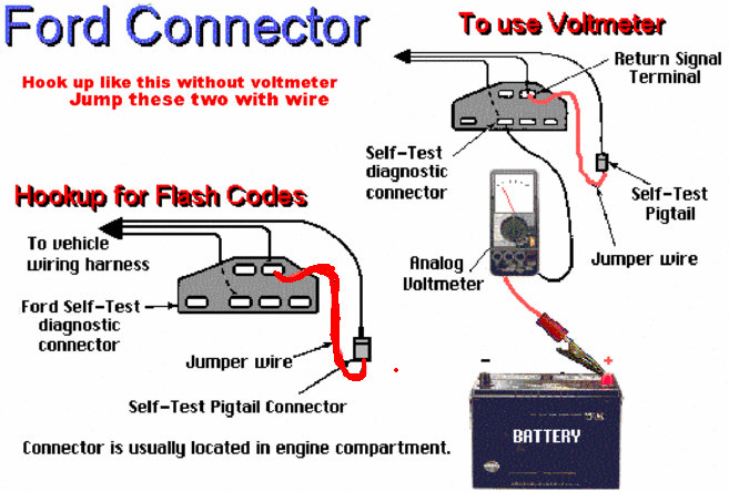

OBXAUTOMEDIC
  • 3,711 POSTS
OK, first thing I would look at is the Distributor Cap & Rotor, when was last time replaced. Look inside is there corrosion in the contacts if so would replace along with rotor. While there if can have someone turn engine over and watch to see if rotor spins, if doesn't then most likely will need new distributor.
Other possibilities -
If Check Engine Light is On
TPS - Throttle Position Sensor
IABV or IAC - Idle Air Bypass Valve or Idle Air Control Valve
The engine needs to be at normal operating temperature for testing.
The self test connector is on the drivers side inner fender well. Check Pic for shape of connector. Then hook up a jumper wire as shown in the diagram below. Turn your key forward to the RUN position (KOEO, key on, engine off), and after a few seconds the codes will begin to flash through Engine Light or if you have hooked up a voltmeter, the needle on the voltmeter will indicate the digits of the trouble codes in sweeps of the needle. Record all codes and identify them as KOEO codes.
Code will be shown in blinks of the light or sweeps of the needle.
Example:
2 digit Codes
1 fast flash, with 2 sec pause, then 2 fast flashes is code 12
2 fast flashes, with two sec pause, then 3 quick flashes is code 23.
3 digit codes
1 fast flashe, 2 sec pause, 3 fast flashes, 2 sec pause, then 2 fast flashes is code 132
If there are more there will be a 4 second pause before the next code starts.
After the KOEO codes finish. Continuous codes follow after a 6 to 9 second pause, a fast flash, and another 6 to 9 second pause. Write these codes as continuous codes. Then remove key and the jumper wire.
You won't be able to perform Key On Engine Running test(KOER) at this time.

BIGJOHN610
  • 5 POSTS
Ok. The ground is good all the way back to the ecm. I checked all the connections on all 6 wires and continuity tested. I checked the ignition suppression resistor, 21.9k ohms. All of this I did before starting the engine and after it died and went into a no start condition. Had a coil signal before it started. No coil signal after it died.

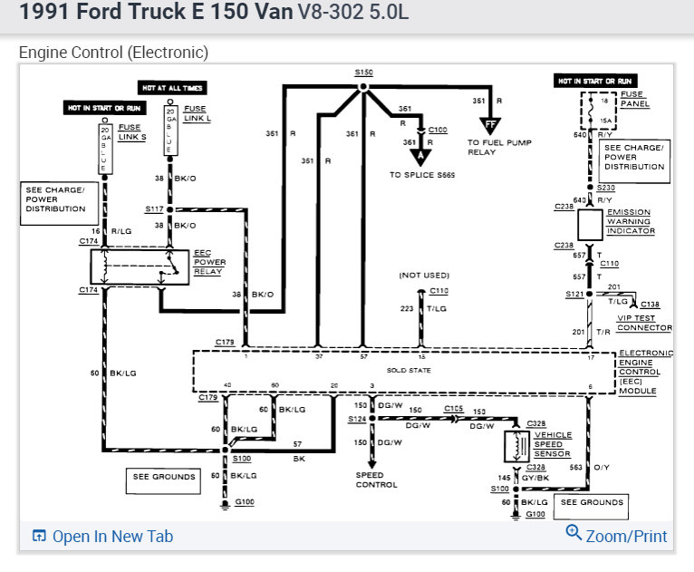

KEN L
  • MASTER CERTIFIED MECHANIC
  • 55,291 POSTS

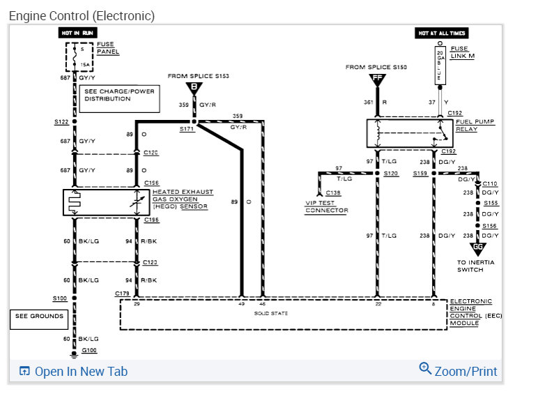

It sounds like the PCM went out, but to be sure let's check the wiring between the ECM and distributor. Here is a guide and the ignition system wiring diagrams. Also check the ECC relay.
and
