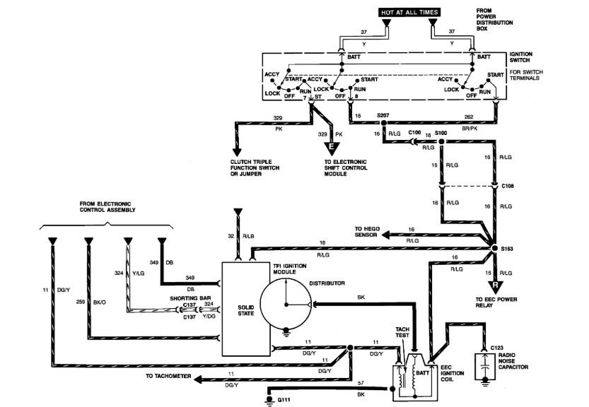

no spark?
1991 FORD RANGER
88,000 MILES • 2.0L • 4 CYL • 2WD • MANUAL
  • CAR REPAIR CONTRIBUTOR
That comes off the negative side of the coil. With the key on, that should be battery voltage as well. If it does not, it could be a bad coil or the module is grounding the wire.

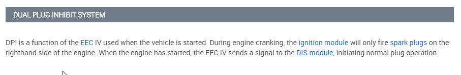

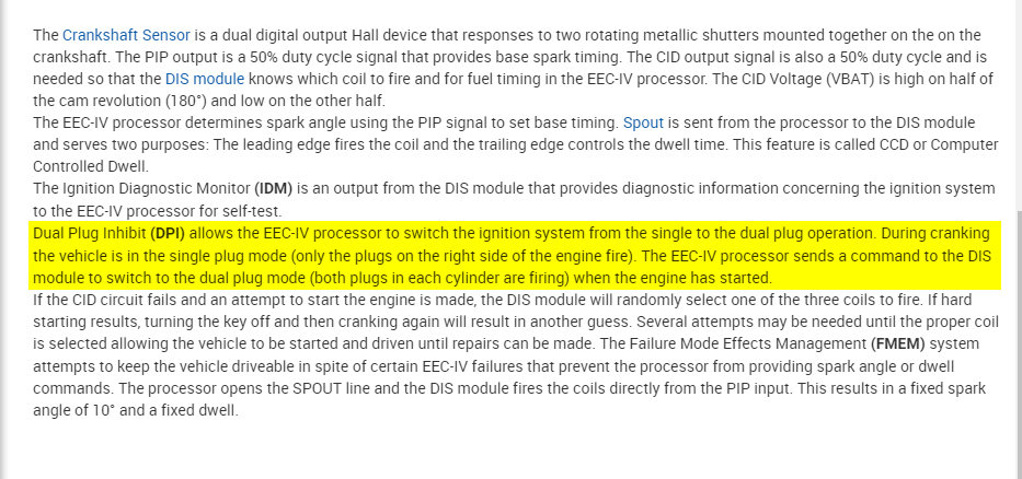

Hi
Your truck has what is called a dual plug inhibit system. What this means is during cranking the ignition module will only fire one set of plugs. Then when it is running it will fire both plugs as normal. The plugs on the right side of the engine are the ones that are to fire during starting so just make sure that you checked those plugs to ensure you truly don't have spark during cranking.
If you don't, I suspect you have an issue with the EEC IV system. Just check the plugs on the right side of the engine and let me know if you don't have spark and we can go further if needed. Otherwise we can go a different direction. Thanks

you have to check for a constant +12v at the connector with key on.
on the negative side with engine cranking you hsould be getting a -12v.
you can put a test light in those spots and crank the engine. it should flash. if not one of the two are missing.

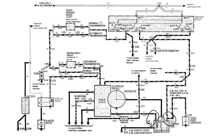

Good morning,
Did you check for power to the positive side of the coil? You need battery voltage there. If you do, use a test light on the negative side and make sure you have power.
Crank the engine and see if the light flashes while cranking.

Check ballast resistor. Make sure coil is receiving power. Using a test light, verify the coil is receiving the interrupt signal. Hook clip to ground and probe the negative coil terminal. Make sure distributor stator is properly installed and gapped. And not loose.

86 ford ranger, died while driving.Replaced the fuel pump and relay. then later realized that the pump had no power to it. Also discovered a no spark situation. So, no spark, and no power to the fuel pump. ICM and coil test ok. Put in a new ignition switch. Removed EEC computer, to go to pullnsave to find another. out of desperation, I tried without the computer installed. LOTS of spark, but still no power to the fuel pump. weird. Couldn't find a used EEC, buy suspect this may be the problem. Any Ideas? BTW. also checked the inertia switch. everything ok there too. Help!
Jul 29, 2020 at 11:50 AM (Merged)
HMAC300
  • 48,601 POSTS
there is a fusible link running probably off the starter relay it is a yellow wire leading to fp relay the fusible link is blue and are available at auto parts. make sure to put correct one in.

Hi everyone, Thank you again for all your help!. We fixed it. It was a faulty new part. The EEC relay tested bad, so I replaced it. The new one was bad, we found out by testing the circuit again, and jumping past the relay. Lesson learned: don't always trust new parts! especially electrical parts! Have a good one

1985_FORDRANGER
i have an 1985 ford ranger that is geting no spark from coil tower. I had the coil checked by 3 diffrent autozones and they all sayed its good. So i checked (with the test light) the coil and there is power going in the + side and comeing out the - side. So i thought it was my pickup unit. I replaced the whole distributer and still no spark. I was driveing it all day, starting it and shuting it off, but the last time i shut it off it never turned back on. All it does is crank.
Jul 29, 2020 at 11:51 AM (Merged)
  • 75,992 POSTS
At the negative side with the test light is the test light blinking while cranking it over.
Pull the coil wire from the distributor and ground it to the engine and crank engine over -do you have a snapping blue spark. If not start with the ignition control module.
