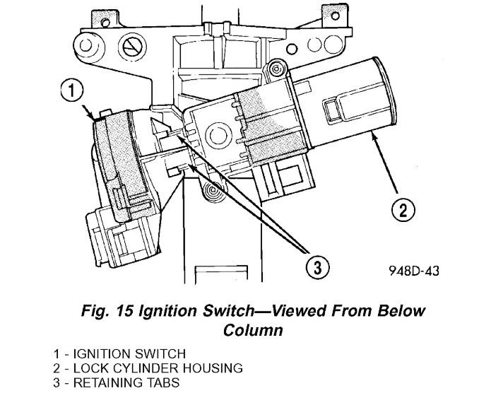

The ignition switch attaches to the lock cylinder housing on the end opposite the lock cylinder (Fig. 15). For ignition switch terminal and circuit identification, refer to the Wiring Diagrams.

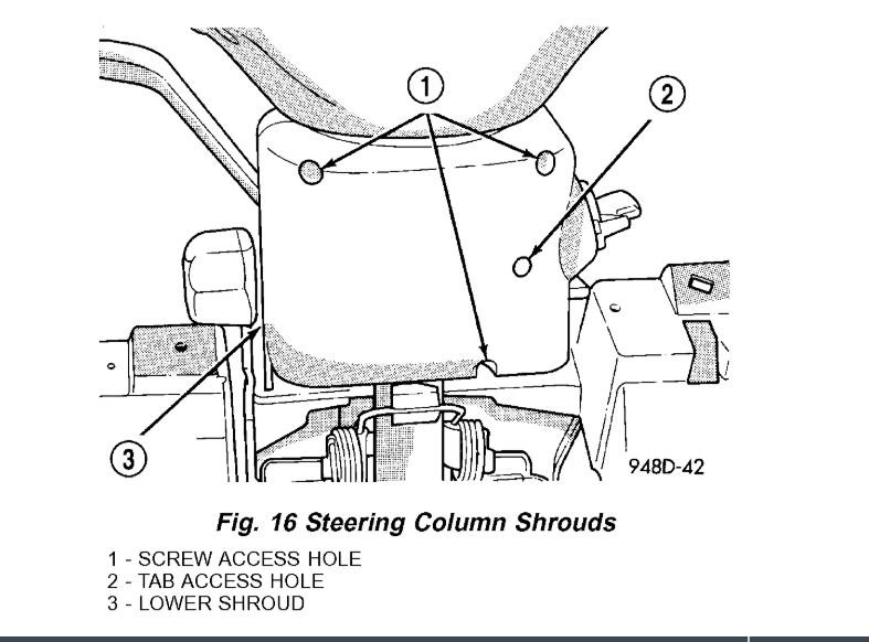

2. Place key cylinder in RUN position. Through the hole in the lower shroud, depress lock cylinder retaining tab and remove key cylinder (Fig. 16).
3. Remove upper and lower shrouds from steering column.

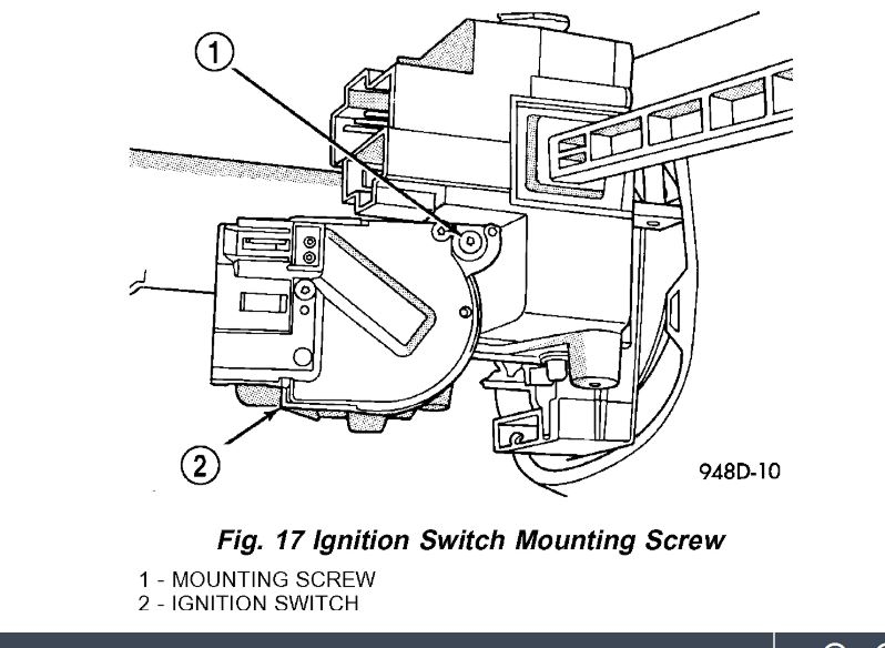

5. Remove ignition switch mounting screw (Fig. 17) with a #10 Torx bit.

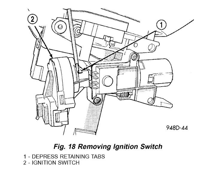

6. Depress retaining tabs (Fig. 18) and pull ignition switch from steering column.

2. Carefully install the ignition switch. The switch will snap over the retaining tabs (Fig. 19). Install mounting screw (Fig. 17).

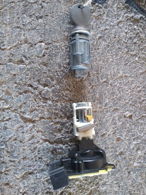

Hi Roy, I made it back from the Pick-A-Part with a different ignition switch. And you were right the ignition switch was the problem. Finally this is awesome thanks so much. Would you be able to tell me how to separate the ignition switch from the mechanism in between it and the key mechanism? If you look at the picture I sent I need to separate the middle piece from the black piece on the right.

I don't know how you're viewing the picture but it's showing me the picture as in vertical as opposed to horizontal. So what I need to do is separate the white piece from the black piece. Thanks again.

I know I need to be careful in this process because while I was at the Pick-A-Part I broke the exact same mechanism down there by barely pulling on it.

Okay, look at the pictures I posted. There are 2 tabs you depress to release it from the switch.
