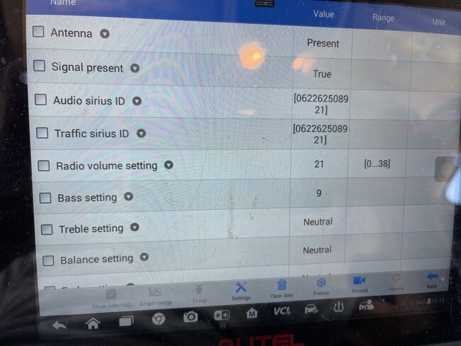

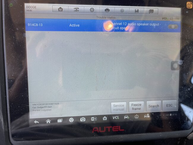

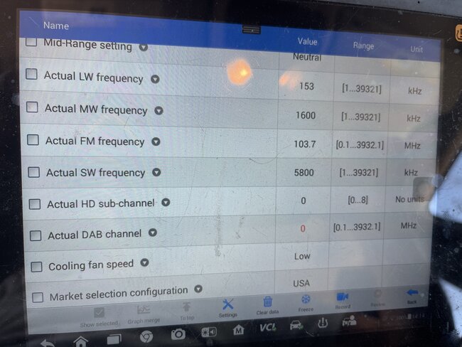

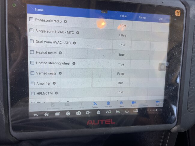

I tested amp and it was fine. But here are some codes and data.
Saturday, June 8th, 2024 AT 3:20 PM
BHAMDOC1973
  • 2,018 POSTS

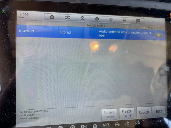

These codes and data under radio or frequency.
Saturday, June 8th, 2024 AT 3:23 PM
AL514
  • 5,584 POSTS
Okay, pretty interesting the radio sees an open on the antenna, at least we know the issue now, the trouble is finding one of these connectors to test if it's the actual antenna or wiring.

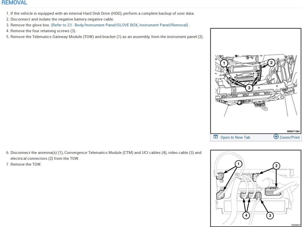

Are you able to access the radio and get at the antenna connector? It should be the white antenna connector.
Sunday, June 9th, 2024 AT 3:42 PM
AL514
  • 5,584 POSTS
So, you're still after this Telematics Gateway unit behind the glove box.
