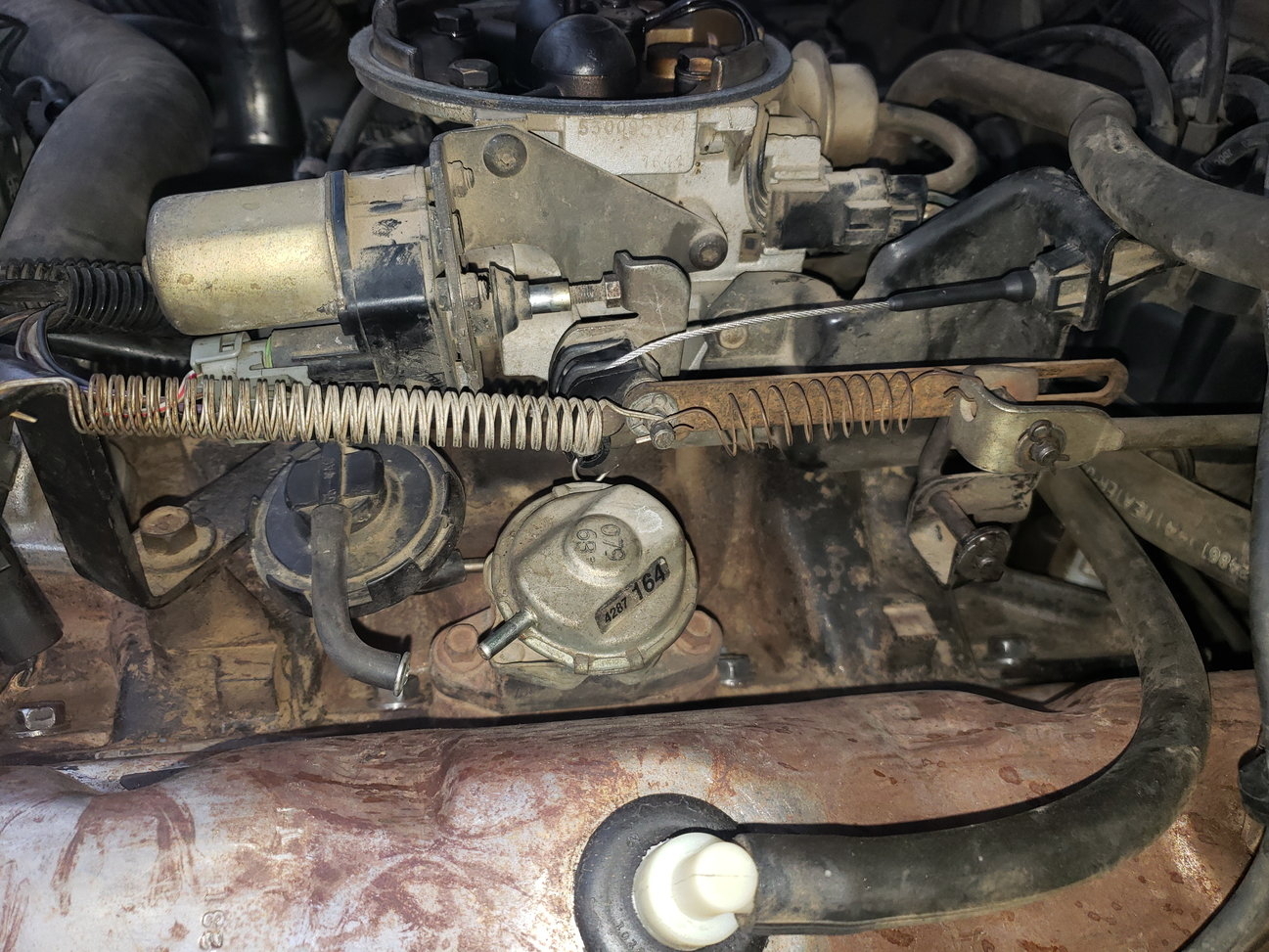

Further info. Tested the Idle speed control or throttle kicker as it called some places. Tested top pair got continuity and 18 ohms, bottom pair got continuity and zero ohms. Does this indicate a short? Also, no power to this either. Tested all pins in harness to ground and nothing.

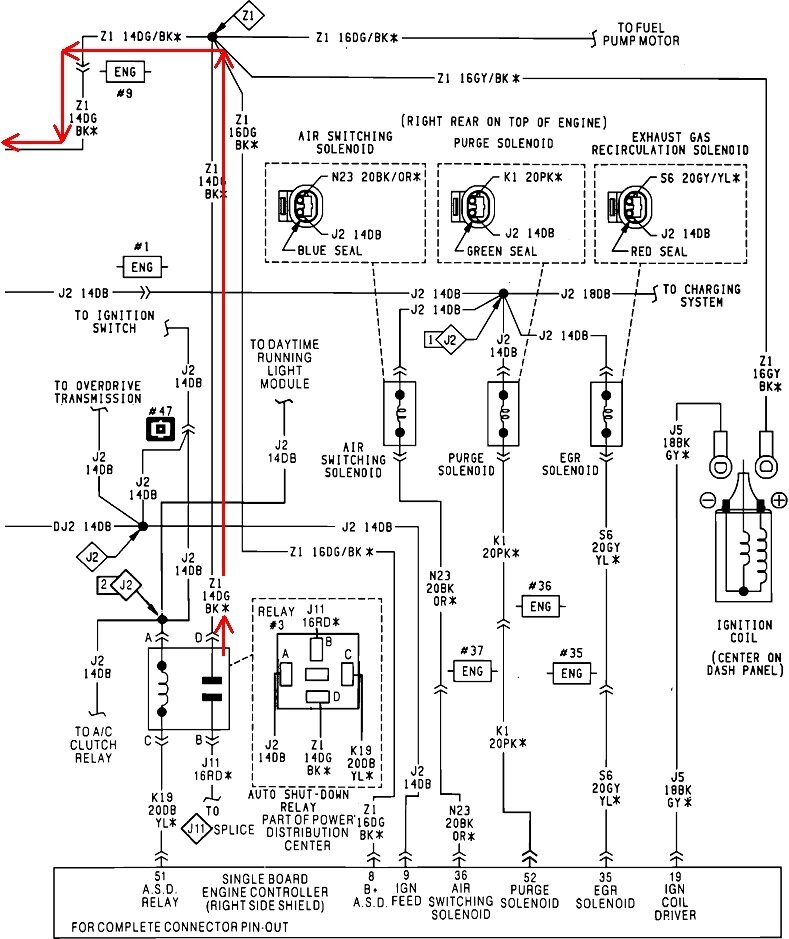

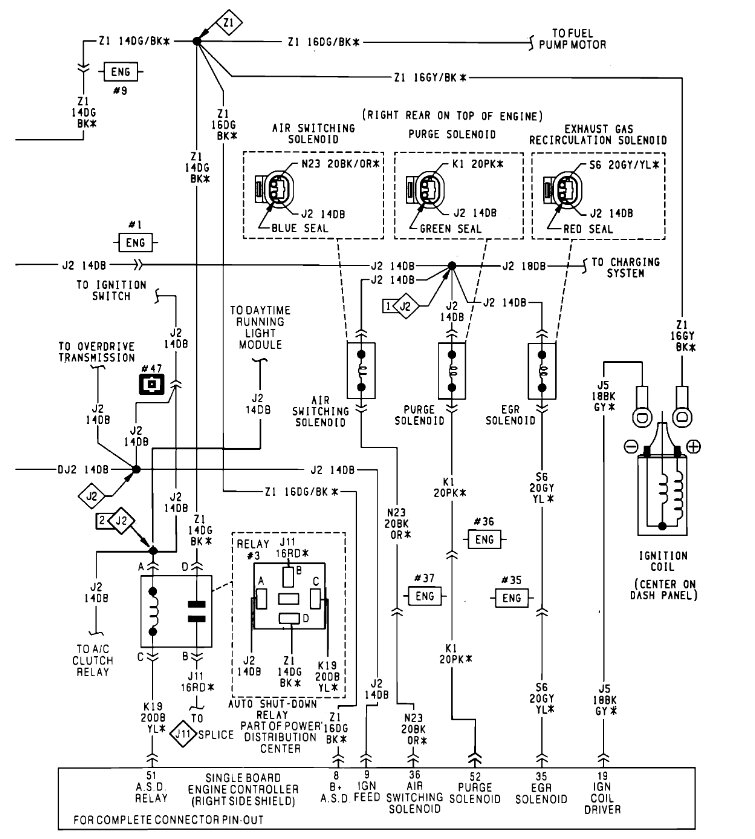

1. The power, (12 volts) you keep finding that's missing at the injectors is supposed to be missing. If you monitor that feed circuit with a test light, proper operation is for the light to turn on full brightness for only one second when you turn on the ignition switch, then it will go back off. That proves that circuit is working. The same circuit feeds 12 volts to the positive terminal of the ignition coil, to one of the alternator's smaller field terminals, and a number of other places including the fuel pump or a separate fuel pump relay. Checking this circuit with a digital voltmeter is not recommended as they respond too slowly. This 12 volts is coming from the automatic shutdown, (ASD) relay which is controlled by the Engine Computer.
Next, the ASD relay gets turned on again any time the computer sees engine rotation, (cranking or running). You're finding 0 volts at the injectors because you're not cranking the engine while testing for voltage. Other manufacturers have different names for the ASD relay, but they all have the same purpose. That is to stall the fuel pump if a fuel line is ruptured in a crash. If that happens, the engine can't run without fuel pressure. Since it stalls, the signal pulses from the crankshaft position sensor and the camshaft position sensor stop showing up at the Engine Computer. Lacking either of those signals is what tells the Engine Computer to turn the ASD relay off. Among all the other things, that removes the 12 volts to the fuel pump, so it doesn't dump raw gas on the ground through that ruptured hose.
I should mention too that there are different diagnostic fault codes that can be set related to those missing signals, but they take some time to be detected before a code will set. For that reason, don't automatically assume both sensors are working just because there's no code(s) set related to them. They often need more time, as when a stalling engine is coasting to a stop while driving, to be detected. A scanner is needed to see if those two signals are showing up when there's no related fault codes.

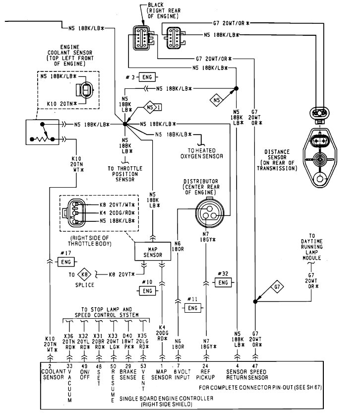

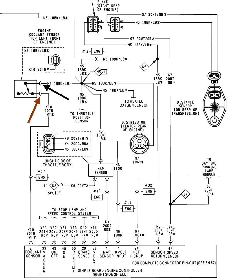

Dandy observation on the coolant temperature sensor, but that shouldn't cause a problem either. For a '91 model, there will be two of them. One has a single wire. That is for the dash gauge only. The other one is for the Engine Computer and will have two wires. You should not find 5.0 volts there unless you check that with the connector unplugged. Instead, check the voltages by back-probing through the rubber weather seals alongside the wires. The readings are only valid when the connector is plugged into that sensor.
That circuit does start out inside the computer from the carefully regulated 5.0 volt power supply that runs most of the sensors. The difference with this one is there's a resistor inside the computer that "drops" some of that 5.0 volts when current is flowing through the circuit. What's left over is what you'll find where that wire leaves the computer and at the sensor's connector. That's the signal voltage. Typically you'll find somewhere in the area of 2.0 to maybe 4.0 volts. If you monitor it with your voltmeter, you'll see the voltage gradually dropping as the coolant warms up. If you want to stymie your friends, watch that voltage when the coolant gets somewhere around 160 to 180 degrees. That voltage will be down around 2.0 to 2.5 volts, then suddenly pop back up to around 3.5 volts, give or take, then start slowly dropping again. That's the temperature at which the computer is switching over to a different internal resistor so the sensor readings will have more precision at normal operating temperature.
Temperature sensors for liquids and air have extremely low failure rates because there's just one component inside them. There was one notable exception. In the early to mid '90s, Ford had a huge failure rate, but that had to be due to some type of manufacturing problem to have so many cause trouble. Other than those, well over 99 percent of problems in this circuit are due to corroded or bent connector terminals, or cut wires.
The diagram below includes the coolant temperature sensor. I added two arrows to show the two wires in the connector. Start by measuring the voltage on the tan / white wire, but remember, that has to be done with the connector plugged in. The two extremes that will set a diagnostic fault code are 0.0 and 5.0 volts. Those correspond to a cut wire, (or unplugged connector) or a break in the circuit further down the line. For explaining circuit theory, we customarily use 0.5 to 4.5 volts as the acceptable range for signal voltages. If you find anything within that range, you're done in this circuit. Every other part of the circuit, including the sensor, has to be working properly to get a reading on the tan / white signal wire that is within the acceptable range.
If you care to measure the voltage on the sensor's ground wire, Chrysler usually uses a black / light blue wire for sensor grounds. (That's black with a light blue stripe, or "tracer). Expect to find 0.2 volts on that one. That's because they don't go directly to a point on the engine or body sheet metal for ground. Instead, the grounds from most of the other sensors are all tied together, then they go through the Engine Computer on their way to ground. That's so the computer can monitor that circuit. That's also why there's two tenths of a volt there instead of 0.0 volts. If you were to find considerably more than 0.2 volts, there's a defect in that wire. We can narrow it down by finding if that same incorrect voltage is found at other sensors too or if it only affects the coolant temperature sensor. We'll cross that bridge when we have to.
Related to this, when you have a vehicle with an electric radiator fan, as you'll find on most front-wheel-drive models, you can quickly determine if the circuits are working by just unplugging this two-wire coolant temperature sensor with the ignition switch on the "run" position, with or without the engine running. Doing so will instantly be detected by the Engine Computer. It will set a diagnostic fault code, turn on the Check Engine light, and turn on the radiator fan. When you reconnect that plug, the fan will turn off within a few seconds. The Check Engine light might turn off, depending on model and year. If it doesn't, it will be off the next time the engine is started. If you don't erase the fault code, and you don't disconnect that sensor again, that code will self-erase after 50 engine starts. The system works that way because when there's a defect in the coolant temperature sensor circuit, the Engine Computer can't know coolant temperature. The fan gets turned on in case the engine is overheating.

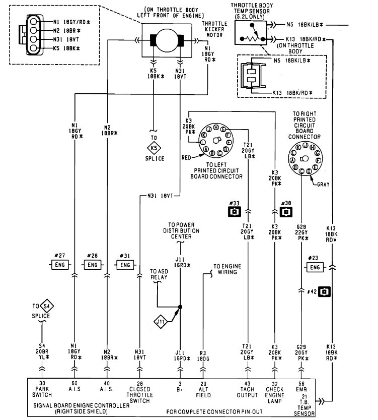

For my final comment of value, I found why I never worked on a "throttle kicker" circuit.
They gave the part in question a different name for a couple of years. In later years it was called the "automatic idle speed" motor, or "AIS". GM uses the same part. You might find it called an "idle air control" motor or a few other names, but most of them, other than Ford's, work the same way. It's not a motor as you think of a spinning armature and brushes. Instead, there's four electromagnetic coils of wire that get pulsed with varying voltages and polarities by the Engine Computer. The armature follows the rotating magnetic fields, and as it rotates, it turns a threaded shaft. The total range for that shaft is about ten revolutions from fully extended to fully retracted. As it retracts, it opens a pintle valve that exposes more of an air bypass passage around the throttle blade. At the same time, the computer increases the number of milliseconds it pulses the injectors open. The increased air and fuel raise idle speed.
The computer can set that AIS motor to any of 256 positions, or "steps". For a properly-running engine, expect to find it at around step 32. With a single-cylinder misfire on a V-8 engine, it's typical to find it at around step 50.
Here's the important part you need to be aware of. With all the work you've been doing, there's a good chance you disconnected the battery or the Engine Computer at some point. Doing so erases everything the Engine Computer learned while you were driving. All of the sensor personalities and fuel trim data will be relearned as soon as you start driving again, without you even noticing. The one notable exception is "minimum throttle". Until that is relearned, idle speed will be too low. The engine may not start unless you hold the accelerator pedal down 1/4". It will not give you the nice "idle flare-up" to 1500 rpm at start-up, and it will tend to stall at stop signs. You'll have to drive with one foot on the accelerator pedal and the other working the brake pedal.
A very specific set of conditions must occur for the computer to know your foot is not on the accelerator pedal, then it takes a reading from the throttle position sensor and puts that in memory. From then on, every time it sees that same voltage, it knows it must be in control of idle speed. Those conditions occur when you go out and drive at highway speed with the engine warmed up, then coast for at least seven seconds without touching the pedals. At the end of that seven seconds, minimum throttle will be learned and the computer will be in control of idle speed.
If you were to look at the "AIS Steps" on a scanner, it will show "step 0" when minimum throttle hasn't been learned yet. For most people this low idle speed problem seems to magically fix itself, and they don't know why, but it's because the conditions needed can typically be met by coasting halfway down the typical off-ramp.
For your viewing pleasure, I added the second diagram that shows the AIS motor at the top. "Throttle kickers" used to be a two-wire solenoid that pushed the throttle blade open a little on carburetors. This circuit is entirely different in circuitry and operation, but they kept the name to be sure we'd be confused. It's just the standard, common circuit that was used until they switched to "throttle-by-wire" systems in the mid 2000s.

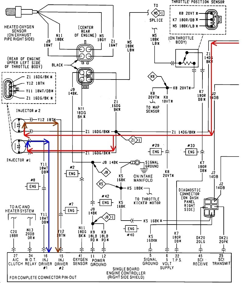

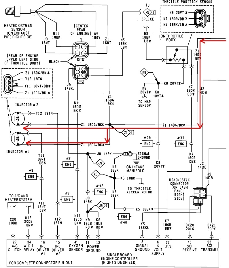

Both injectors are fed with the 12 volts coming from the ASD relay. The Engine Computer grounds each one on individual ground wires to fire them. Both fire at the same time, and each one feeds one side of the engine.
For the throttle body injectors I remember working on years ago, you could see the cone-shaped spray pattern under each one.
What you found reminds me of a friend who ran into this with a Chevy Astrovan about 15 years ago. He too could see the spray missing from one injector. Funny thing was it only acted up when it was raining. The black connectors looked like half of a hard-boiled egg. When he pushed on one, the spray returned and the engine ran fine.
Rather than trying to replace or disassemble the connector, the typical place to start is by picking the connector terminals with a skinny metal pick. Try to squeeze the two sides of the terminals in the connector so they make a tighter contact. The injectors will have two tips sticking up, kind of like the tip of a ball point pen. Scratch those lightly a little with fine sandpaper to remove any light film of corrosion. As a last resort, you can bend those very slightly so they make tighter contact against the terminals in the cap. Another thing to try is squeezing those pins with a larger needle nose pliers to make them oval-shaped. That can make them fit tighter too.
Keep us up to date please on your progress.

I suspected the cap connection was not making contact with the injector, but wouldn't the fact that I get no voltage on one line before the cap mean the failure is further up the chain? Or would bad contact prevent circuit completion and therefore nothing on that line?
Saturday, September 9th, 2023 AT 6:07 PM
CARADIODOC
  • 34,463 POSTS
Your second guess is correct. 12 volts appears on one wire, coming from the ASD relay. If that connector is unplugged, that's the only wire you'll find 12 volts, but again, that's only for that first one second when the ignition switch is turned on, and during engine rotation, (cranking or running).
When it's plugged in, the 12 volts makes it through the injector's electromagnetic coil and shows up on the other wire. In fact, that 12 volts will be found all the way back to the computer. I drew red lines to show the current path. This part of the circuit actually starts in the second diagram where it leaves the ASD relay. You can see all the other places it goes, including the ignition coil and fuel pump, but the part we're interested in goes to the left and continues on the first diagram. From there, it goes to both injectors. The 12 volts ends there when those connectors are unplugged.
In the third diagram, the connectors are plugged in. Now the 12 volts shows up all the way to the computer on the brown and blue lines. I used different colors because these are the two lines the computer will ground when it wants to pulse the injectors. It uses a pair of transistors to do that. In this application, the transistors are used as simple on / off switches. When the transistor is switched on, it in effect, shorts that line to ground.
One problem with diagnosing this type of problem is I never allowed my students to pierce a wire's insulation to take a reading. Also, it's too difficult to back-probe wires in most computer connectors, so there's no easy way to know if you're getting 12 volts all the way to the computer. If the terminals aren't making a good contact in the injector's connector, that 12 volts WILL be missing on the brown or blue circuit and that injector won't fire. Fortunately, we have other ways to diagnose a bad connection, and you already found it. That's to just wiggle, poke, or irritate the plug while observing the poor or good engine performance.
I've never had to repair one of these myself, but there's usually a way to get a pick in alongside the terminal in the cap to squeeze it tighter. You'll want to do that to both of them in that connector. A bad connection with either one will cause the same problem.
There's one more way to approach this that I didn't mention yesterday, and it should be considered a last resort. If you're good at soldering, that is to dribble a little solder on the two terminals on the injector. Don't get carried away. The idea is to build up their diameter just a little so they'll fit tighter in their mating terminals in the plug. Regardless how much fatter they become, that is going to stretch the connector's terminals even more. They'll make a better contact now, but if you would ever have to replace that injector, you're even more likely to run into a bad connection. Only do that if nothing else seems to work.
After rereading your last comment about having no 12 volts before the connector, I suspect you were checking that with the engine not rotating. The ASD relay will be off then, so you would indeed find 0 volts throughout the system.
If you were checking that with the engine running poorly on one injector, we know the ASD relay has to be on and 12 volts is making it to the one firing injector. In that case, if you removed the connector for the dead injector so you could measure, and you did find the 12 volts missing, the suspects would be a cut dark green / black wire back as far as the splice, or a corroded splice itself. A cut wire isn't a good suspect because that isn't likely to work intermittently. A corroded splice can cause intermittent operation and would be the better suspect. If the splice appears to be something you want to go after, I'll try to find the drawing that shows its location so you don't have to tear the entire harness apart.
