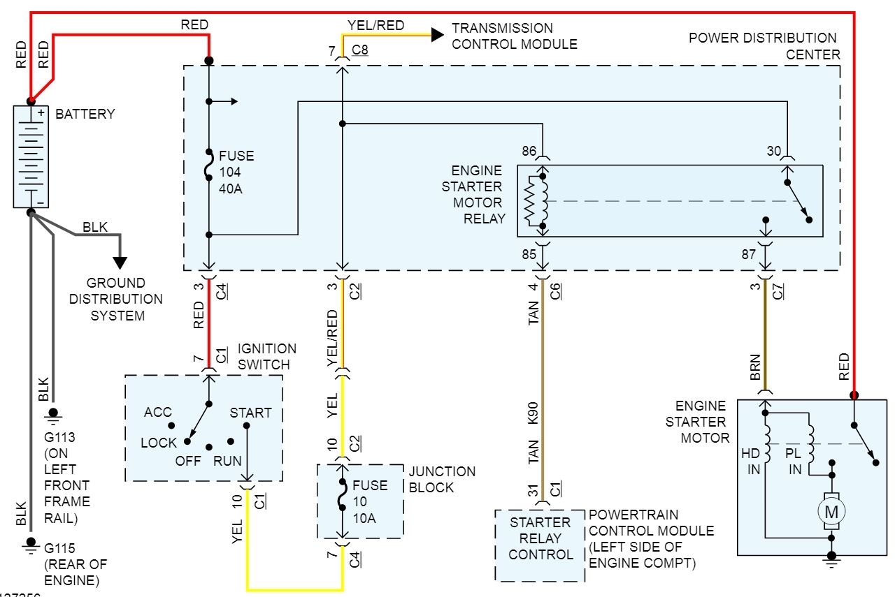

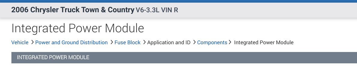

  • 54,128 POSTS

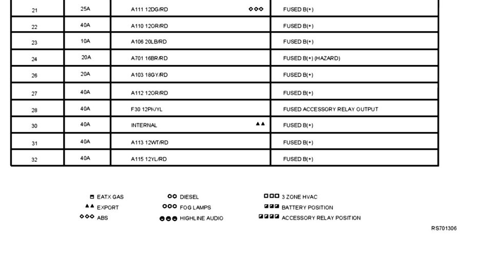

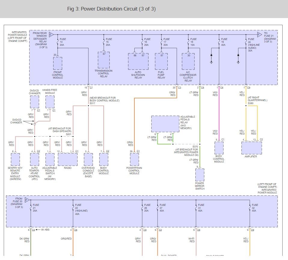

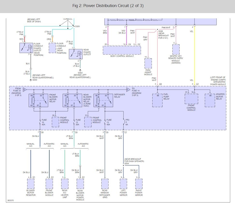

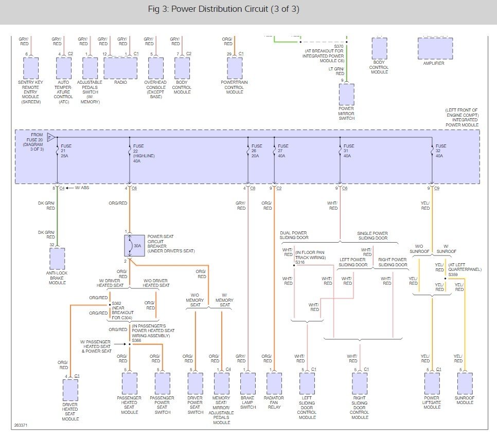

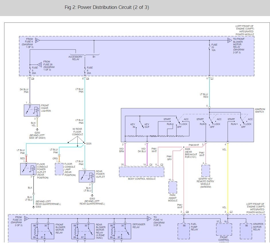

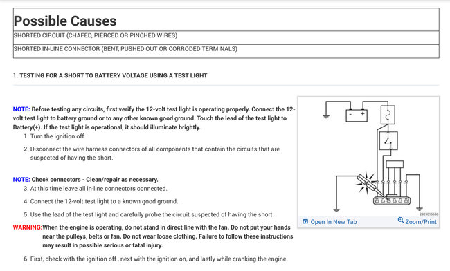

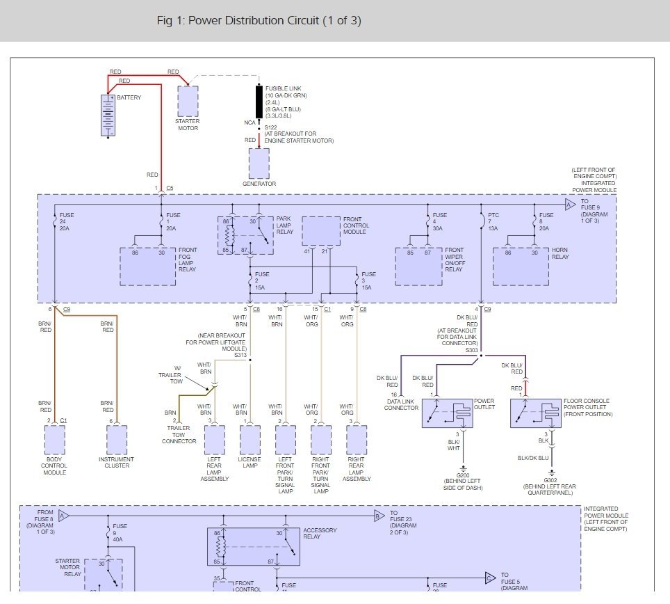

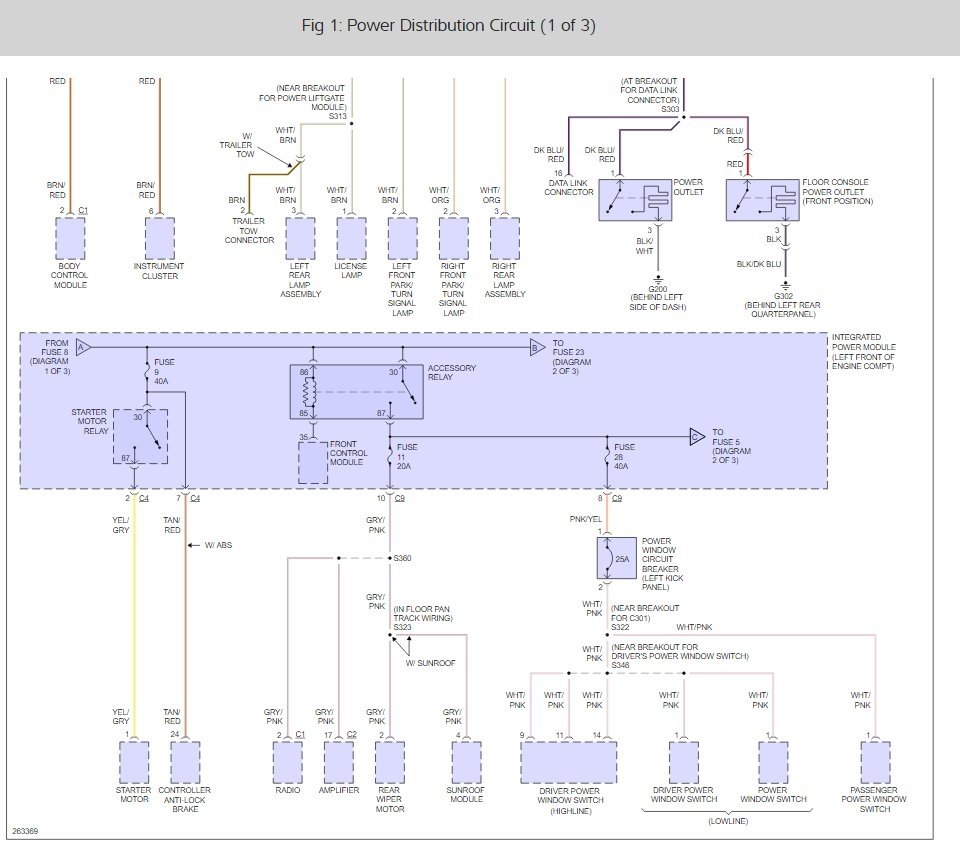

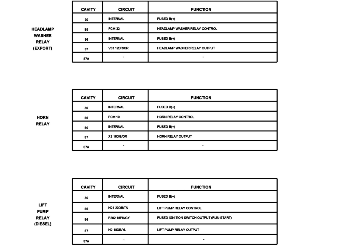

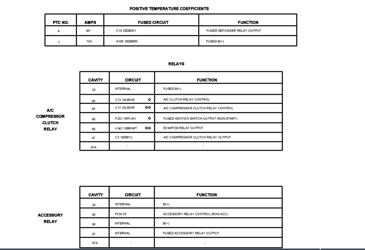

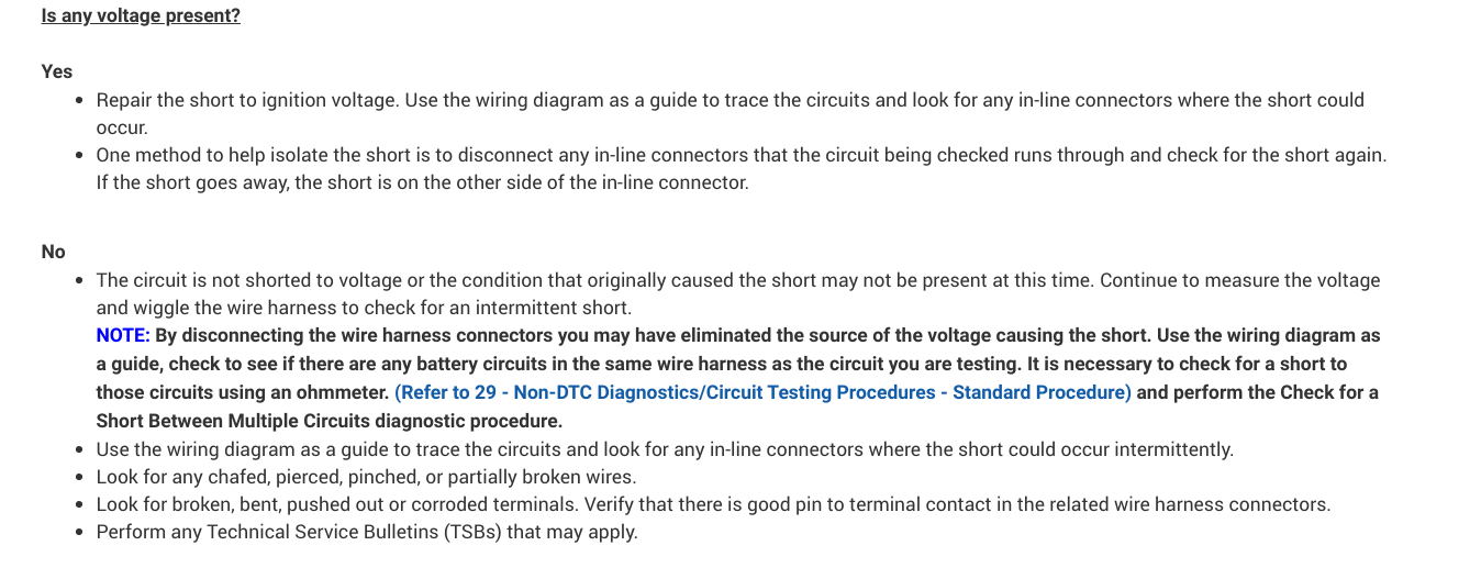

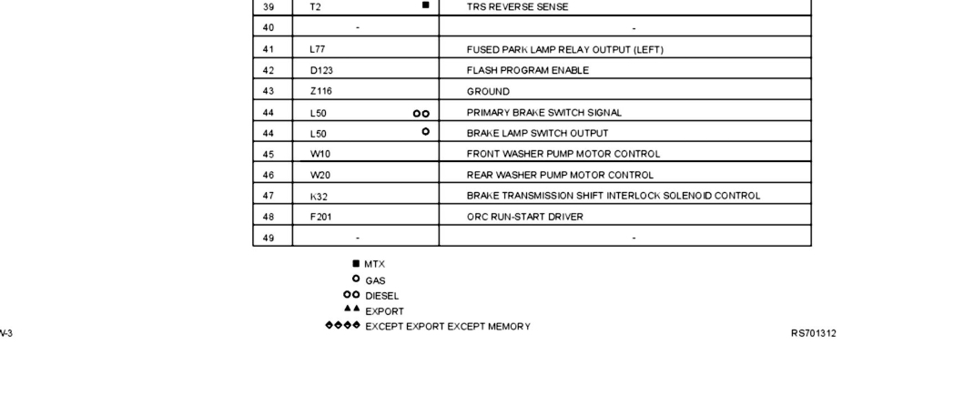

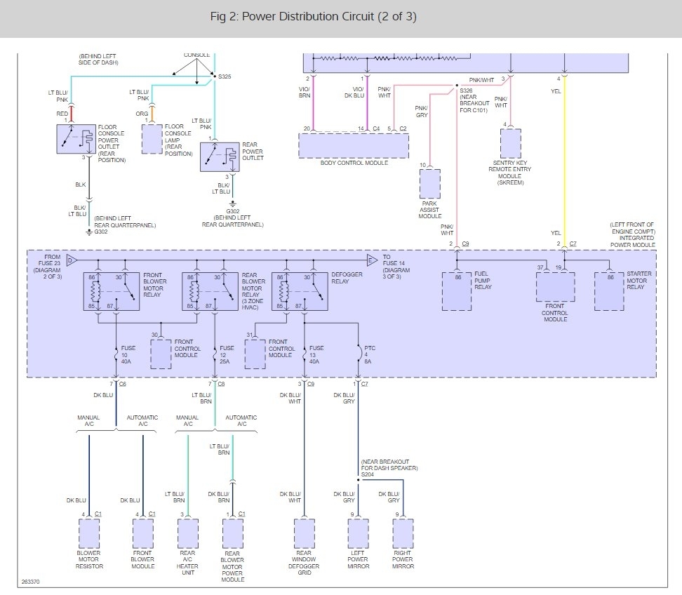

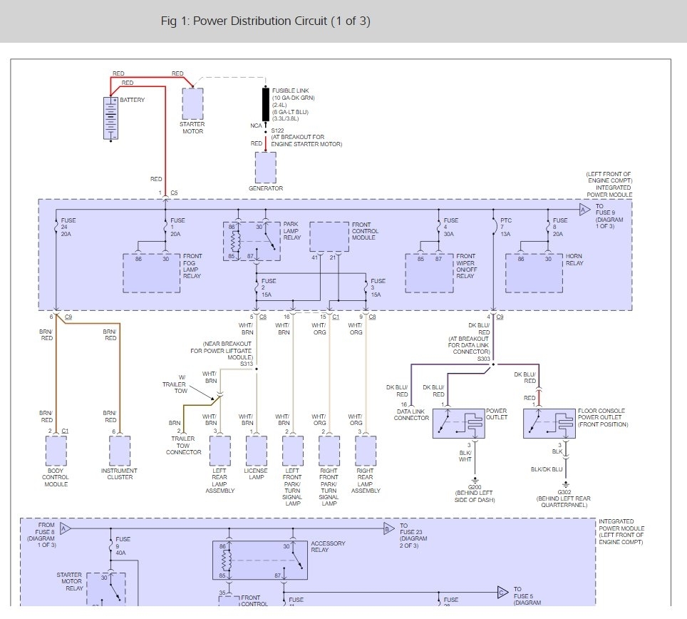

I have found the power distribution wiring diagrams for you (below) Here is a guide that will help as well.
Check to see if power is entering the PDC.
Jul 12, 2017 at 12:00 PM
STEVE W.
  • 15,145 POSTS
No power going out of the IPM with known good power going in means the control circuits have failed. OR the IPM you installed is faulty. Was it new or used?

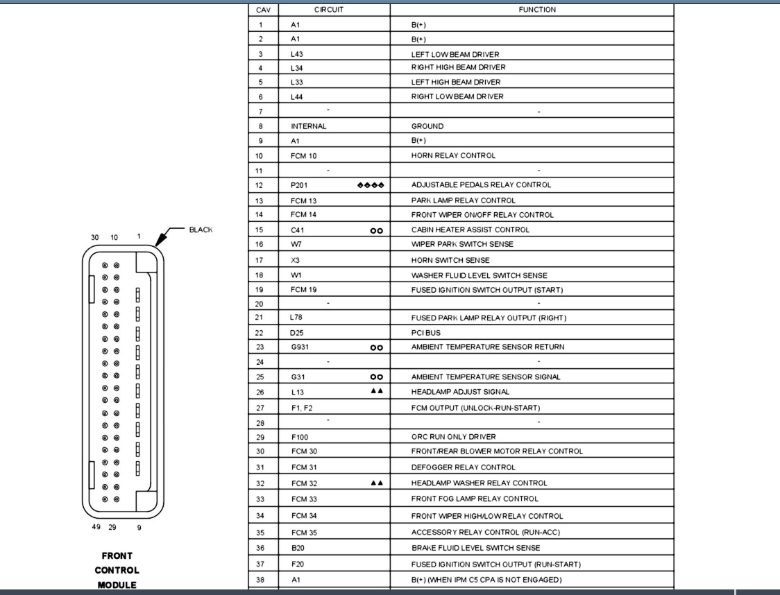

Test at the ignition switch for power in and out to the BCM. If the BCM doesn't get the wake up call from the switch many items don't get power because it turns on the relays for the other systems. Same issue with the front control module. It controls the power of most of the circuits the BCM doesn't. Test for power and ground
Ken gave you some of the power distribution side schematics.
One other item, being an 07 did you re-flash the replacement IPM to match your vehicle?

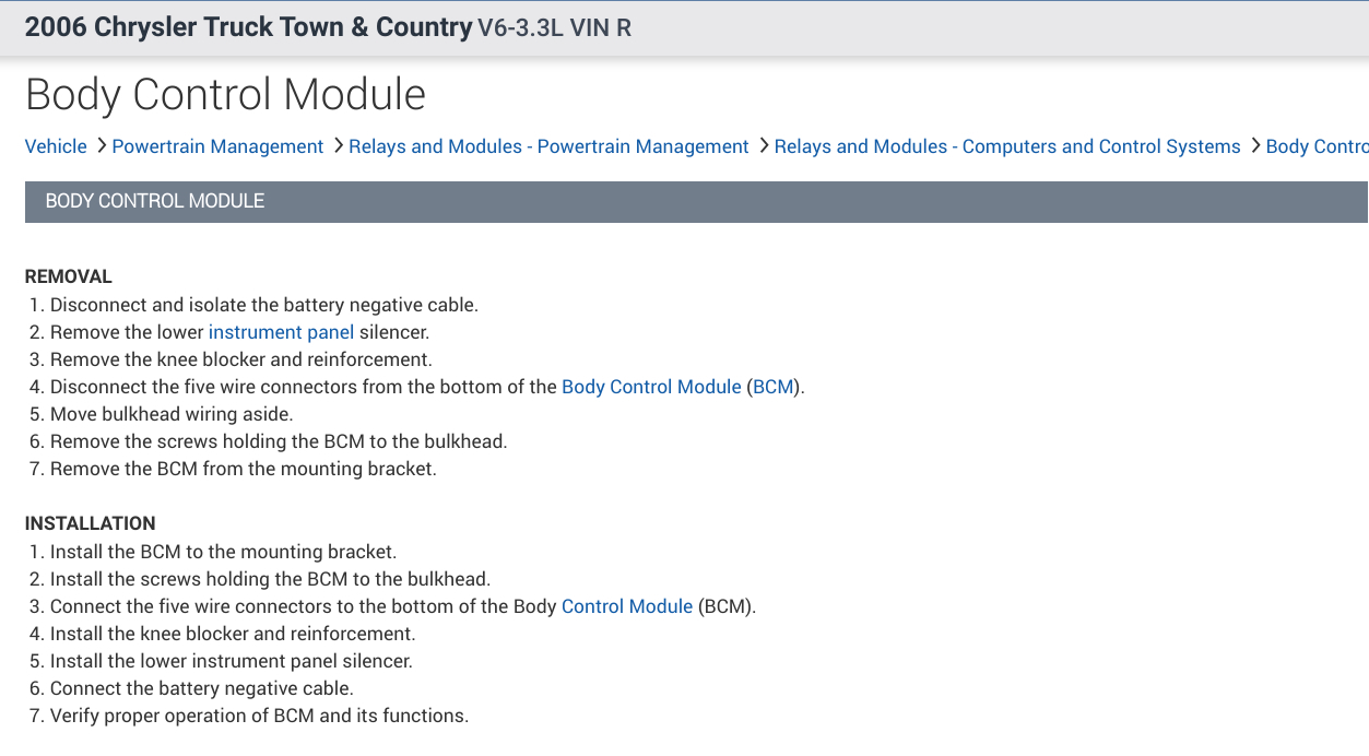

  • 4,897 POSTS

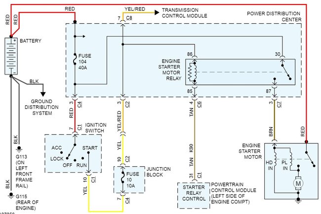

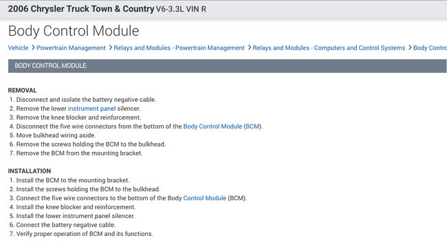

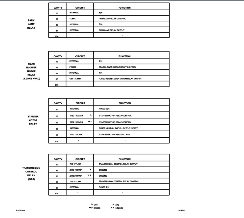

This could be a problem with your vehicle's Body Control-module [BCM]. Your vehicle's BCM controls all of the functions that are failing on your vehicle. In the diagrams down below I have included the instructions for the removal and installation of the BCM on your vehicle. Please go through this guide and get back to us with what you are able to find out.
Thanks,
Alex

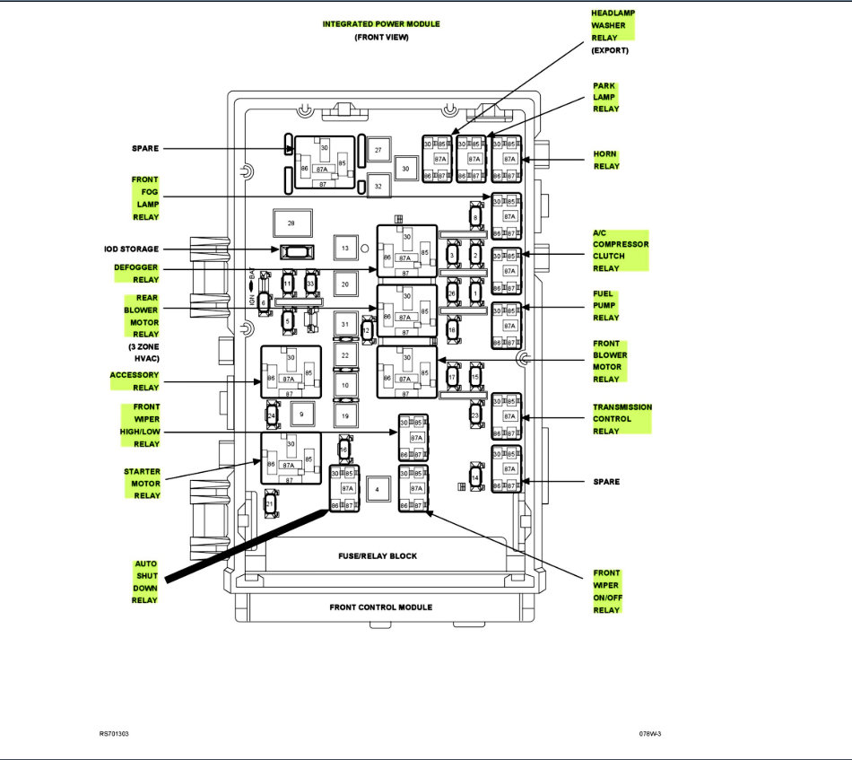

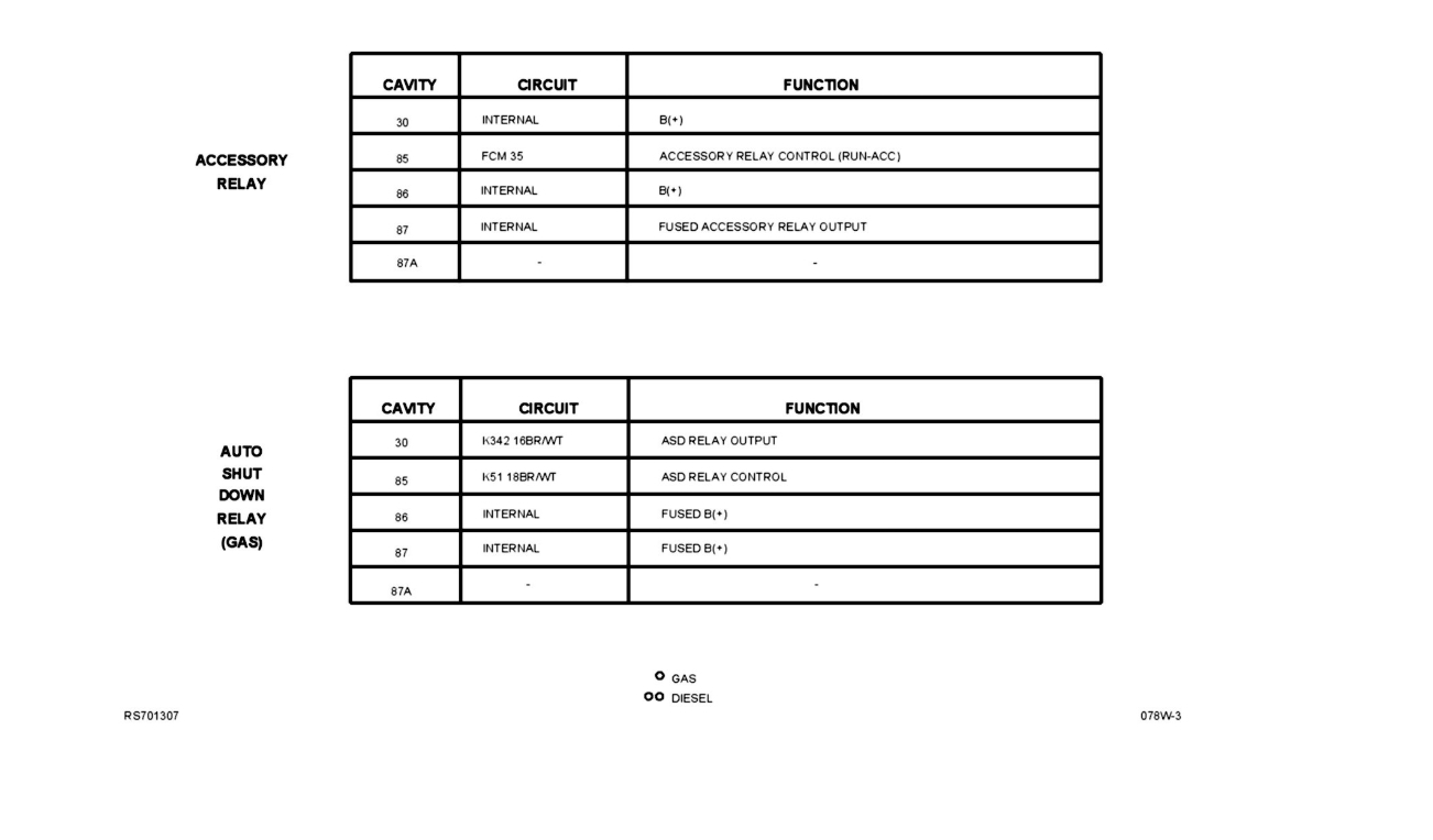

So I was able to get the car to turn over (the spade connector on the starter was loose) but as soon as it fires it dies, not like its starving for fuel but seems like the run wire is disconnected, the accessories still come on immediately when connected to the battery, does this still sound like the BCM? Is there any way to test as this part is about 400. Thanks for the help.
Feb 1, 2021 at 11:58 AM (Merged)
SCGRANTURISMO
  • 4,897 POSTS

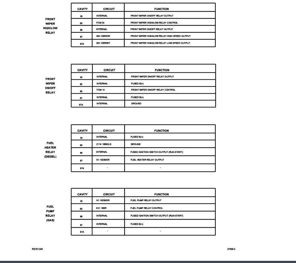

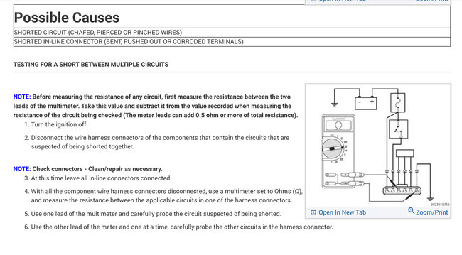

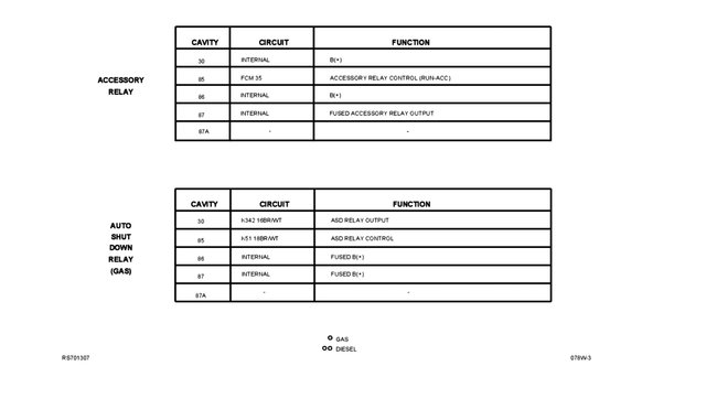

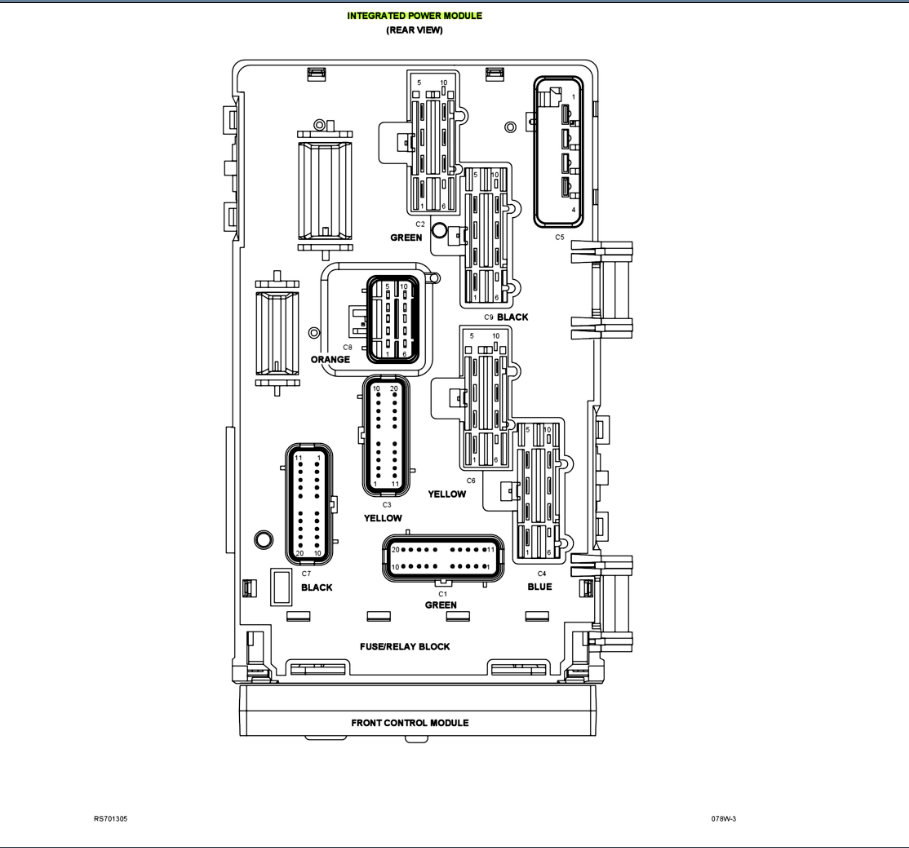

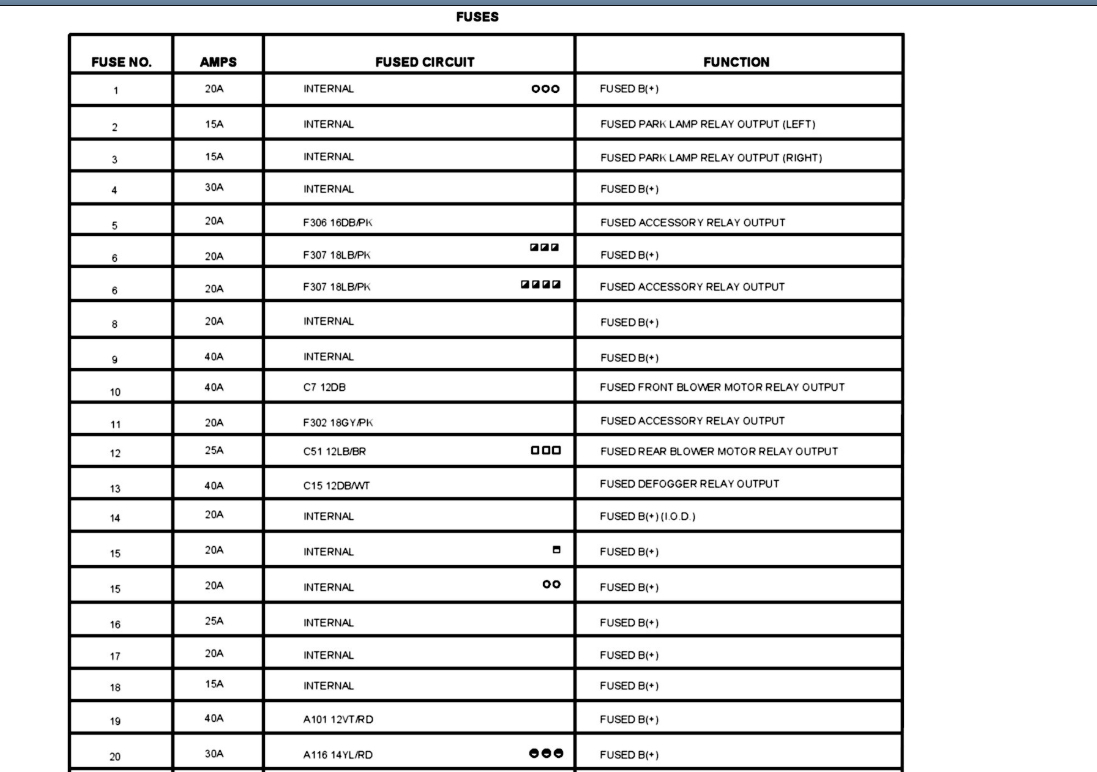

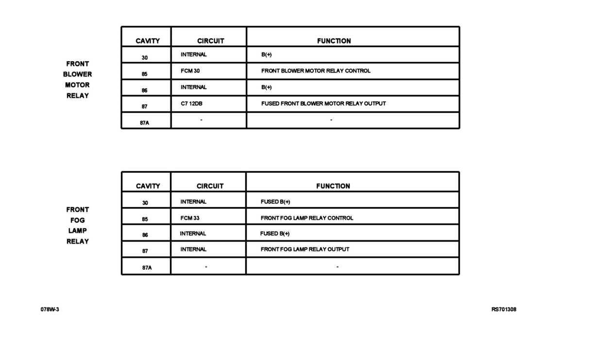

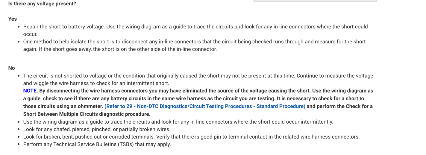

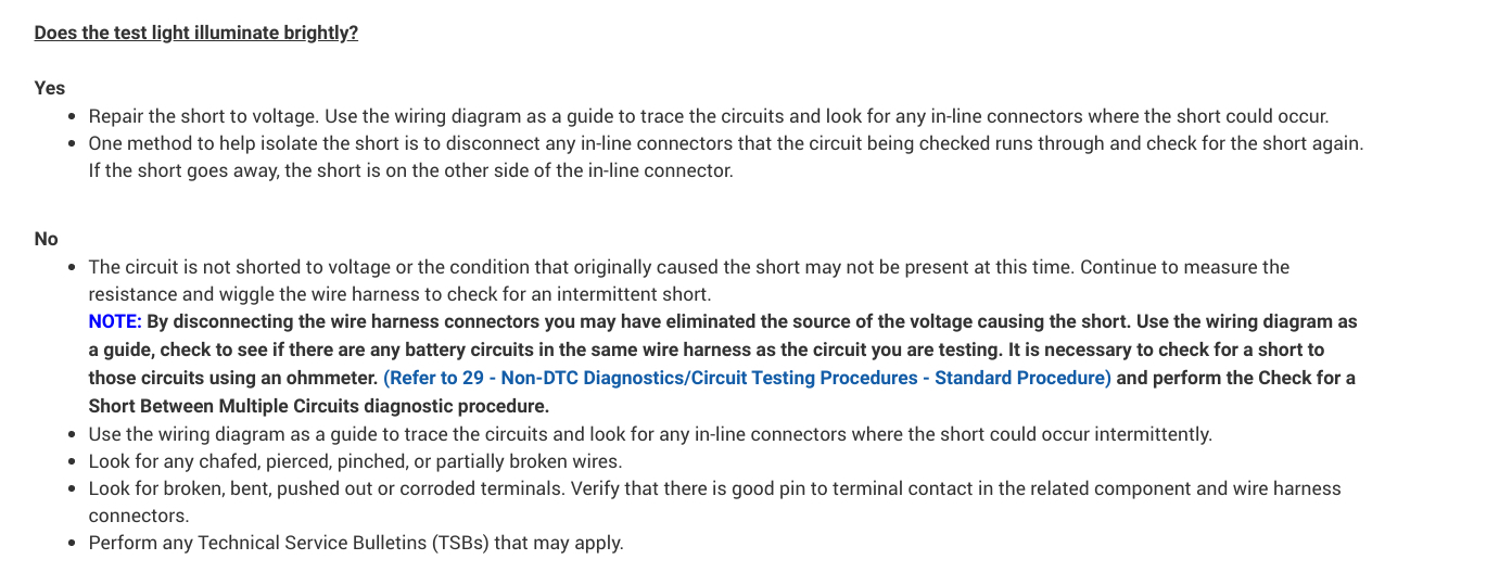

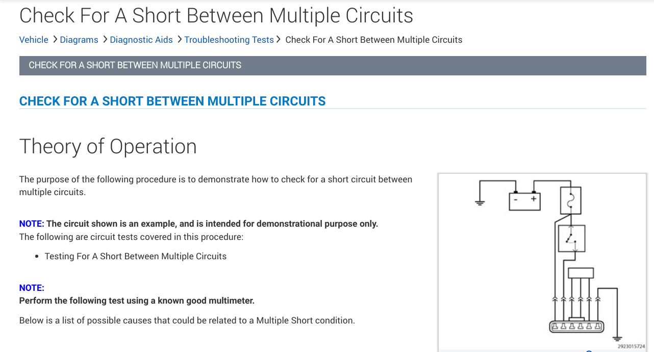

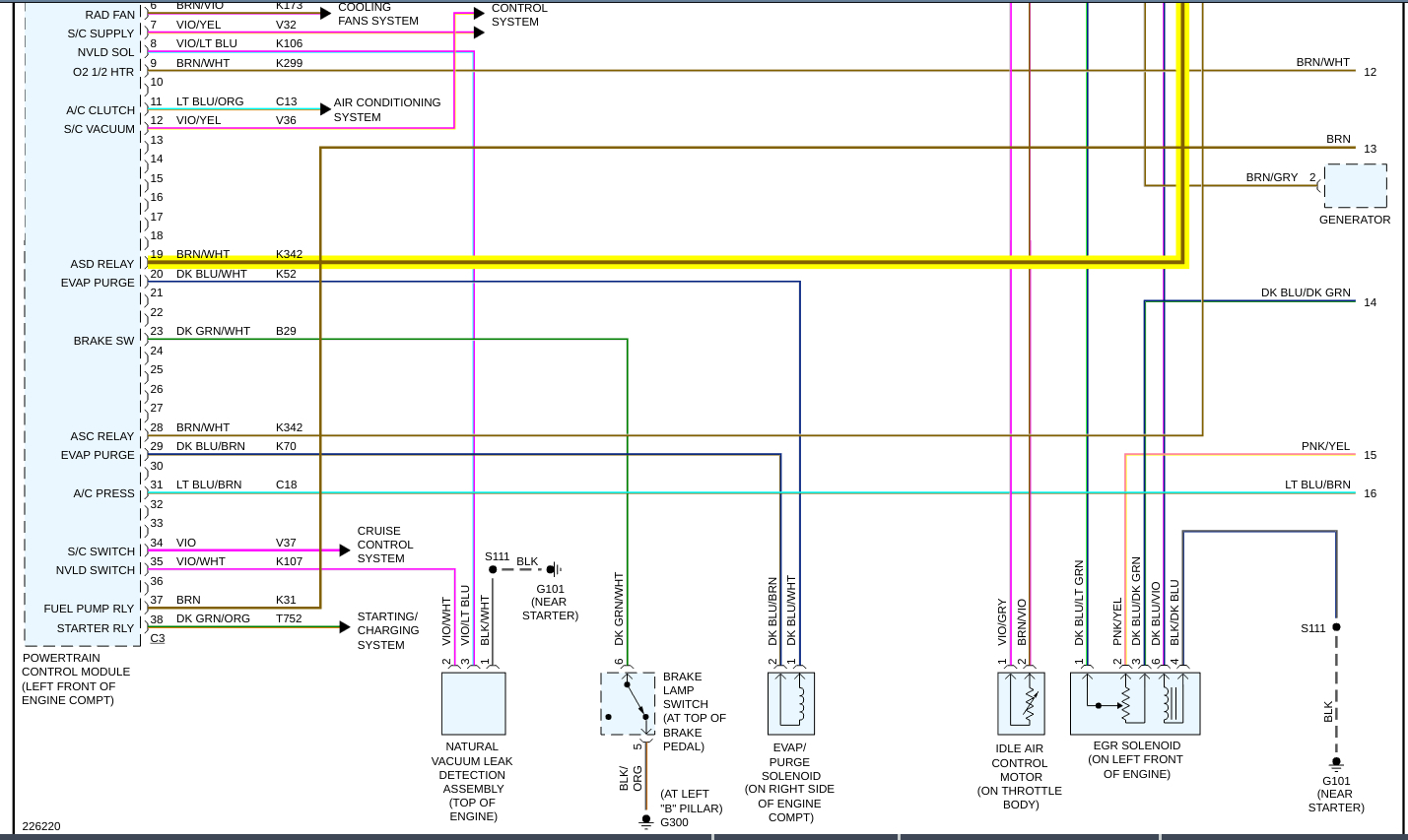

Hello again,

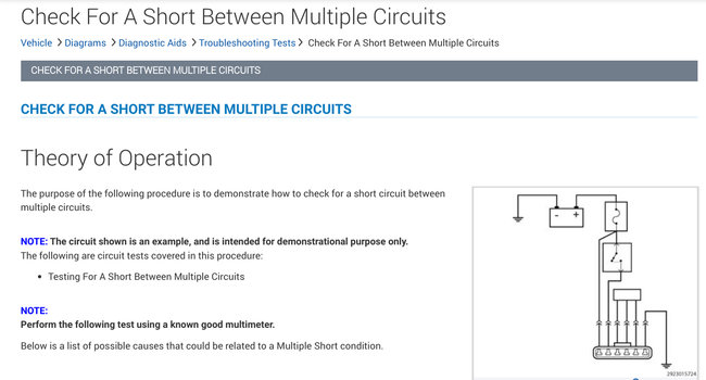

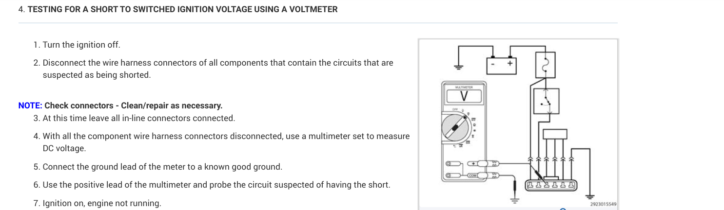

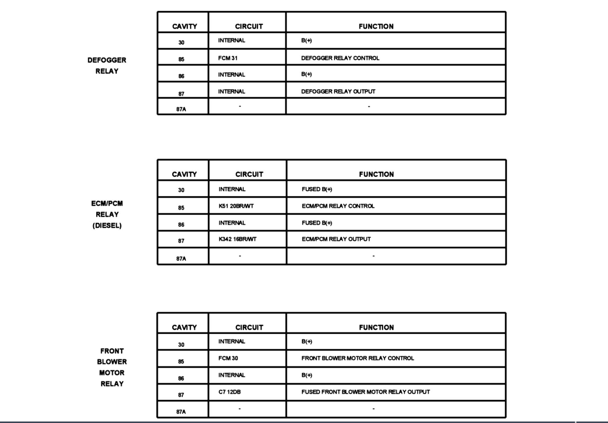

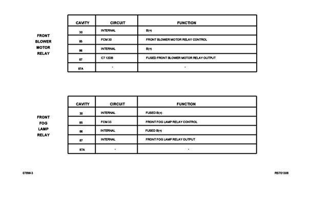

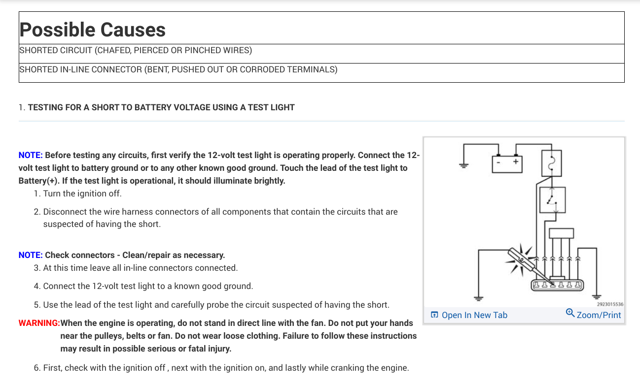

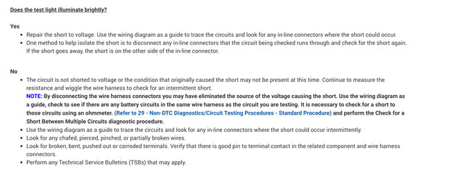

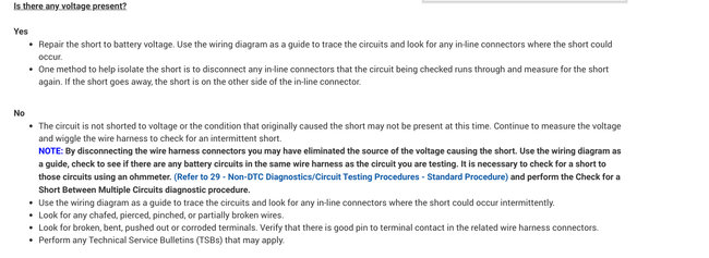

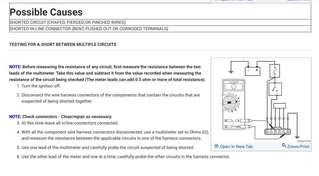

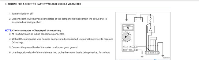

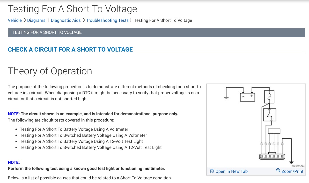

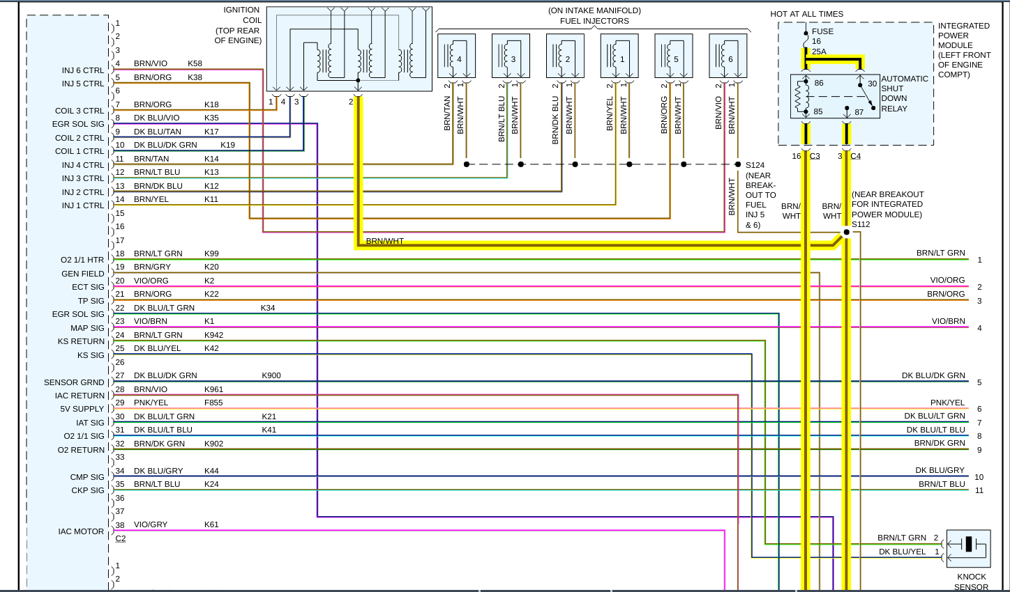

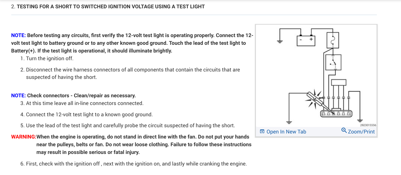

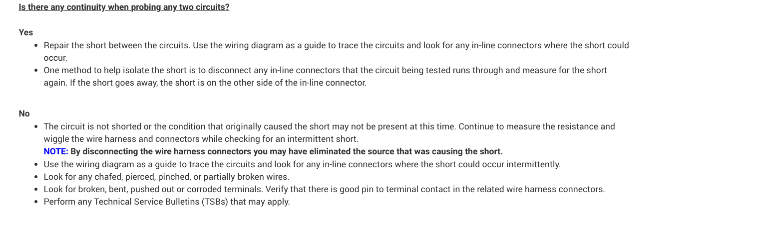

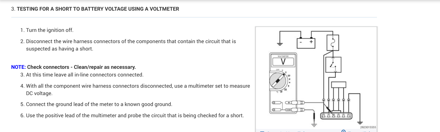

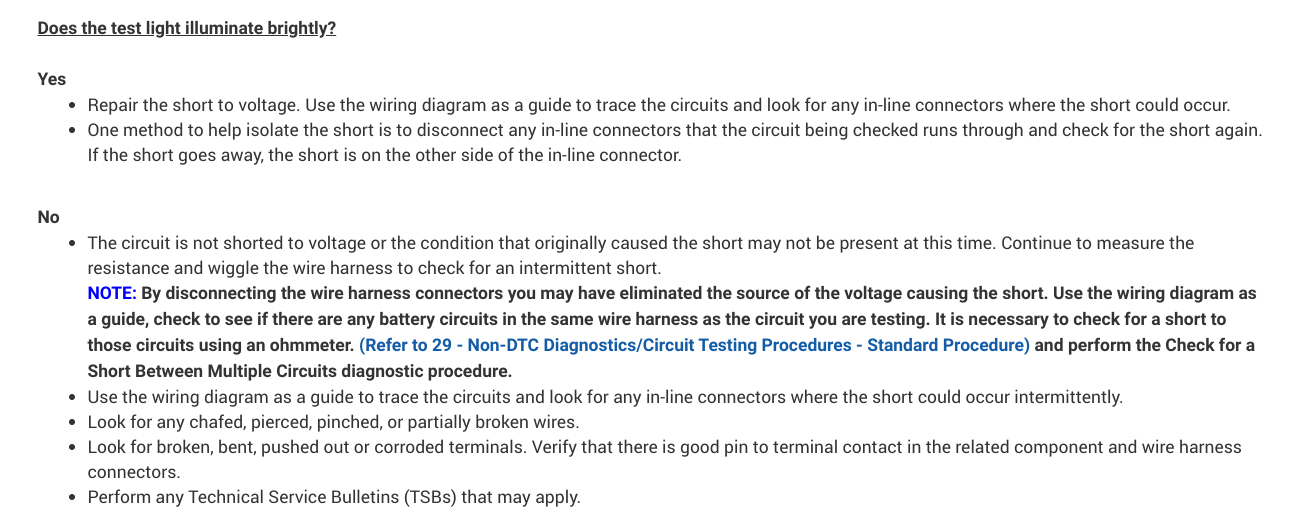

No, it doesn't. This could be a problem with your vehicle's Auto Shut Down relay [ASD]. In the diagrams down below I have included the Engine Management wiring diagram with the ASD circuit on it as well as a diagram with call outs including the relay cavity wires for the Integrated Power Module where the ASD relay is located. I have also highlighted all associated wires on the wiring diagram or you. I have also included a guide on how to find a short to power and shorts in between electrical automotive circuits for you. Please go through these guides and get back to us with what you are able to find out. You will need to use a Digital Multi-meter [DMM] and be able to test the ASD relay so here are links to guides explaining how to do both of these, if needed:
Thanks,
Alex
2CarPros

After checking the relays and replacing another fuse, when I connected the battery I smelled a burnt wire smell, turns out there is a major wire harness in between the wheel well and the firewall. Either something went through the plastic shroud in the wheel well or the burnt wire harness made a hole, either way about 1/2 the wires had melted together, after tracing all of them and soldering and heat shrinking them back together, when I connected the battery the car started right up and no problems since. Thanks for the help, all I can say is I feel very fortunate not to have had a car fire.

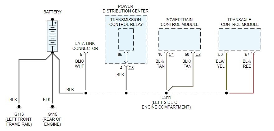

The common reason for this type of problem is a loose or corroded connection. The fusible link you found wouldn't cause this issue as it goes between the alternator and the battery. Chrysler has a real issue with rust and corrosion on the ground side of the electrical system. A quick test to see if it's the ground side is to connect a heavy jumper wire like a jumper cable between the battery negative and the engine block and the body. If you now have power it's a bad ground. The battery grounds to 3 places The common failure is the ground to the frame rail with the next being the one to the engine. The one that goes to the PDC can also act up, it can cause the transmission to act up as well. It is on the left rear of the engine compartment as well as at the power distribution centers ground connection.

Never mind, problem solved. I doubt this will help anyone else because it was such a random thing. The terminal connectors to the battery looked very new and I noticed when I was connecting the negative terminal there weren't any sparks so I started trying to make sure there was voltage from positive to the chassis ground. There wasn't, so I took the terminal off the vehicle and ground the coating off off where the connectors touched it, put it back on and problem solved. I'll have to admit if I hadn't figured that out I might have ended up chasing this for quite awhile and replacing some things that didn't need replaced. I don't know how it had connectivity for several weeks and randomly lost it during a short drive, but it did. Again, I don't know if this will help anyone out but if you are chasing a similar problem, check your terminals. I am happy this fixed it, just a bit annoyed I spent a day chasing something that took 5 minutes to fix.
