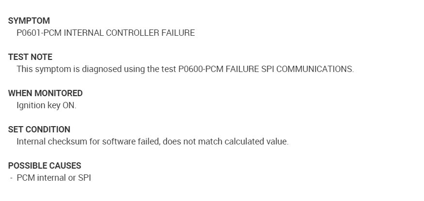

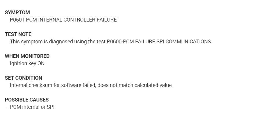

The exact code it showed on my code reader was P0601 and it said something along the lines of the malfunction of the PCM.

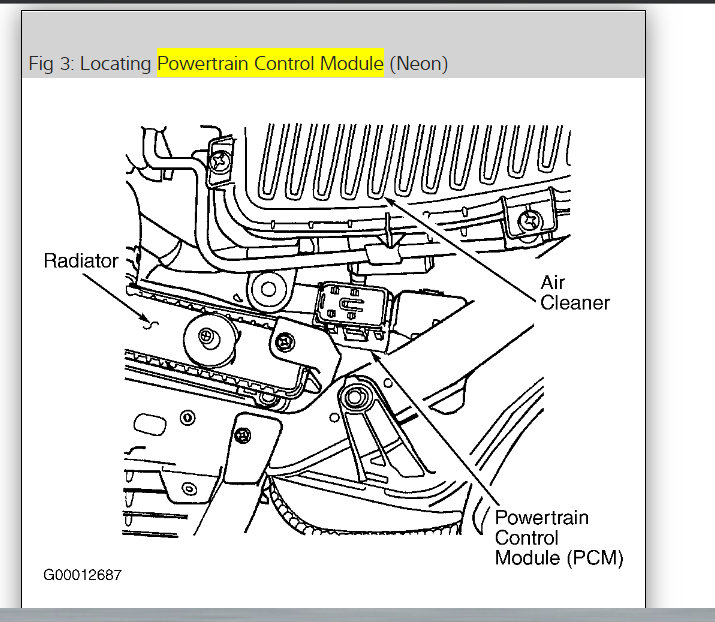

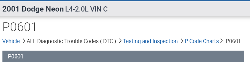

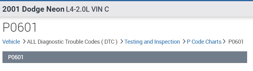

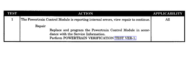

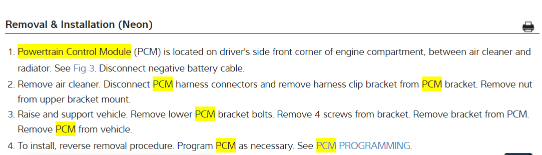

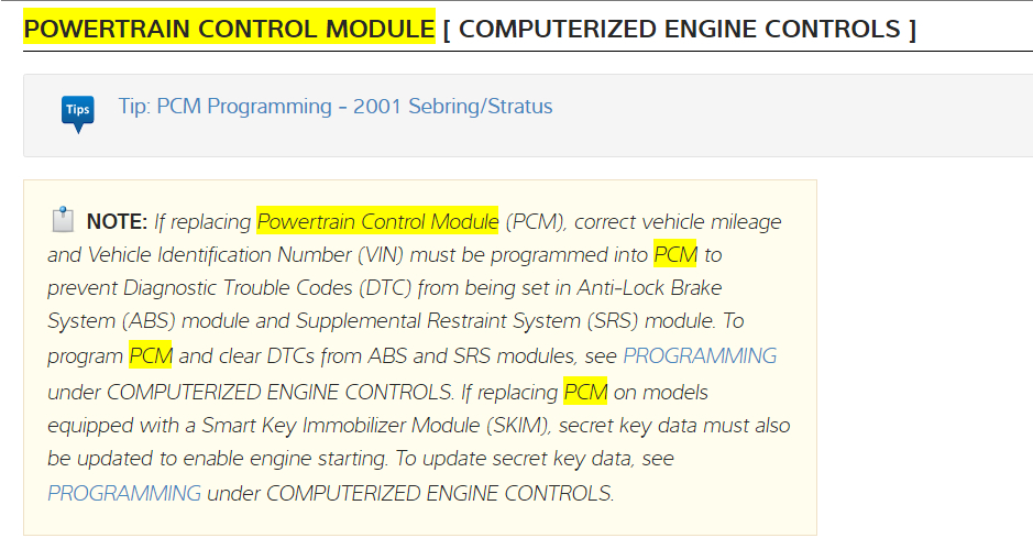

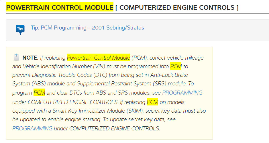

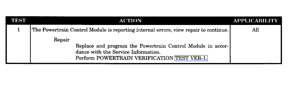

That is correct. Your vehicle's Power-train Control Module (PCM) has an internal error and either needs to be replaced or rebuilt. In the diagrams down below I have included the diagnostic troubleshooting guide for your vehicle for DTC P0601, as well as the instructions for the removal and replacement of the PCM. If you purchase a replacement PCM, you will have to have your vehicle's ignition key reprogrammed to the new PCM at either the dealership or a locksmith. There are services available on EBAY for a reasonable price where you send in your vehicle's PCM and they can rebuild it and send it back to you. This will cut out having to have your ignition keys reprogrammed. Please keep us informed as to how things progress.

Direct Trouble Code (DTC) or "code" P0601 is for an internal short, or checksum error in your PCM. I sent along the DTC diagnostic troubleshooting guide from Dodge, your vehicle's manufacturer, on DTC P0601 in my last reply. It tells you that the PCM is bad and has to be replaced or re-manufactured. There are no other options. Please get back to us with what you decide to do.
