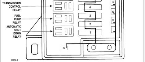

Also, if by chance it happens again, check the automatic shut down relay (ASD). This component is actuated in the event of an accident to shut down the engine. I attached a pic for you. It is in the power distribution box under the hood.
You are welcome to come back as many times as you want. However, I realize that means you are having problems, so rather than saying I hope to see you again soon, I will end with a simple, take care.
