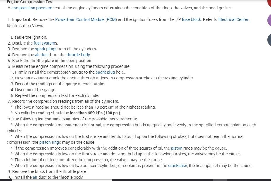

Did they do a leak down test to confirm the head gasket?
It could also be a clogged heater core as well. Did they clean the heater core?

Okay, 1 hour is not enough time to do a leak down test at all.
When the head gasket leaks, the usual indication is the gauge will go up and down constantly.
I would get a second opinion.

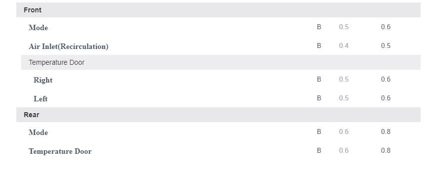

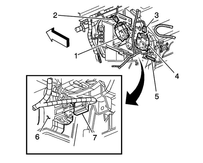

Got 2nd opinion it is the blend door was told that the dash needs to be removed (2006 Pontiac Montana SV6) big job was directed to a rapid rad.
The van does not overheat, no smoke , as how much would cost to get an estimate?
Thank you !
Wednesday, March 4th, 2020 AT 10:18 AM
ROBERT KATZ2
  • 11 POSTS
Greetings,
Have read the related heater problems can't see if the dash needs to be removed?
Thank you!
Wednesday, March 4th, 2020 AT 11:04 AM
Good afternoon,

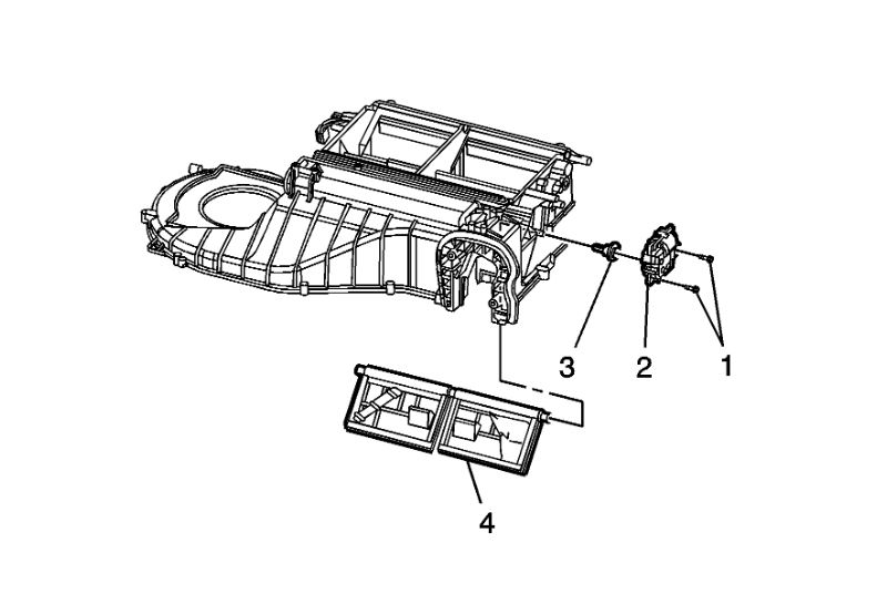

If you have a single zone which means you do not have left and right control, the dash does not have to be removed.
The estimate is not high at all. It pays about 1 hour plus the part.
1. Remove the driver side knee bolster.
2. Locate the air temperature actuator (6).
3. Disconnect the air temperature actuator electrical connector (7).
ImageOpen In New TabZoom/Print
4. Remove the air temperature actuator bolts/screws (1).
5. Remove the air temperature actuator (2).
6. Remove the air temperature actuator lever (3), if necessary.
+1

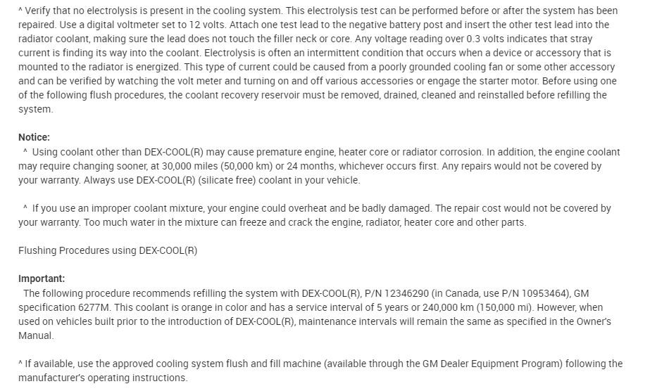

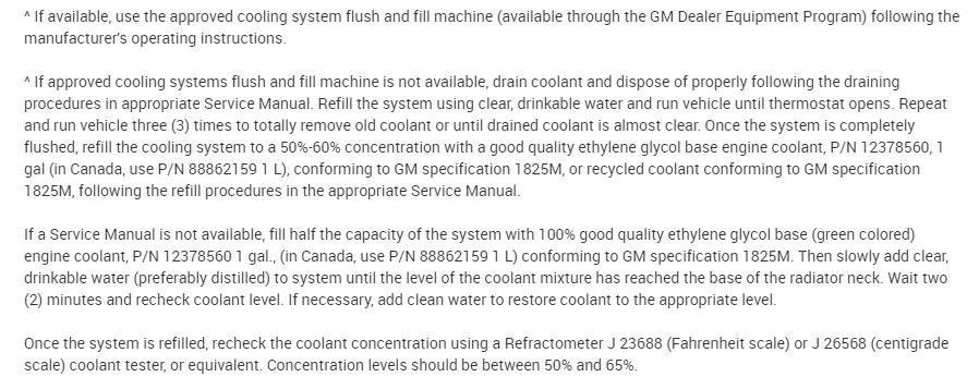

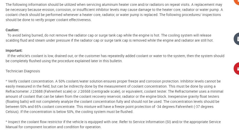

Greetings Previously mentioned that first diagnosis was head gasket, The second time the blend door. Have postponed the blend door job. Today the van overheated stopped the van right away. Coolant in the reservoir suddenly got filled up small air bubble the size of a dime was coming from the hose one after the other into the reservoir. If the head gasket is really the problem wonder for a month had no overheating.
Thank you very much !
Wednesday, March 25th, 2020 AT 10:42 AM
You are welcome.
That does sound like the head gasket. The air bubbles are the give away.
Did you have the leak down test done?
