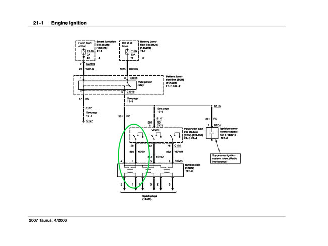

It couldn't be the PCM because number 1 and 5 share the same coil driver. The problem would have to be with either the wire or the coil.

Well you can scratch PCM, coil, circuitry off the list. The only thing particular to that cylinder is the plug and wire. If there were an issue with anything else it would have affected cylinder 1. I don't know if you've tried it already, but you can swap plugs and wires from #4 or 6.

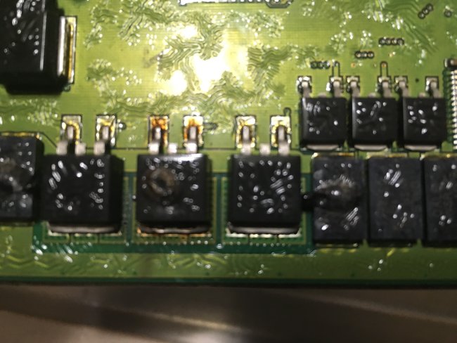

I was wrong it was cylinder 2 and 6 not getting spark not number 5. Thank you for your time. It is the PCM that is bad? I took it out and took it apart and this is what I found at least 4 burnt.

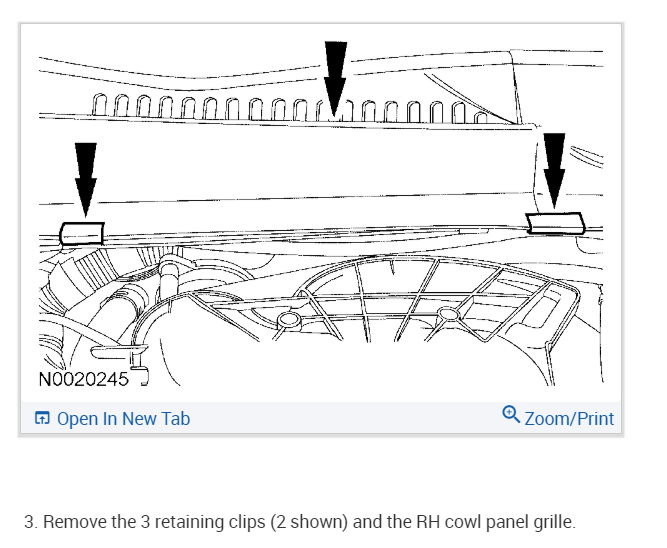

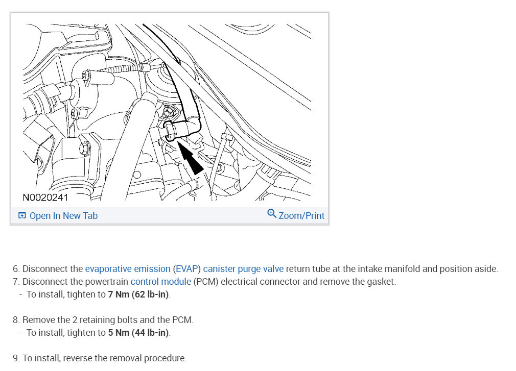

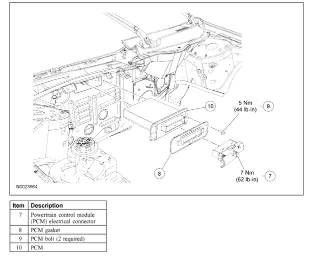

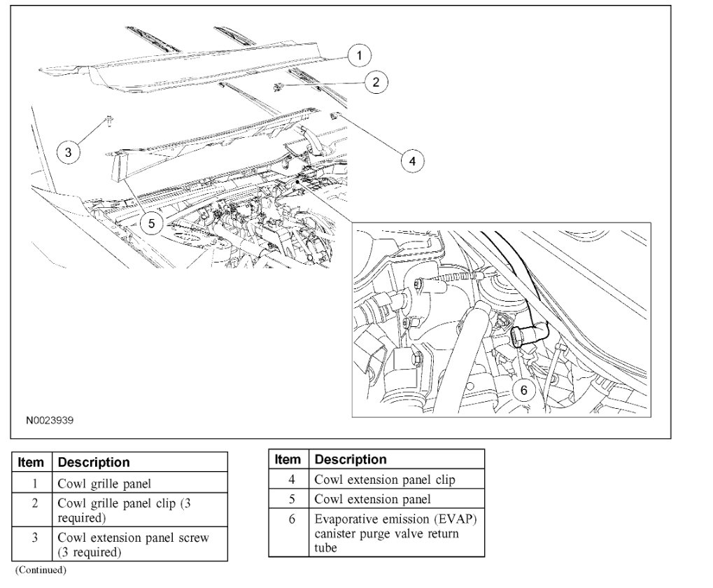

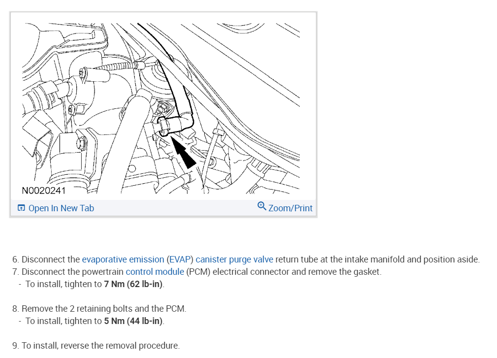

Are those blisters on top of the IC's? If so I would replace the PCM and use OEM spark plugs, wires and coil. Here is the instructions for replacing the PCM. Check out the diagrams (below). Please let us know what happens.

Absolutely! PCM, o.E.M. Coil, wires, plugs as Ken stated!

The new PCM works great. Thanks again.

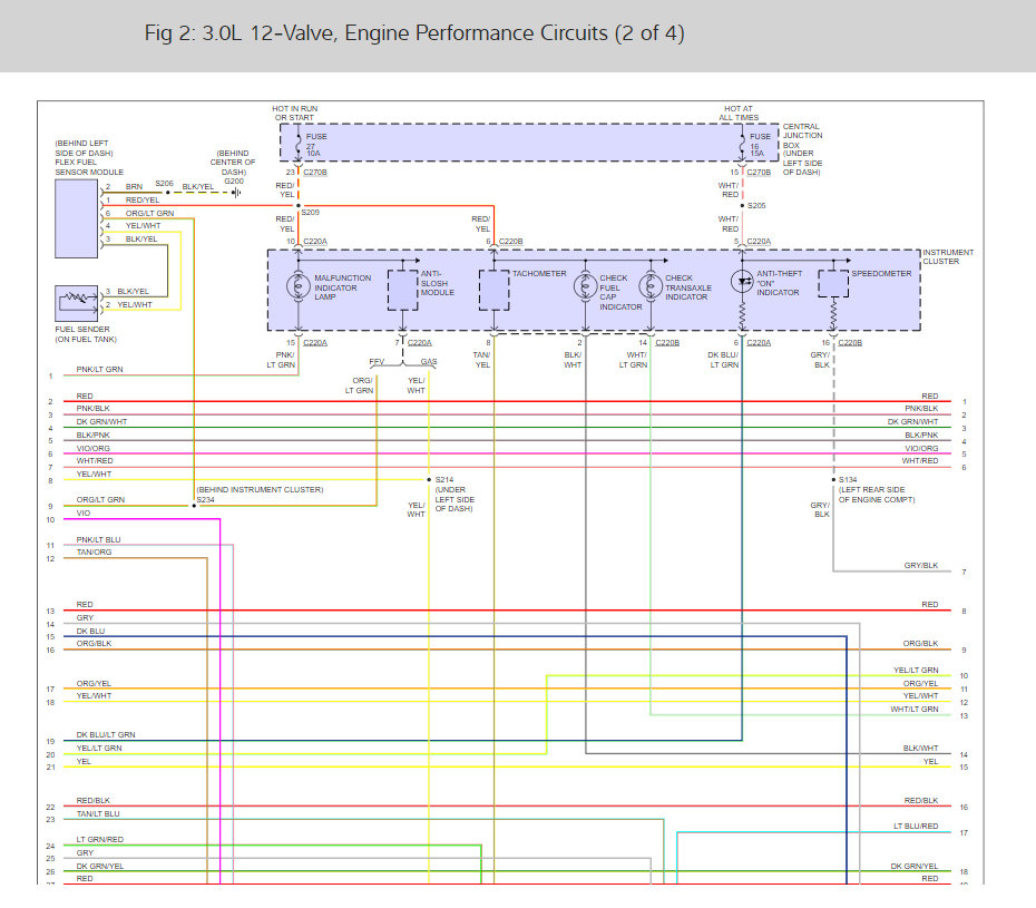

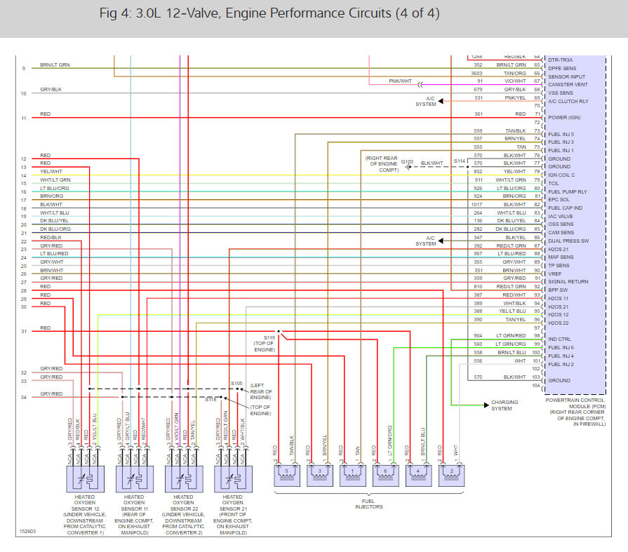

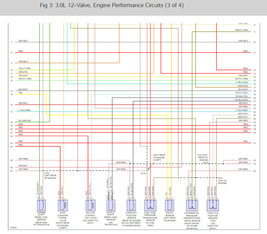

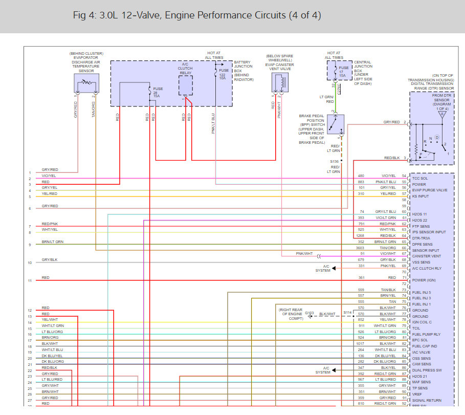

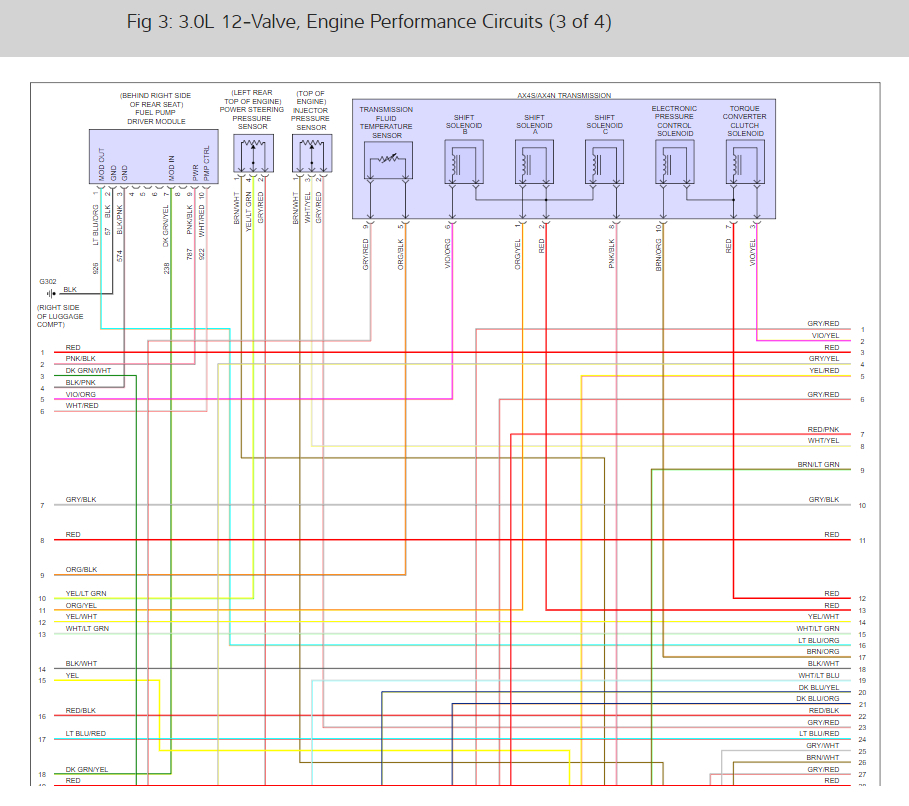

Misfire codes p0351 p0352 p0354
test inyector ok
test comp ok
test signl for inyect ok
test signal for coil. Ok in 3 5 and 6
no signal on 1 2 and 4

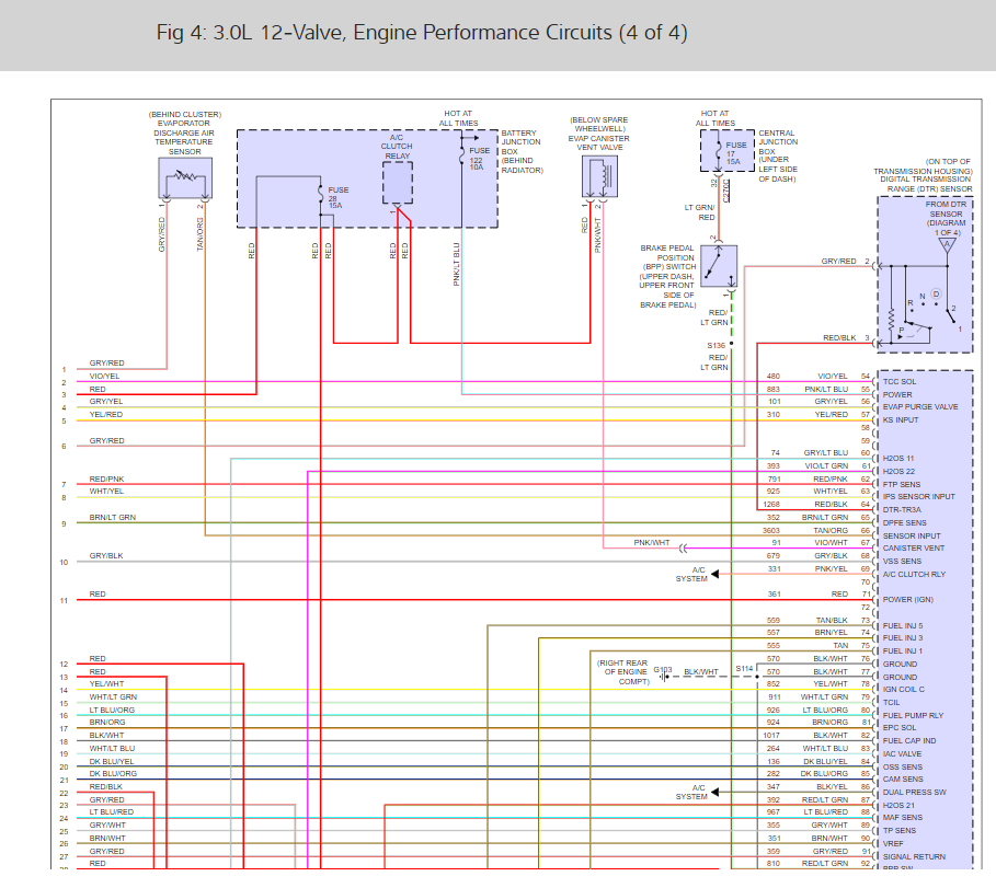

1) Cab you send me the diagram for pin on pcm to test the lines
2) how test the coils with multimeter (I think this ones its ok because is weird to fault three in same time)
3) please give me another tip.
Thanks
Wednesday, December 2nd, 2020 AT 8:52 AM (Merged)

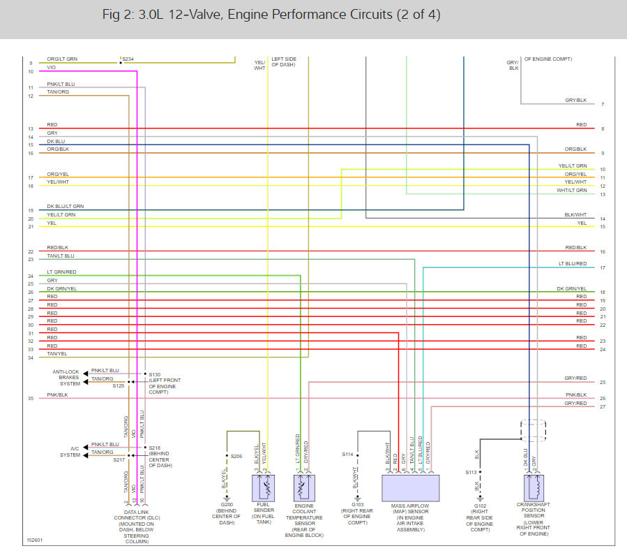

WRENCHTECH
  • 20,761 POSTS

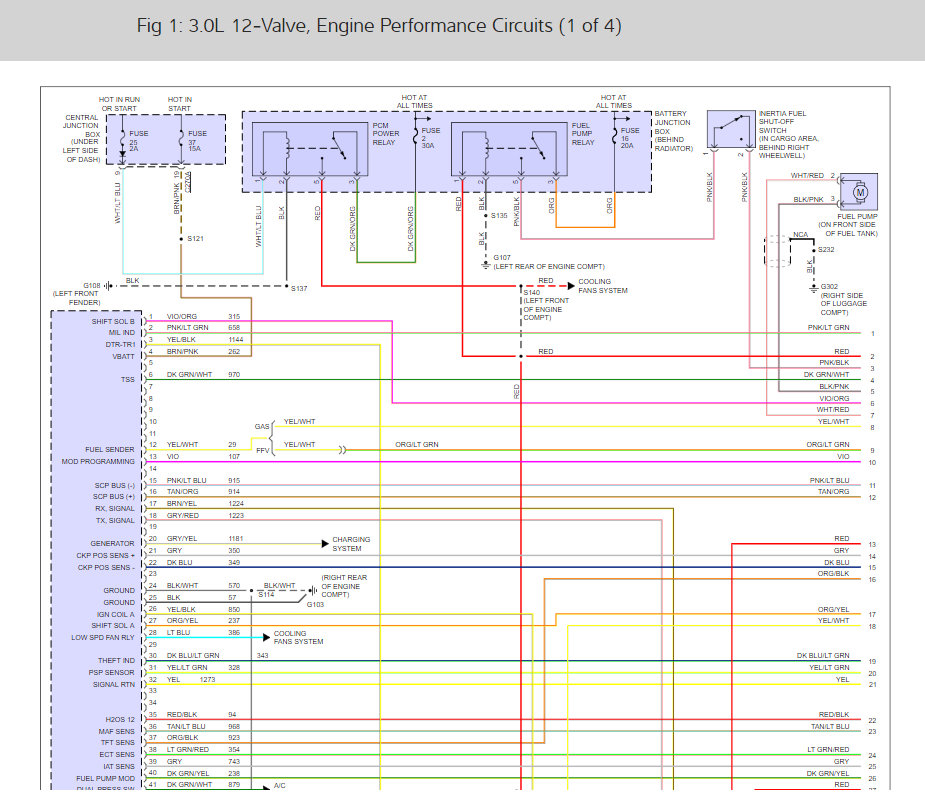

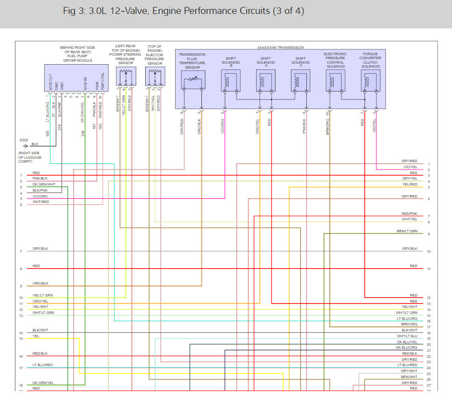

Yes, you have the DOHC 3.0
http://i1198.photobucket.com/albums/aa448/Wrenchtech/105619499.jpg.gif
https://www.2carpros.com/images/external/105619500.jpg.gif

MDELACRUZ3
The lines is ok. But still no signal on the coils 1 2 and 4 from de pcm. The camshaft synchronizer help to generate this signal or I have a pcm damage?
WRENCHTECH
  • 20,761 POSTS
I would use a lab scope to determine if there is any signal coming out of that PCM. You also have to make sure that harness isn't shorted somewhere and pulling that signal down. Even if you determine the computer is the problem, something caused it to happen. Computers rarely fail on their own. Something kills them.

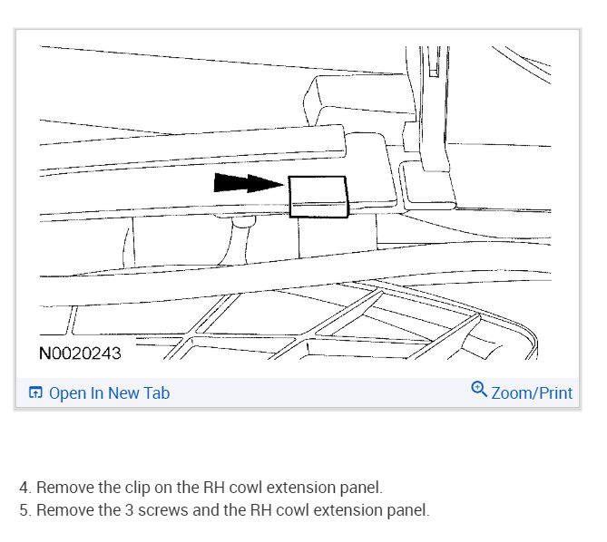

KEN L
  • MASTER CERTIFIED MECHANIC
  • 55,291 POSTS

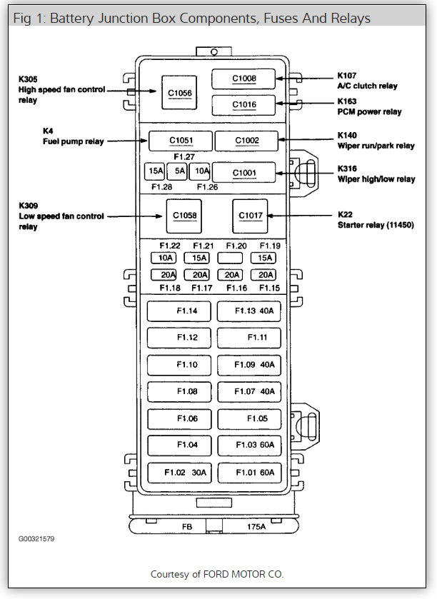

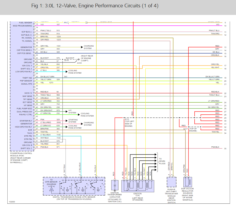

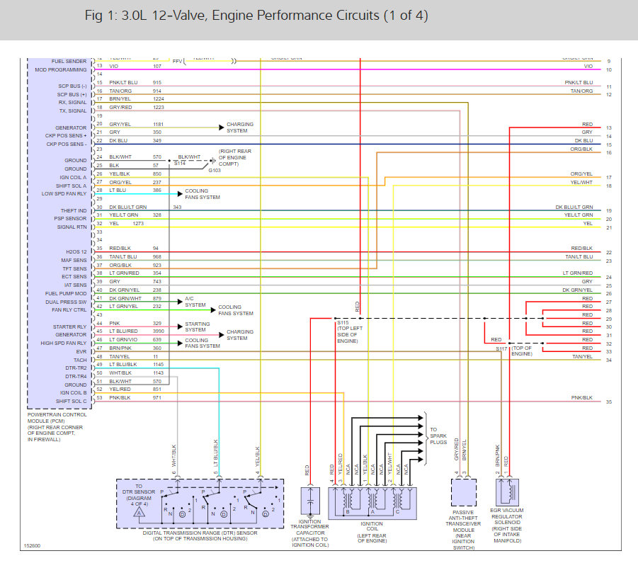

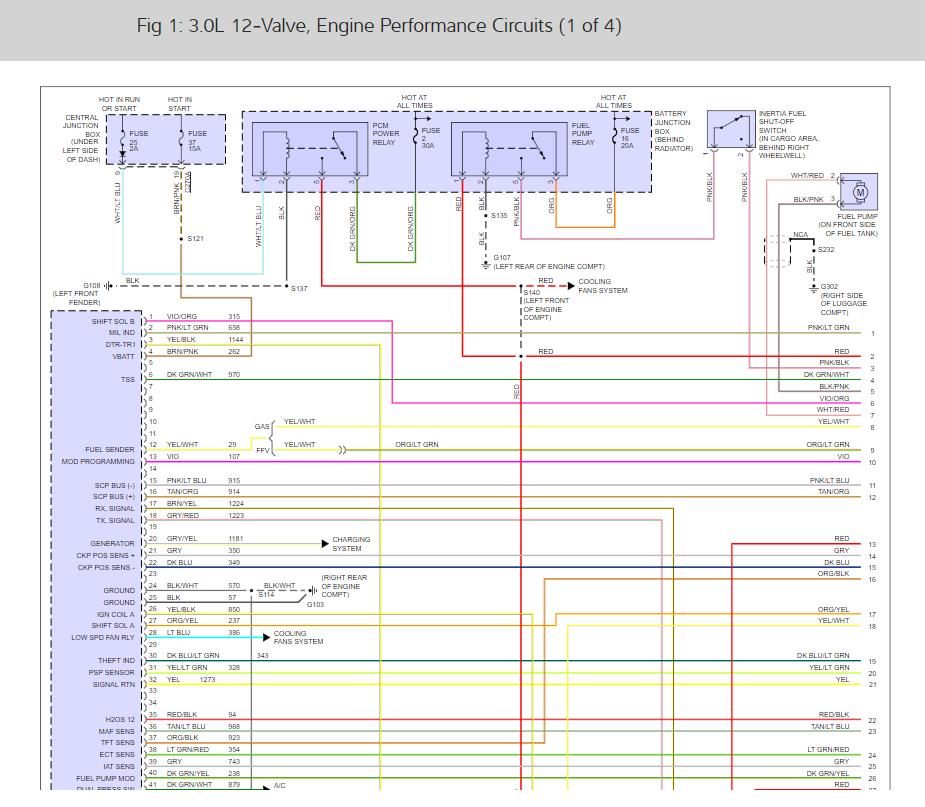

It sounds like the PCM relay is not working right. here is a guide to help you test it with the location of the relay and the engine wiring diagrams so you can do some testing:
and
MRUSDCAR
Thanks for the diagrams.
I don't see how a power relay would affect the ground circuit of the coil - but I went ahead and retested them and here is what I found:
The center ground circuit (one of the yellow wires at the coil) is grounded all the time Key on or off and the PCM relays removed. The harness is good (unhooking it from the PCM opens the circuit).
I used a test light and went from the battery + to each of the yellow wires (unplugged from the coil) and only the center one showed continuity.
When cranking, the other two wires will flash but the center one is illuminated brightly while, in my opinion the other two flashes are very dim. This leads me to believe that it is a faulty PCM.

KEN L
  • 55,291 POSTS

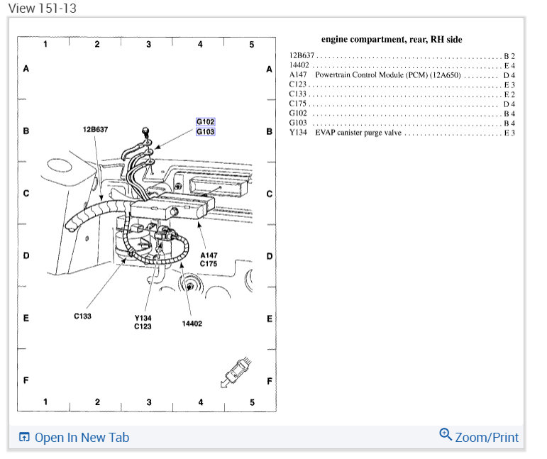

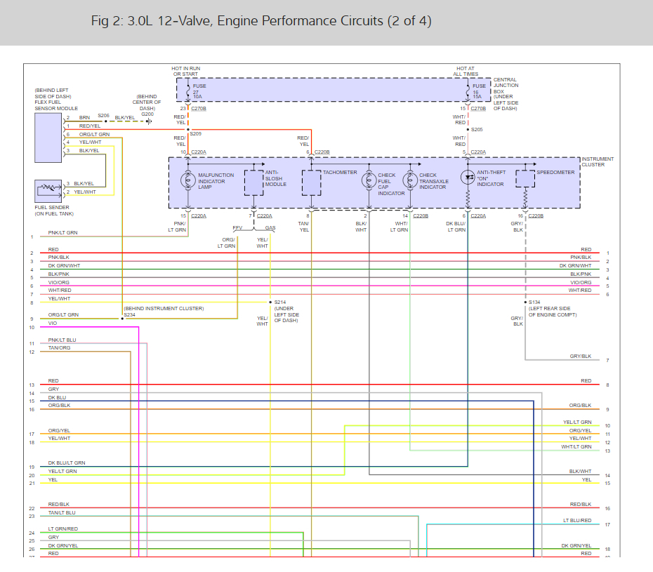

Yep that is my thoughts as well, bad PCM. I would try to find a used or rebuilt unit to see what happens. Here is the location. Check out the diagrams (below). Please let us know what you find.
