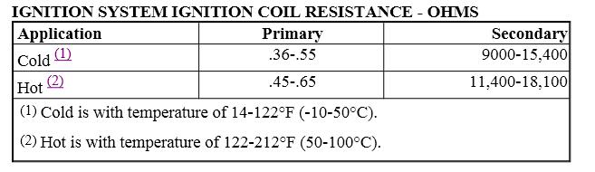

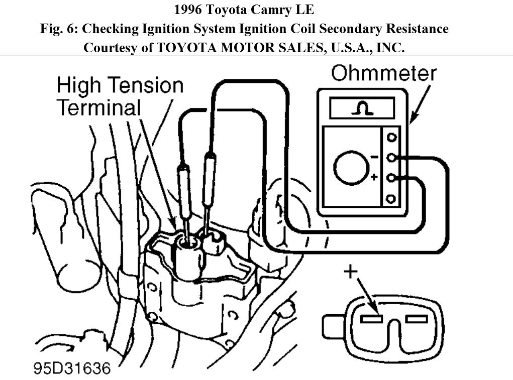

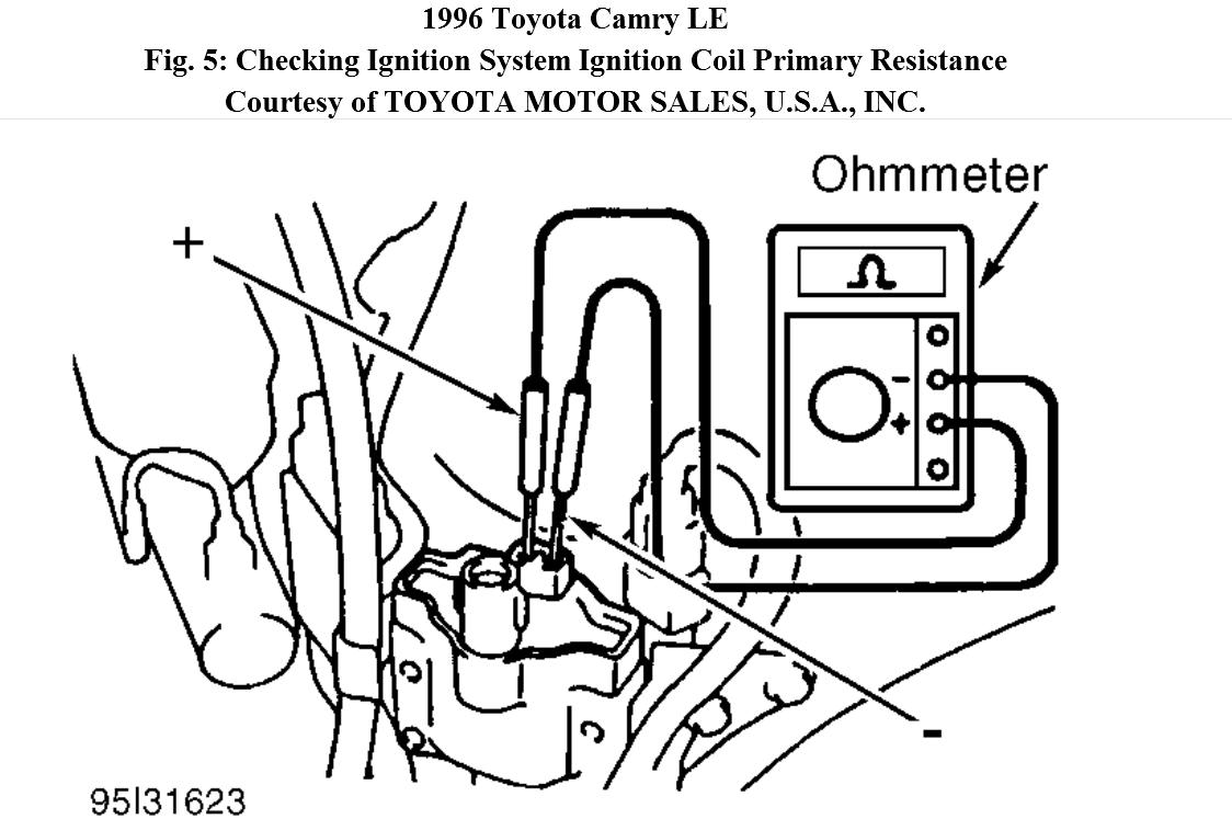

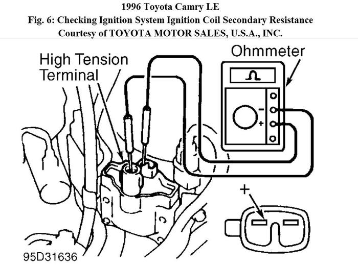

Try checking the ignition coil resistance.
IGNITION COIL RESISTANCE
1. Disconnect wiring from ignition coil so ignition coil is isolated from system. Using ohmmeter, check ignition coil primary resistance between ignition coil positive (+) and negative (-) terminals. See
Fig. 5.
2. Check ignition coil secondary resistance between ignition coil positive (+) terminal and high tension terminal (coil wire tower). See Fig. 6. Replace ignition coil if resistance is not within specification.
Feb 22, 2021 at 9:59 AM (Merged)
BPATRICK
  • 6 POSTS
Coil checks out as well. I appreciate the help so far.

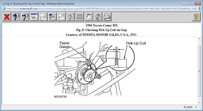

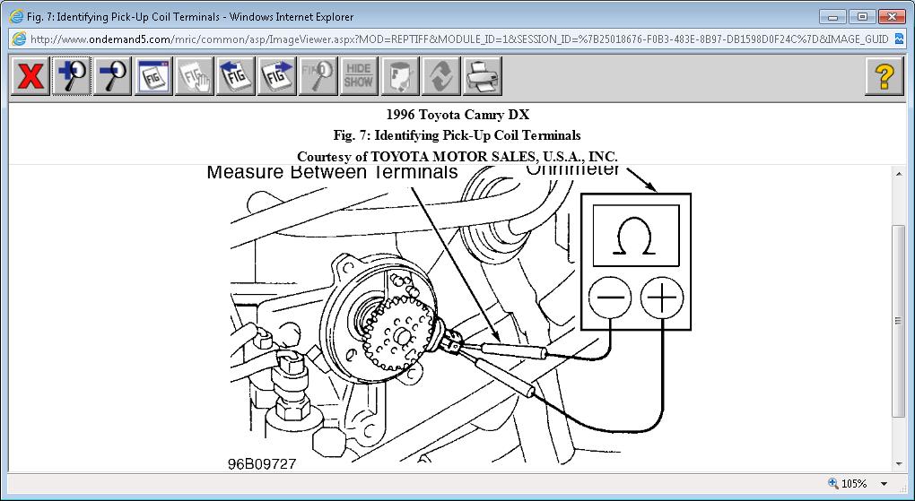

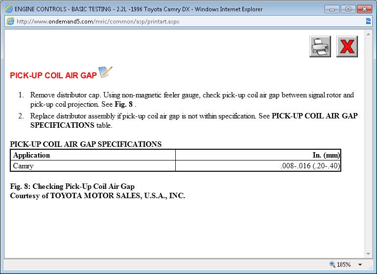

SATURNTECH9
  • CAR REPAIR CONTRIBUTOR
  • 30,869 POSTS

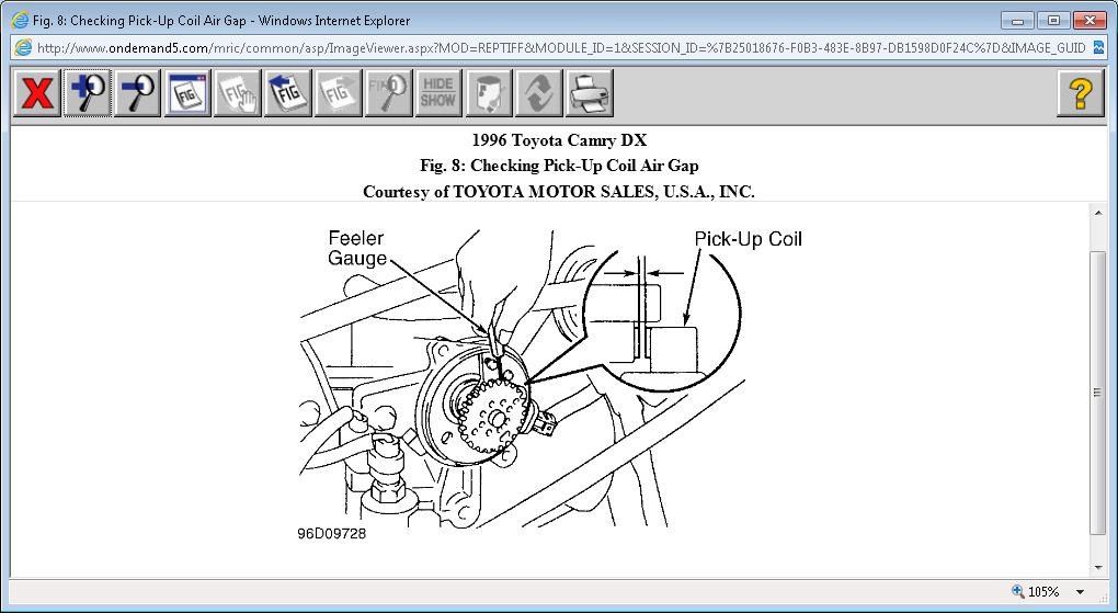

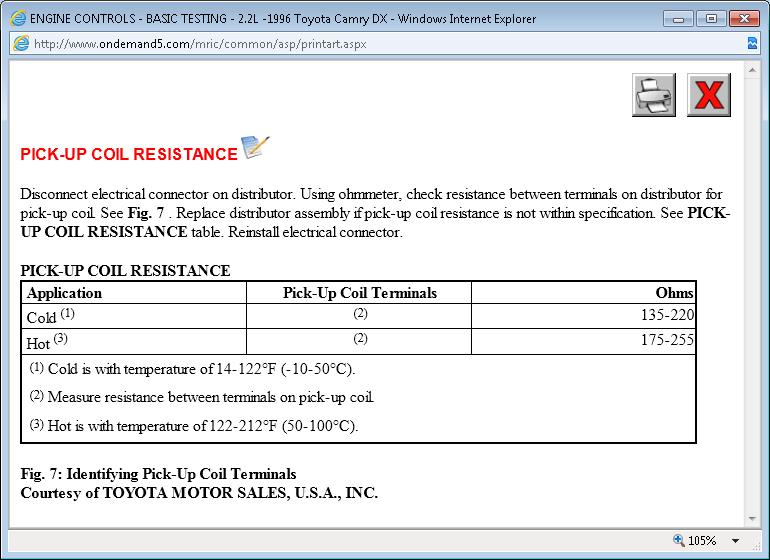

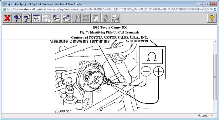

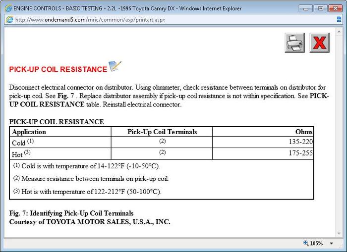

I posted how to test the pick up coil and how to check the air gap on it.

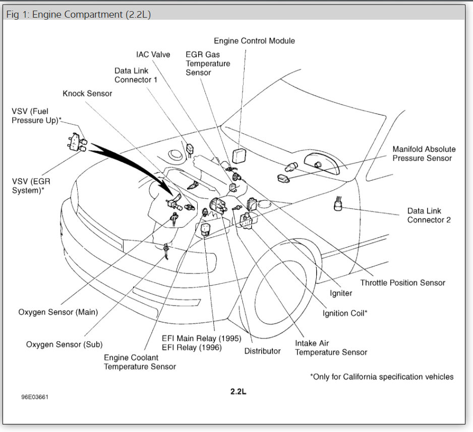

1995 Toyota Camry DX 2.2L 5spd manul I've tried looking online as well as all over my engine. I can't find the ignition coil anywhere. can you guide me as to where it is located?
https://images.2carpros.com/forum/automotive_pictures/411849_P9260678_1.jpg
Feb 22, 2021 at 10:08 AM (Merged)
  • 75,992 POSTS
The coil is inside the distributor
