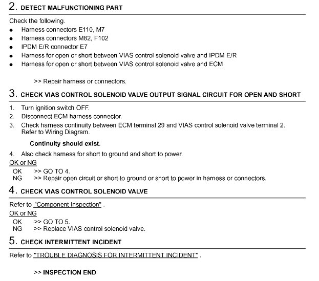

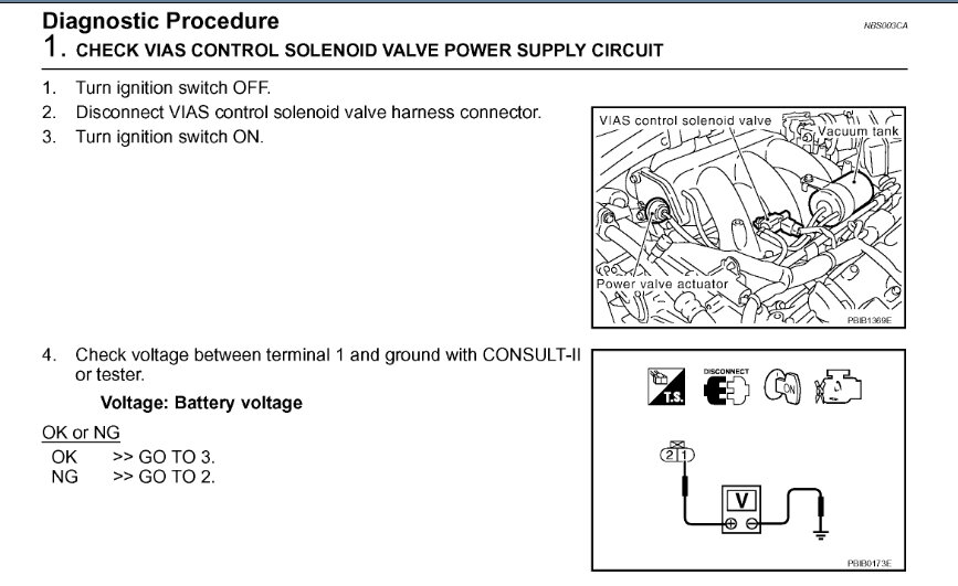

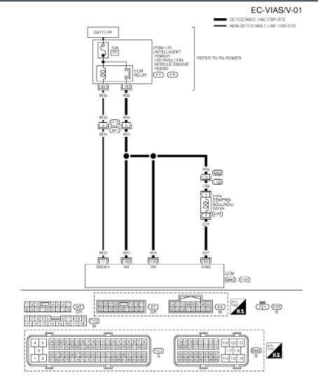

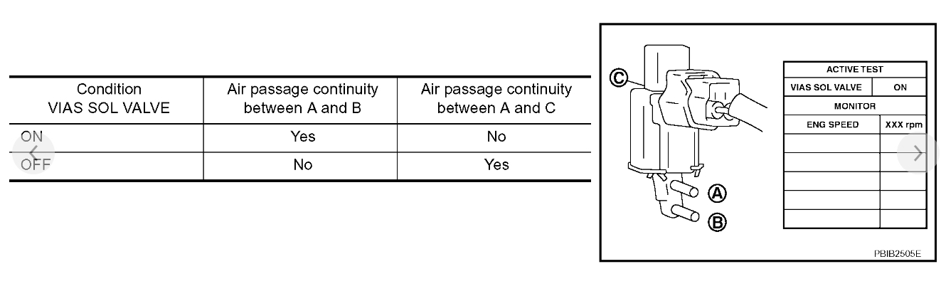

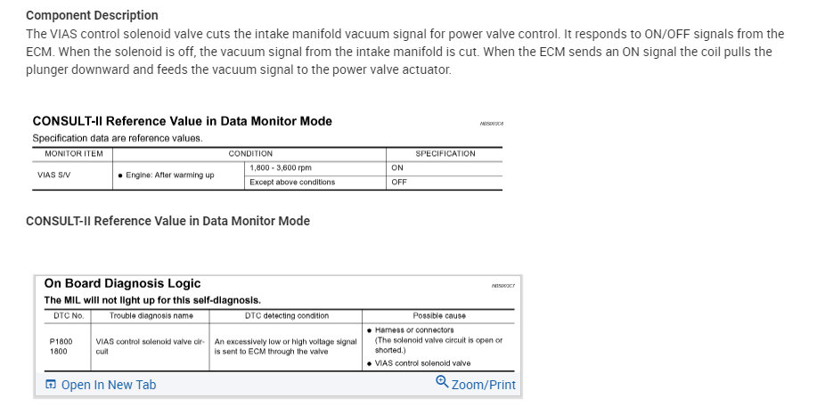

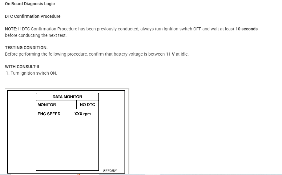

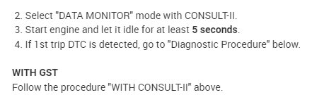

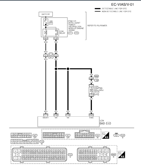

When you say it was flat, are you referring to the battery? In other words, the starter wasn't engaging. I ask because one of the possible causes of the cam sensor codes is a weak battery.

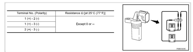

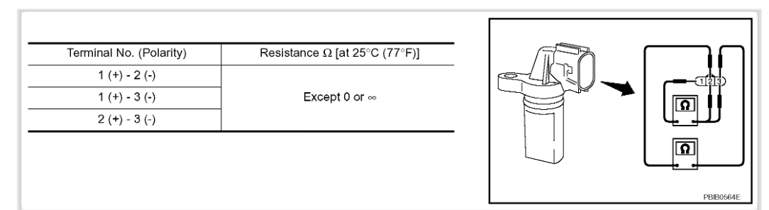

If that isn't the case, you can check the cam sensors. I check the resistance as shown in pic 1 below. However, it is odd that both would fail at the same time.

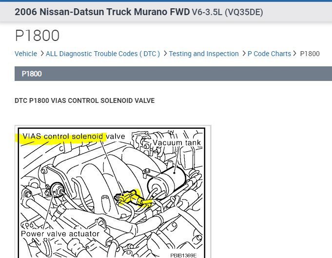

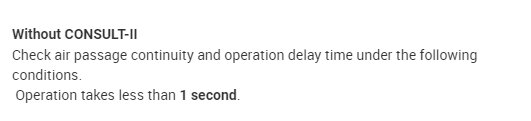

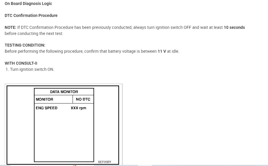

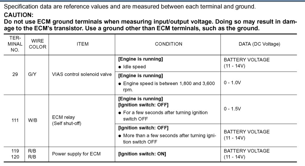

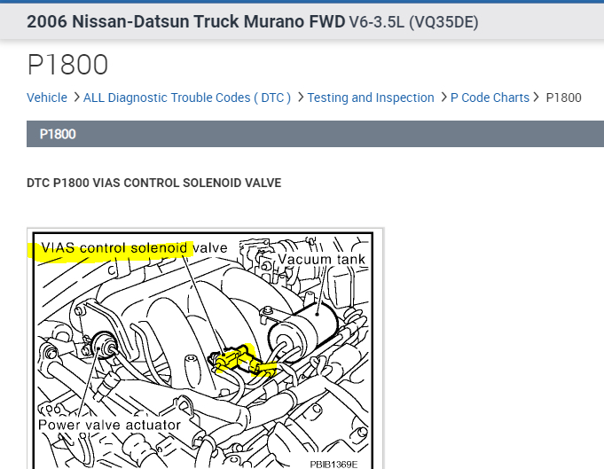

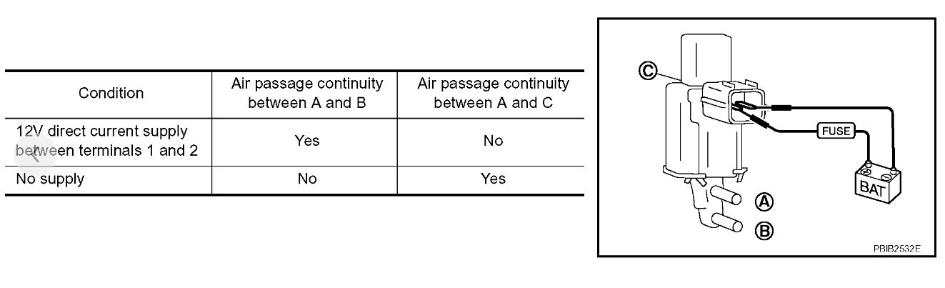

If they check good, then we need to check the vias control solenoid valve. The remaining pics are the procedures for testing.

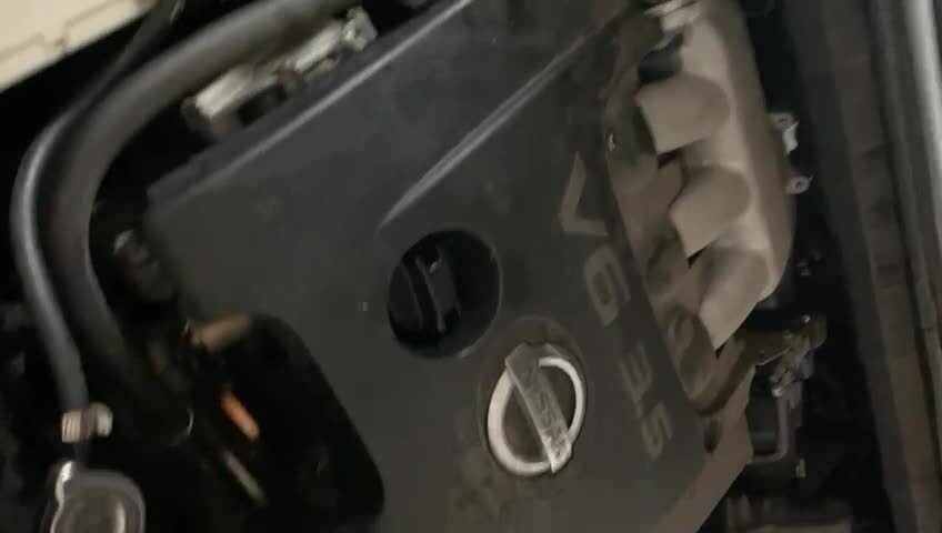

I am sorry, I am just finding out that the message that went through was not the complete one I sent. Below is the additional message that I meant to have added.
Once I had the problem, I checked the battery, and it was okay at 12.77V. The lights and radio worked. On getting the scan codes, my scan tool advised to replace to cam position sensors, so I ordered the sensors for bank 1 and bank 2. I replaced the position sensor for bank 2, the one in front as it was easier to remove and replace. After doing this, I tried to start the car, but it still would not start and stayed No crank No start. I then ran the scan tool again and all the three codes were cleared. However, the car is still not starting. I did not bother to replace the sensor for bank 1 since it's more difficult to get to and that doesn't seem to be a problem anymore after I replaced bank 2's sensor.
I am now wondering if there is a different place I need to start checking.
I was going to check if there is a voltage drop between the battery and the starter. I have checked the battery connectors, there is no corrosion and those look good. I do not know if there is a starter solenoid in an accessible place in this car or if the only one is by the starter itself.

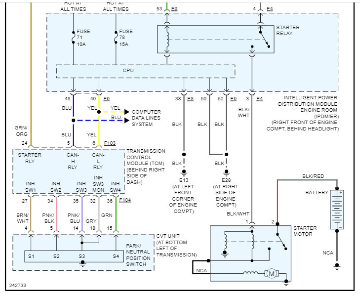

If the starter isn't working, I feel we need to get that taken care of before we move on.

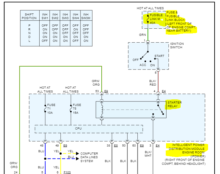

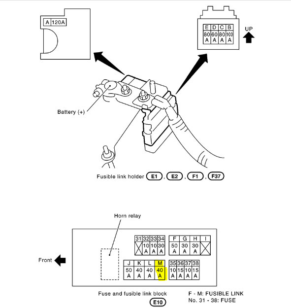

I attached the wiring schematic below for the starter motor, so you have a reference. I had to cut the pic in two to make it readable for you.

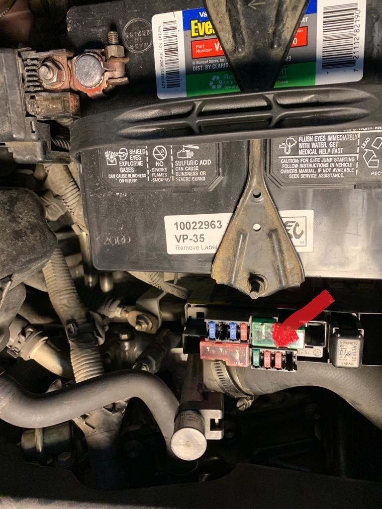

First, we need to determine if the fusible link is good. Pic 3 shows the location. Make sure power is present both to and from the link.

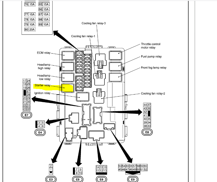

Next, if you haven't already, see if it will start in neutral. If there is no change, I need you to check the starter relay in the under-hood fuse box. See pic 4 for the location
If there is a different relay in the box having the same part number, switch them to see if it makes a difference. If there isn't, here is a link that explains how to test a relay:

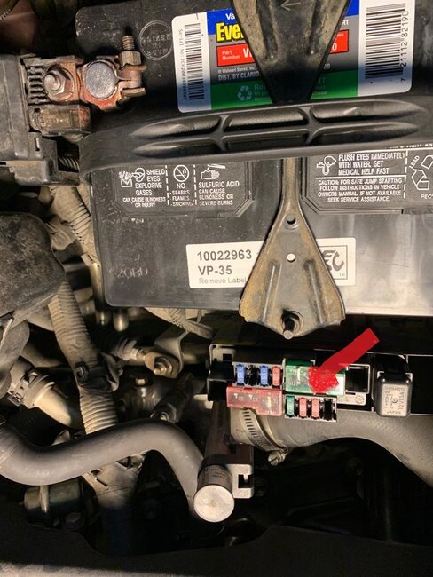

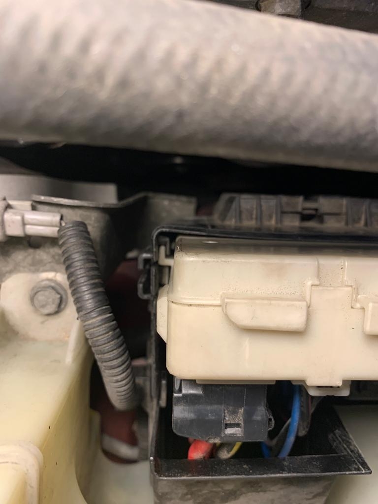

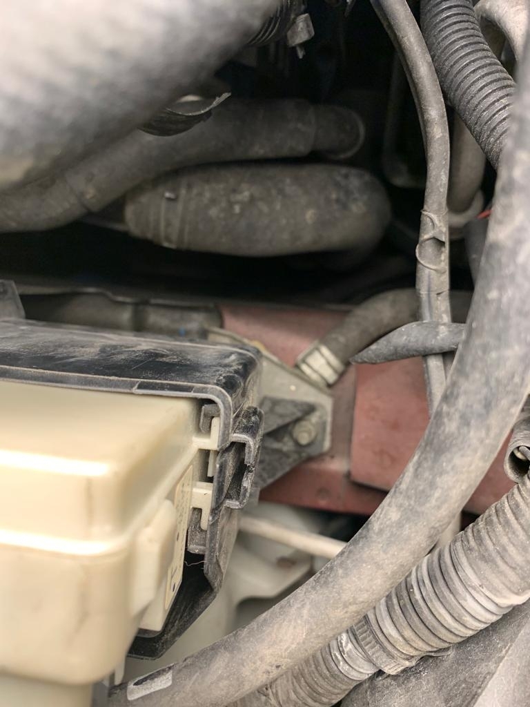

I decided to check the ignition switch in fuse box no 2 (see attached picture). The fuse was part of three enclosed in a plastic and glass box. There are no terminals on top for me to do a continuity check. I tried to take it out to check the terminals on the other side. However, it was very tight. I have used a needle nose plier to try and remove it to no avail. Do you know of any easier way to remove this fuse without breaking it?
Mar 14, 2023 at 9:38 AM
  • CAR REPAIR CONTRIBUTOR
  • 110,193 POSTS
It should pull out. Try to wiggle it back and forth while pulling upward. It may be corroded in place.

I was able to remove the fusible fuse M and check for continuity. That showed that it's fine and there is continuity.
I then proceeded to check the starter relay. I am now having a problem pulling it out to retrieve the relays. I tried to use the tab close to by pushing it out to see if that will release fuse block to pull out so I can pull out the relay, but it's not pulling out. See pictures. The fuse block wouldn't come out. It seems to be blocked by the coolant reservoir. Even after pressing the right tab for example, that side would only come up a bit, not enough. What could I be doing wrong? What should I do?

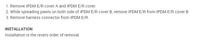

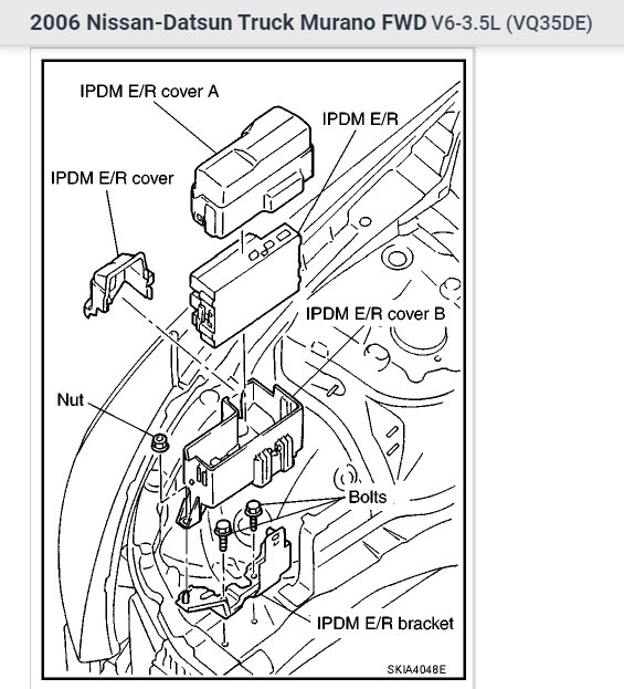

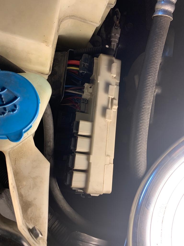

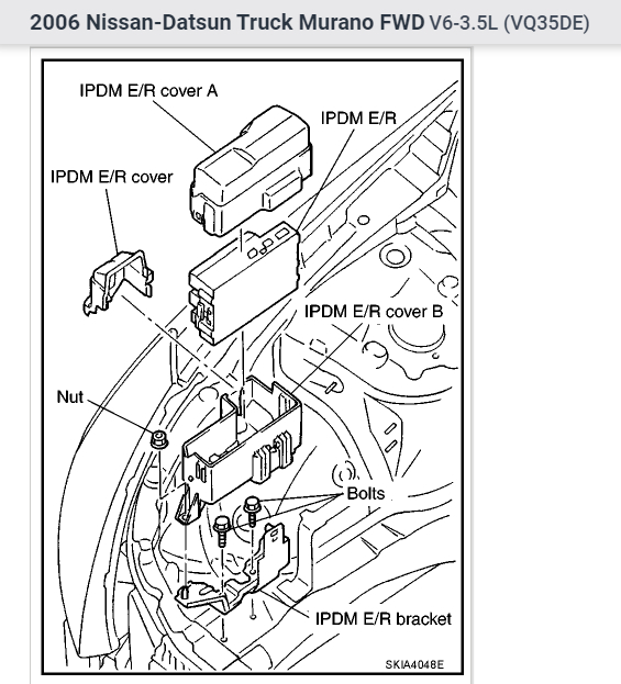

I'm not sure why it won't come out. If the reservoir is holding it in, I believe there is only one bolt that holds it in place. You may need to remove it or move it out of the way.
I attached the directions for the IPDM removal below. Take a look through them and let me know if it helps. Also, can you access the relay without removing the IPDM box?

I have now been able to test the starter relay and ignition relay in the IPDMER. They both passed the test. I heard a click when I applied power from the battery to the primary circuit and there was continuity in the secondary circuit (using a voltmeter in continuity mode) while the the primary circuit was powered. While there, I also tested the Fuel pump relay, the throttle control motor relay and the ECM relay, they all passed.

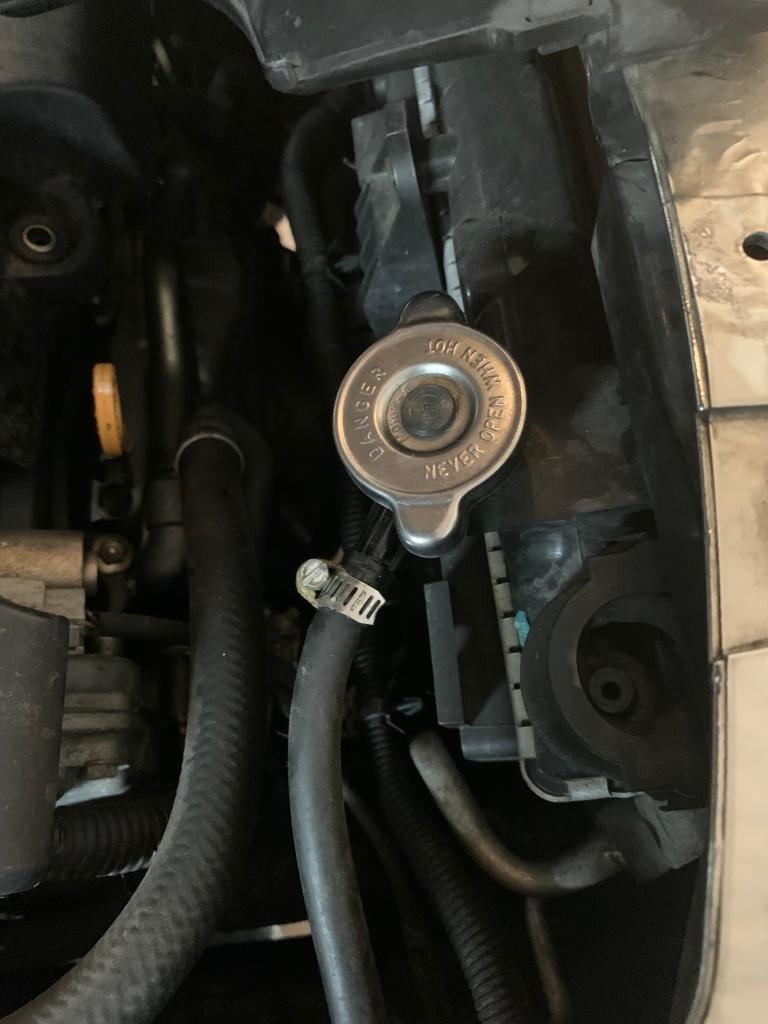

In order to pull the IPDM out, I had to remove the coolant reservoir. It was when I tried to do this that I noticed the coolant reservoir was almost empty. I then opened the radiator cap and found out that coolant was away from the neck of the radiator cap. I suspected that maybe this is what caused the car not to start. However, I decided to test the relays first before proceeding. The results of the tests have been outlined in the previous paragraph. I then proceeded to fill the radiator to just below the top with coolant and also filled the reservoir with coolant to somewhere between Min and Max.
After all this, I tried to start the car. It did not start. All I could hear was a click, immediately followed by a woosh sound like a fan or something trying to start but it quickly stopped in about a second or less.
Can you tell me what to do next?
One more thing in putting the radiator cap back, I'm not sure if I got it back to its final position. You can see it. below. I tried to tighten it more clockwise so it lines up with the entry tube, but I couldn't go farther than shown. I have a feeling there may be a way o tighten it further.

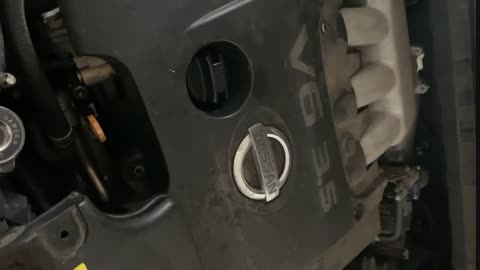

After reading your reply, I have a feeling the starter has failed. You hear a click and a whooshing sound, correct? If so, it sounds like the starter motor is spinning, but the Bendix isn't engaging the starter gear. If I could hear it, I would be able to tell. I suspect the whooshing sound is the motor slowing back down.
Let me know if you can record it and upload it for me to hear. That would be very helpful.

Thank you. Here are two recordings. In the first one my phone was inside the car. So, the whole recording is about clicks etc. The second sound was recorded with my phone outside the car. Therefore, the first 10 seconds was taking with me leaving the phone outside and the slamming the door shut. The clicks after 0:10. It then goes to about 0:32 when I get out of the car and shut the door.

Here is the sound recorded as video.

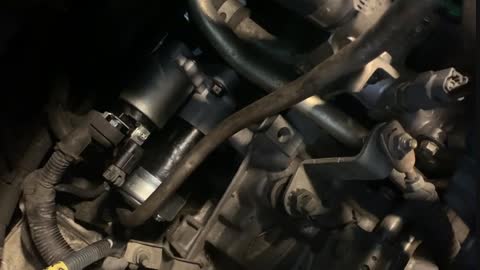

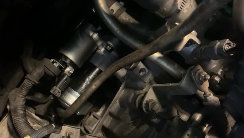

It's a bit tedious to get the starter out. I will do it soon but before getting it out, I am thinking of testing the starter in place by disconnecting the harnesses that connect to the solenoid. Then, I will use clamps from the new battery that's sitting outside the hood to connect directly to the solenoid and then use another clamp to go to the S terminal and see if I get any action from the starter. I just want to make sure that this will isolate the starter and not affect any other electrical parts in the car. Or do I have to take the starter out before testing it? I do not have access to the starter if the battery is in the right place. Thank you.
Apr 1, 2023 at 5:43 PM
  • 110,193 POSTS
If you are able to access the starter, have a helper turn the key to the start position while you check for power at the black wire with a white tracer. That wire should have 12v with the key in the start position. This way you won't have to remove the starter.
Also, the heavier gauge wire should have B+ at all times, so confirm that as well.

I finally succeeded in removing the starter after trying many tools. I then bench tested the old starter.by applying 12V to the main terminal. I then use an alligator clip to apply 12V to the signal terminal. Nothing happened. No sound, no clicks. So, I figured the old starter was indeed bad.
I then took the new starter and performed the same test. In this case, I heard a click and the motor started turning and stayed turning smoothly until I removed the alligator clip.
I then installed the new starter. After that, I used jumper cables to connect the battery standing outside the car to the battery posts in the car. I measured the voltage at the main post of the solenoid, and it was 12.58V. I then had a helper start the car. It made a rapid starting sound as if the battery was bad. I also measured the voltage at the signal terminal when the ignition was turned on. It was only 2V. I don't know what is reducing the voltage at the S terminal. The sound made by the new starter when I tried to start the car is enclosed. I also tested the battery with a battery tested and it tested good. Also, the battery connectors are clean. Kindly advise on how to proceed.
