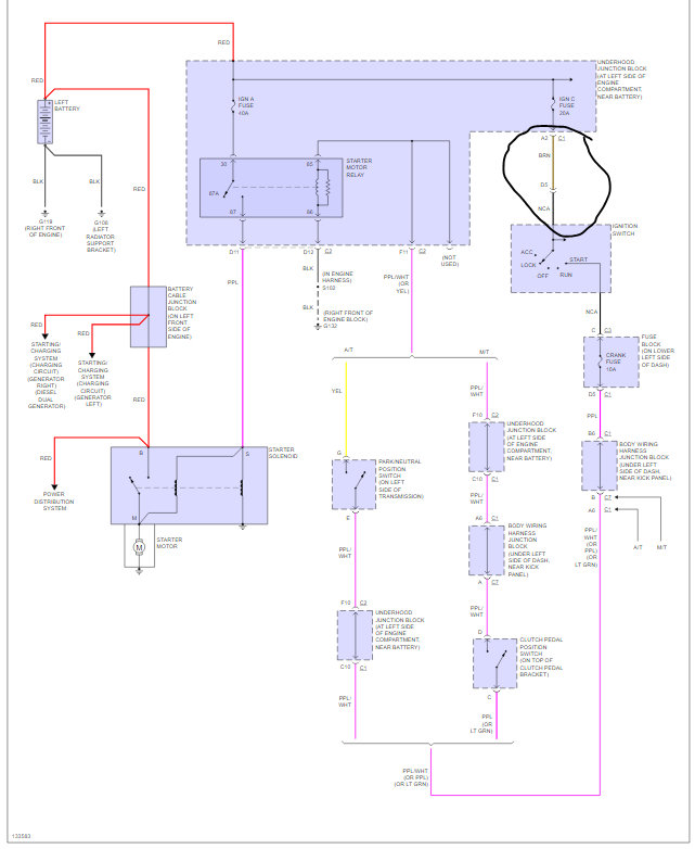

Keeps blowing the crank fuse, but every once in a while it will start if I move some wires around at the fuse box under the hood or wiggle the box.

Hi SWARNER429, my name is Alex and I will be helping you today. It sounds to me like you have got a short to Ground in your High Current Fuse Box or the ignition wires running to the ignition fuse. I have circled the area of the circuit to check. I hope this helps.
