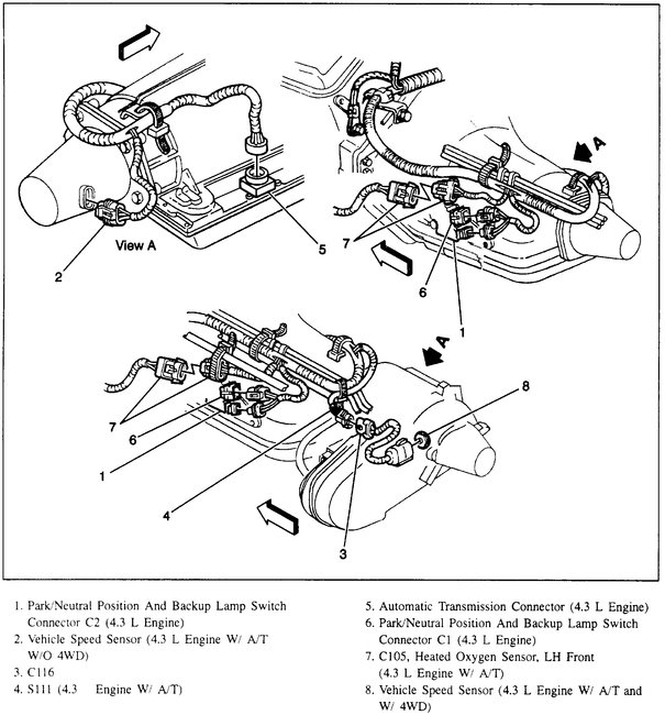

When you turn the key all lights illuminate, no crank no start. Where is the location of the neutral safety switch and how do you test it?

I attached a picture for you to see its location. As far as testing, see if there is both power to it and power out when the key is in the start position. Often times, however, if the vehicle does not start in park, it will in neutral. That would indicate a bad switch.
Also, a bad starter can do the same. Take a look through this link to determine of there is a starter issue.
